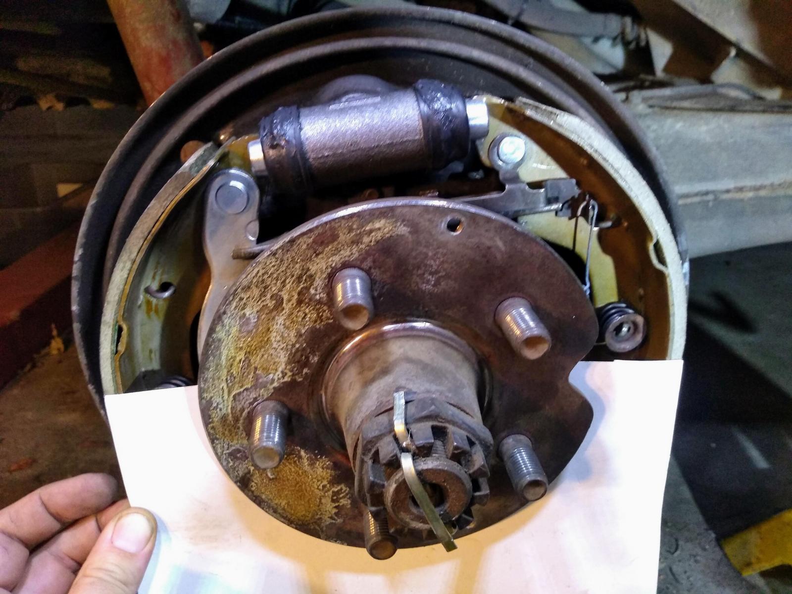

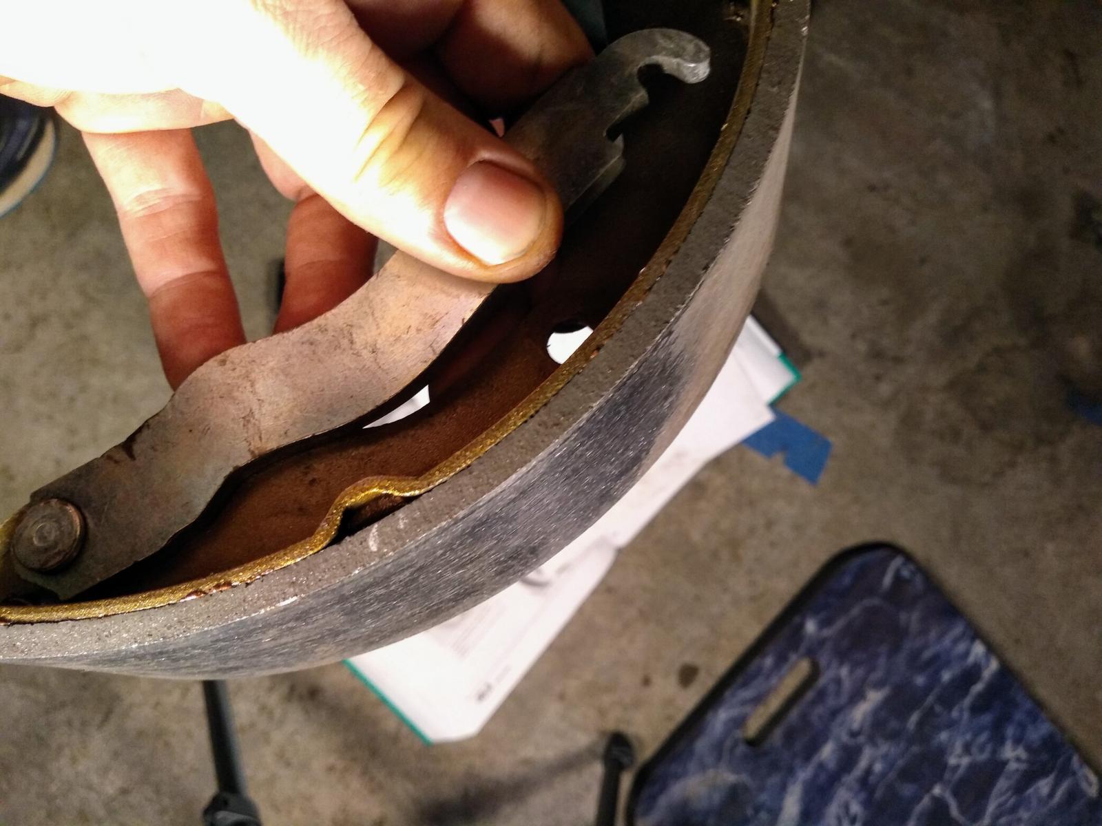

I’m in the process of replacing the rear brakes on my 85 - new drums, shoes, springs, wheel cylinders, and hoses.

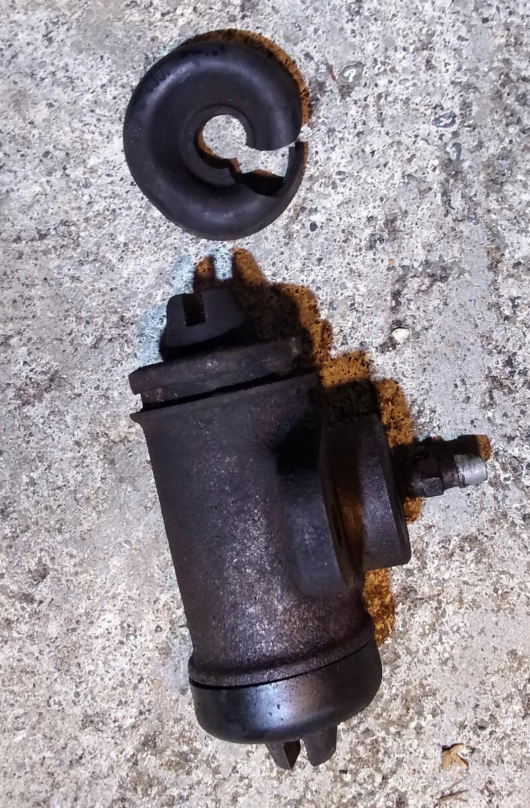

I struggled mightily to install the brakes shoes, and in the process the piston came partway out of the wheel cylinder. I was able to push it back in but it did come out far enough that brake fluid dribbled out around the rubber boot.
In the process I also pinched the rubber boot and put a couple pinholes in it. How much of a problem is this - Is this just a dust boot or will it have brake fluid in it during normal operation?
Finally, a couple drops of the brake fluid got on the new brake shoe.
How badly have I messed things up here - can I just clean the brake shoe with brake cleaner and be done, or do I need to replace the rubber boot… or rebuild the whole cylinder?
Both boots have some damage, but the pinholes are visible on the left boot.

Kudos for being slow and careful with a brake job.
Everything is fine. It’s just a dust boot , you can dab it with RTV if you have some to seal those pins but I would skip
A few drops of brake fluid, just wipe off with paper towel. I’ve done the Muir brake fluid burn off successfully on a few cars in younger, poorer days, but a small spill won’t affect function or safety.

The rubber boot keeps dust out of the cylinder.
Dust and dirt in the cylinder can cause a leak.
Fix the tear hole. Silicone or a rubber goo adhesive will work.
Get a can of Brak-Kleen and spray the shoe.
The product is designed to draw oil out of the brake material.
Get the red can, the eco friendly green can stuff is crap!
As are many other brands...... IMHO
DO NOT BREATHE THE VAPORS!
Keep off of your skin.
It is ugly stuff but does the job.

When you contaminate a brake friction lining you need to take that seriously. Using a solvent to clean the lining is the worst thing you can do. The solvent will spread the contaminant and move it into the lining. I use sandpaper to sand off the contaminated portion of the lining.

Thanks for the recommendations - I cleaned up the small amount of brake fluid on the shoe with red BraKleen and the RTV on the boot is curing now.
That’s a kind way of saying “I can’t believe I’ve been working on these brakes for two weeks.” I’ve been saying it differently in my head. (My Bentley seems to be missing the section on how to curse properly in German, but I’m figuring it out.)
Once the RTV sets up I’ll complete the initial adjustment as described in the Bentley, and then bleed the system.
With the hub still in place, “measurement A” from the Bentley is hard to measure. I’m using a piece of card stock with a notch to clear the hub. I folded it to match the inside diameter of the drum, and am hoping I can get the initial measurements close enough this way.
The previous brake shoes look like they still had a lot of life, but the one of the drums is so worn that I can feel longitudinal grooves with my finger and one of the cylinder boots was completely torn.
It’s been a long process but I’m learning a ton. There’s no stopping me now!

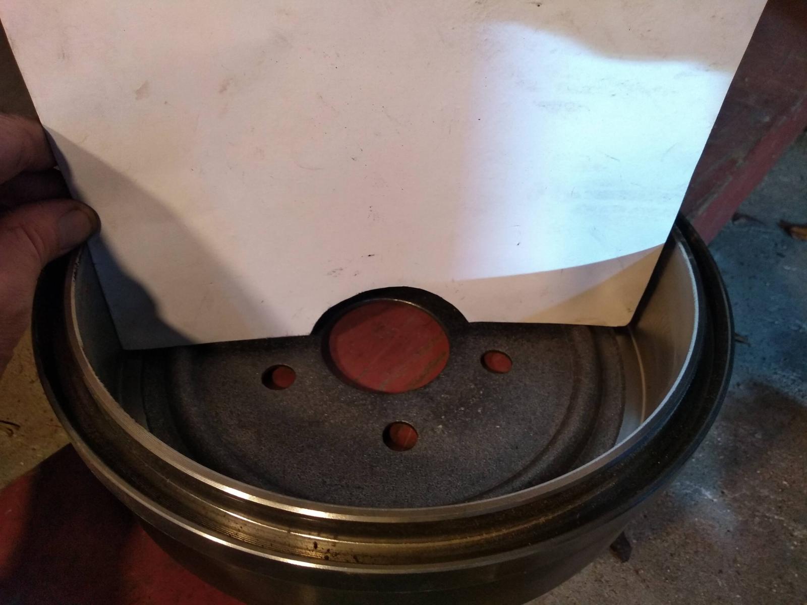

Thanks again for all the help in this thread! I wrapped up work on the brakes a couple weeks ago (my mechanic is very slow but at least the rates are cheap!) and moved on to other projects like changing the transmission oil.
However, I’m noticing a pulsing when I step on the brake. I’ve got the van back on jack stands tonight, and one of the drums is noticeably dragging once per rotation. For any bike mechanics in the crowd, it feels the same as a bike wheel that’s out of true.
I assume that the brand new brake drum must be out of round or warped. Is this a job for a machine shop, or should I be contacting the parts vendor? If this is a machine shop job, what should I be asking for?
Is it likely that I somehow damaged the brake drum? I didn’t drop it or subject it to heat, so is there anything else I might have done to cause this? Or did I get a bad part?

I’ve only used 10% sudsy ammonia to clean brake parts in 40 years. Super glue for the boots. Make sure to put a dab of anti-seize on the rubbing surfaces.
out of curiosity, which side?
well, could be both. if one side is dragging and you overheated it, it could have warped or it could just be a bad part
reason i ask what side is dragging is i was having a problem which i now think is solved and the brakes are great
in terms of rear disc brakes... especially "kits" i needed a part for a van that a vendor sold as a "kit" and they WOULD NOT sell any replacement parts to the "kit" as a service item so you had to buy the whole kit.
in my case it was a cable and after much research i figured out what they used and bought a new one for 15 bux instead of almost 1k for a new "kit"
The driver’s side was dragging/rubbing. When I had issues earlier in the thread with the damaged rubber boot it was on the passenger’s side.
To add some more context: I’ve only driven about 20 miles of in-town driving since working on the brakes. While driving I did check the brake drum temperature frequently - it was slightly warm to the touch but not blistering hot.
I was concerned I might not have gotten the adjusters right, so I was in the process of taking the drums off last night to verify my work. My work matches the photos from https://www.thesamba.com/vw/forum/viewtopic.php?p=8367832#8367832 so at least I think I got all the pieces in the right places.
In the process I tightened down the adjusters by 5 clicks, and that’s when I noticed that the drum was dragging once per rotation instead of having an even amount of force the whole ‘way round.
One last detail - when I swapped drums from side to side as a test, the same drum drags in the same way on the passenger side.
So what are my next steps here? Is this a job for a machine shop? What should I ask them for?
