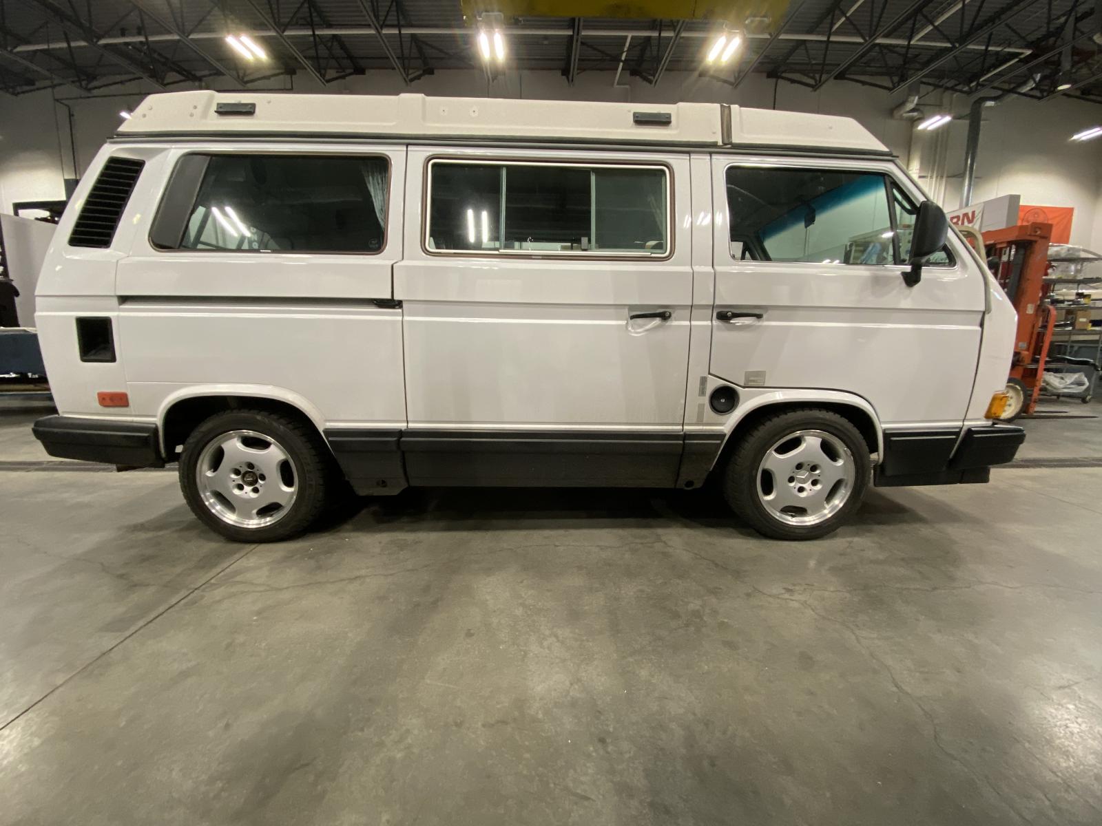

Hello, I am new to the Vanagon Forums, but not new to TheSamba. I have a very long lasting (and still in the process ) build in the Split Forums with our '67 11 window build.
My Wife (Lindsay) and I recently purchased a 1988 2WD Vanagon Westfalia. Before I tell you anything about the Westy, I need to sing the praises of my amazing Wife yet again.
Back before we started the build of our '67, She said "we either have to fix it (had been sitting in field for 16 years) or sell it, and I don't think either of us could sell it, so you'd better fix it." Now that might be paraphrasing a bit, but that was the sentiment anyways. Now cut to last October, where our daily driver, a 2010 Ford Flex Limited Ecoboost, has now coughed up the third turbo, and I am looking for a replacement vehicle. My amazing wife looks at me ( the clouds part, a heavenly beam of light shines down on her, the earth heaves her up high above me, with wind blowing in her hair) says, "i'd really like it if we just got a Westy." Well, at least that's how I remember it.
So, after looking everywhere for a Westy (which have gone up in price by at least $5k, due to COVID), I took one last look on our local classified and found ours. It is really quite minty, compared to what else was out there. It's been lowered, has a body kit (air dam, side skirt panels) and was restored in 2014. Interior is perfect, one pin hole in the tent canvas and the fuel injection had been removed and is running on a set of Weber IDF40s.
To list the plans for this Westy, I would list making it capable of a South America trip. That's the bucket list plan anyways. But we will start small and work with what we've got.
The first things ordered have been: Mercedes 16" wheels and longer studs, Go Westy lift springs, Bilstien XHD shocks, throttle cable, roof vent mechanism, 3" memory foam and custom cover, and a set of 6 LED utility lights (for lighting up a perspective camping spot). Also, a set of either BFG TAs, or General Grabber ATX tires. Still deciding.?
Now future plans for the Westy include: a massive custom (by me) bat wing 180 degree awning, Renogy solar power system, swing away rear carrier set up, side ladder, aluminum left rear window recovery gear rig/inside storage set up, roof racks for SUP and surfboards and of course a Chinese diesel heater to keep us toasty warm in the shoulder seasons.
Still working on a name for her, but here she is.
I will try to post as things get done, would love to hear from anyone with more Westy experience and what I really should be doing .
Peace, Gordo.

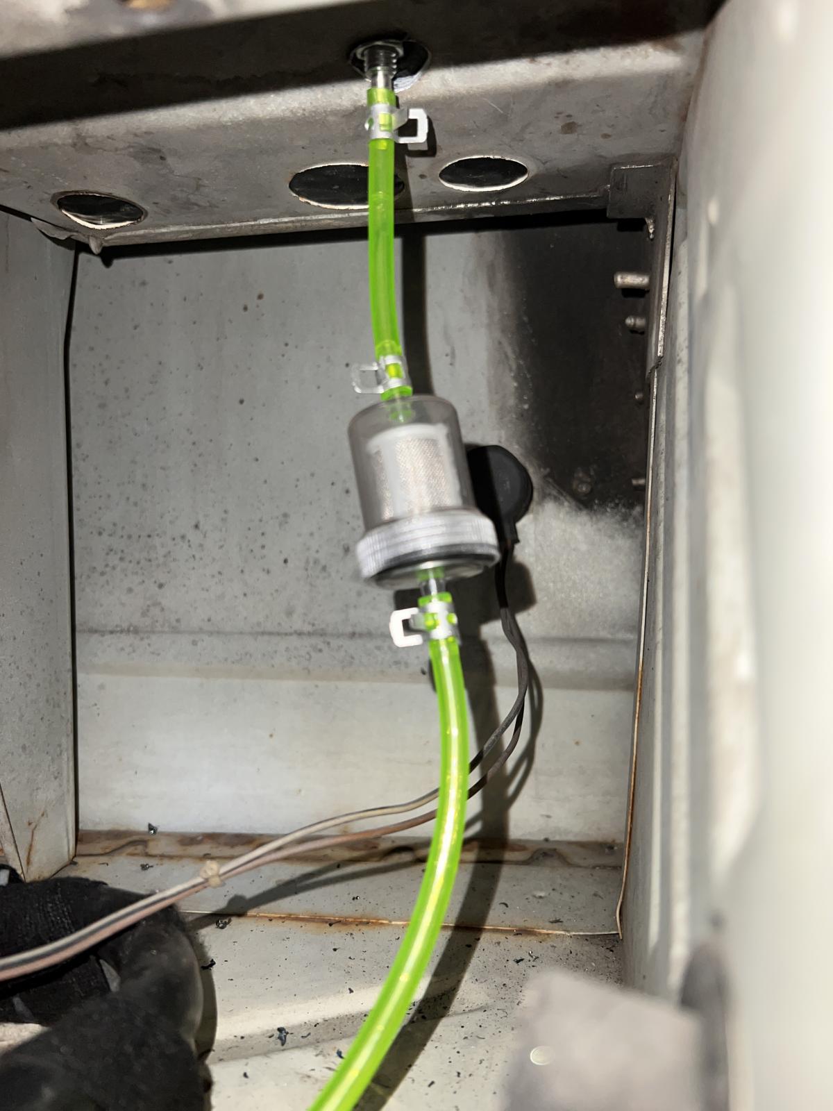

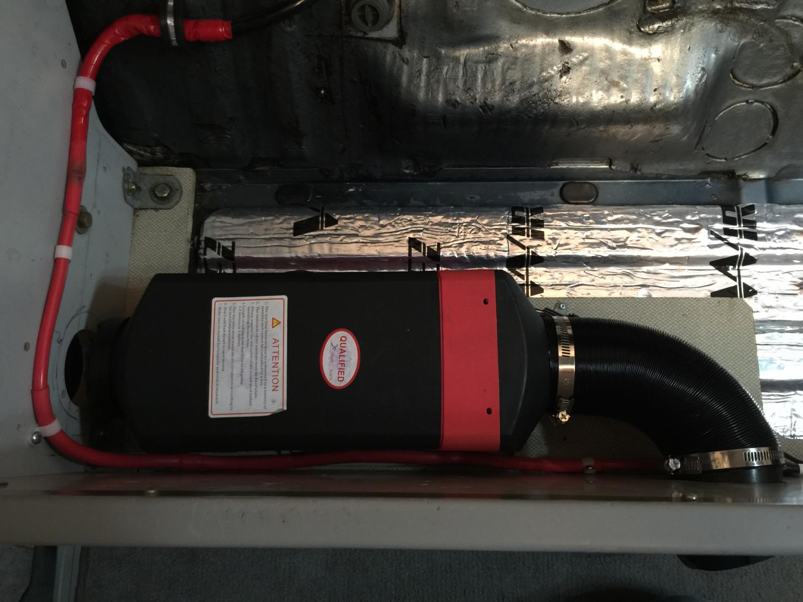

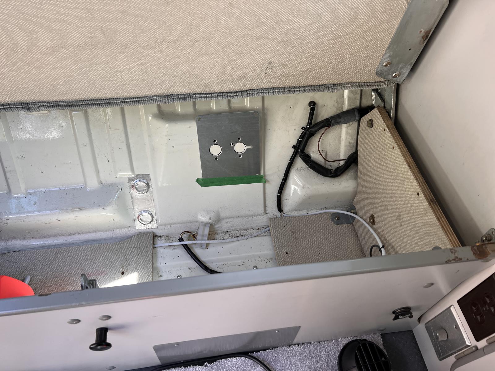

So the Westy has been running well. Had to replace the water pump. It was loose and noisy, but I wasn't loosing coolant yet...odd.
The plans to outfit this to suit our camping needs have been ramped up a bit with the good weather we have been experiencing in the Okanagan. This has lead to a bit of a shopping spree. The recent purchases are: BFG K02s to go with the Go Westy lift springs and Bilstien shocks, 2 Renogy 100W flexible solar panels and a 30A MPPT DC/DC charger, a Chinese Diesel Heater, and to top it all off a SYNCNO decal to go with my 2WD decals.
I spent a fare bit of time trying to find the best location for the diesel heater and its fuel tank. Looking specifically for an area where I would not lose much storage space and , especially for the tank location, an area where I do not have to be pouring fuel inside the van. So I thought about the rear storage cabinet. The A/C compressor had already been removed due to the dual carbs, and not being r134a compliant I was most likely not going to reinstall it. So I removed the evaporator, fans, harness and hoses. By doing this I gained about 4" of space in the rear cabinet, as well as an arms depth of space in the upper rear. The space in th rear cabinet left me room for the diesel tank, plus it could be filled from the rear. I could also inspect the fuel level without having to unpack.
The piece of trim was even the right length to be put back on, finishing the edge next to the tank. No changes to the shelving inside the cabinet either.
Now to start on the heater install.

Regarding your request for a few Vanagon Westfalia pointers, I thought I would share a couple here.
Of the various mods we have done to our '86 Syncro Westy, my wife and I really appreciated having the TF-65 Truckfridge reefer I installed:
In the pic below, you can see that installing the TF-65 allowed me to add a drawer under the reefer:
Assuming you will use an exterior spare tire holder, the old spare tire location becomes available for yet more storage. Here's a thread in which the topic was amply discussed, with lots of pics:
I like my SVX engine swap too, but I see you are sticking with the WBX, which in the hands of a good mechanic, can be made into a nice little powerplant.
The WBX really comes alive with a bit more cam and a lot more compression, which you can get away with if using an aftermarket EFI system with a knock sensor. Have a look at some of the postings by jberger like this one:
https://www.thesamba.com/vw/forum/viewtopic.php?t=563283&highlight=berger
I like your custom CDH diesel tank installation. I chickened out and put my CDH tank in the engine compartment, afraid of a diesel spill in the Van. I put a lot of thought into the CDH location and installed it here, under the back seat, after removing the factory heater:
I have an insulated aluminum cover (not shown) that completely encloses the CDH so that I can stack things over top of it without fear of fire or melting.
I used to power electrical draws with a lead-acid deep cycle battery and solar panels, but with my 280 Amp/hour LiFePo4 battery and DC-DC charger, I can now leave the panels at home unless we stay in one spot a long time or we have another heat dome. Here's my house battery now (plexiglass battery cover removed for service):

Here is the Westy in our back yard all prepped for our first sleep in it. We chose to sleep upstairs. I had a few issues with that. We have a 3" memory foam mattress topper, that took up all of my size 13 foot space and being 6'2", I found it a tad short...not to mention the thought of loosing my pillow in the night had me grasping it firmly all night. I think upstairs will be for the Grandkids.
A few extras arrived for it too.
The CDH location under the rear seat.
And the fuel line is pushed through at the bottom of the rear closet. I know some will say not to use the hose that came with the unit, but on the pressure side is hard plastic, the suction side is fine with it.
Next post will have some shots of the Renogy system installed location.
