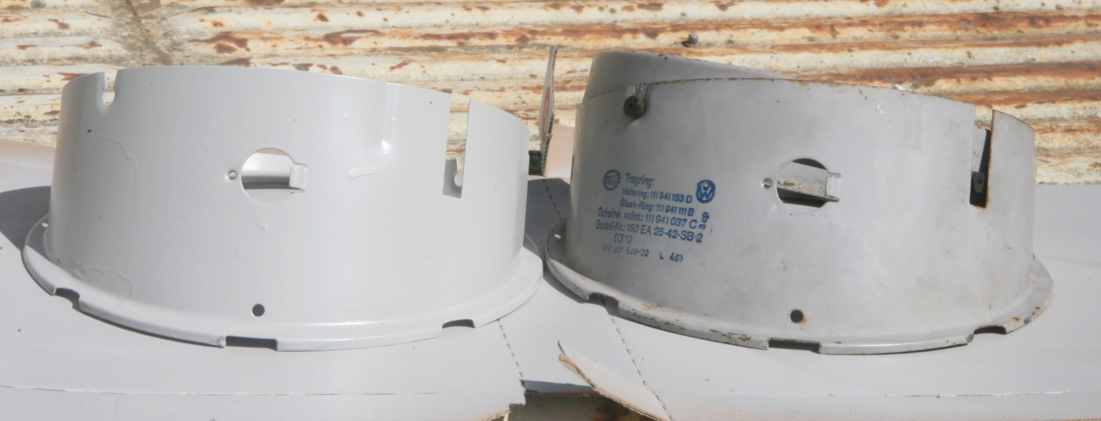

PostPosted: Tue Sep 06, 2011 4:10 pm    Post subject: Rustoleum Stone Gray vs. 67 original color Reply with quote
After reading a whole bunch of threads I went out and bought some Rustoleum American Accents Stone Grey (satin) paint to repaint the headlight buckets on my 1967 Double Cab. Color is pretty close in my book, especially when you taken into account the dirt and grime on the unpainted bucket.
Below are two photos, one with the buckets next to each other and the other one has just the focusing ring on top of the unpainted bucket.
Like I said, I'm happy. Hopefully, these examples will make it easier for some people too.

PostPosted: Tue Sep 06, 2011 5:29 pm    Post subject: Reply with quote
I would be happy with that match.
