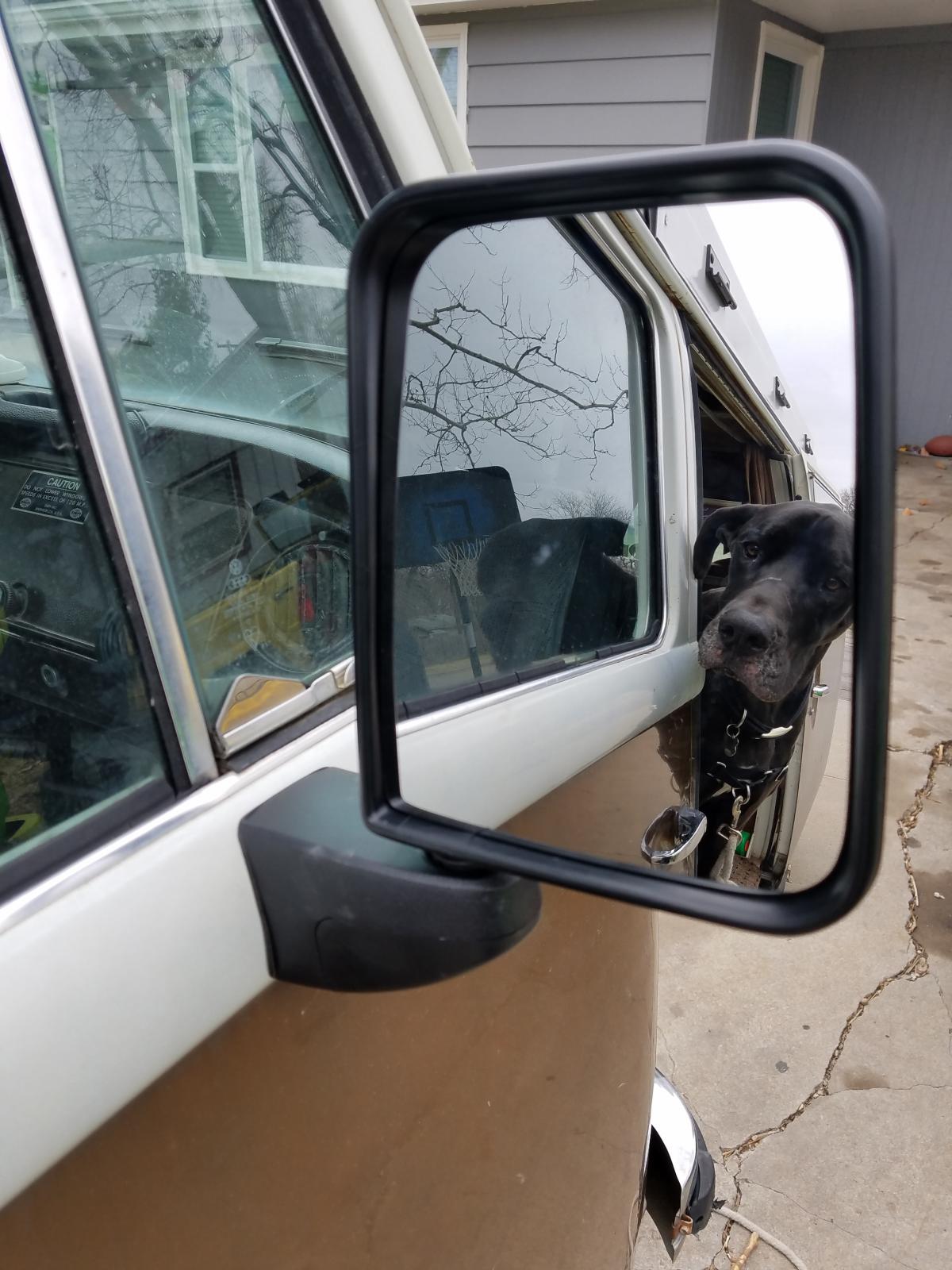

I have had these mirrors for the past couple years. They've slowly become loose and will move out of alignment as I drive.
Do you have these and do you know if they can be tightened? The joint with the arrow is where they have become loose.
I know they aren't OG. I like larger size mirror and look.
I tried removing them and spinning them to see if I could tighten the screw. It appears to be a ball joint and I can't see anything that would allow me to tighten the ball joint.
Worse case, I'll go back to OG Mirrors.
Thanks
Casey

Look at the underside of the actual mirror housing. (Not the part that attaches to the Bus.) There are two phillips screws. Tighten them a little bit and you'll be all set.
I recently installed these on my '78 and like them a lot.

Thanks vwwestyman!
I'll give that a try tonight. I did notice the phillips screws and tried tightening one of them but was more focused on spinning the whole thing like an idiot.
SO glad there's a way to do this.
BTW, looks like at least part Dane. I've got one too. Loves the bus.
Casey

Yup, Jackson is a Great Dane. He loves the bus! I have a long rope with a leash clip on one end, and a caribeaner on the other end. I hook the caribeaner to either a front tow loop or rear trailer hitch loop. Whenever I'm out front doing something (bus or otherwise) Jackson loves for me to hook him up on the rope so he can hang out in the bus and "help."
You do have to rotate the mirror to access one of the screws.

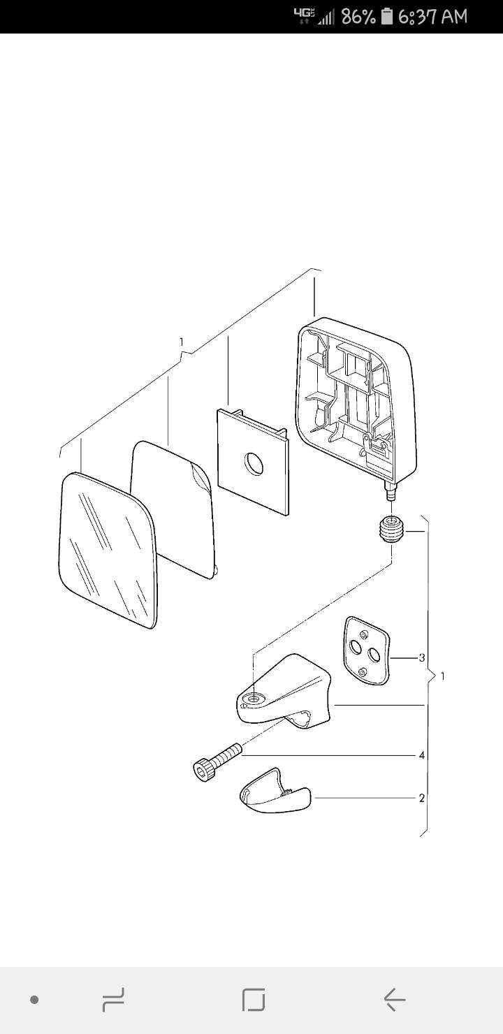

I've started to have this issue with my passenger side one. Its only 5 months old too. I've tightened the 2 screws down as tight as they can as mentioned above. But it still has the tendency to still move out of view on its own. Any other pointers or has anyone diassembled them to tighten that up as it that ball joint does screw into the lower housing?

Do you still have the one the glass fell out on? I'd like to if possible what the inside looks like for disassembly. You may also be able to re-adhesive your glass back on?
Drivers side is holding up fine. Passenger side is just the only one Im starting to have this issue with adjustment stabilty on. Found that diagram online and thought I'd ask others on this first. Thought maybe someone has corrected it.

Just for others information here if their mirrors loosen. I first sprayed some carb cleaner up into the ball socket. This helps remove any lube up in there. I used a 7/16 wrench under the rubber boot to tighten the shaft about a 1/4 turn.
Then got a small ratchet with extension on it and gave the 2 screws another turn slowly. My hand strength couldnt go anymore with a normal screwdriver. It all made a vast improvement and mirror seems to be holding more and alot stiffer. If it happens again I'm going to get longer screws with torqx or allen heads.
