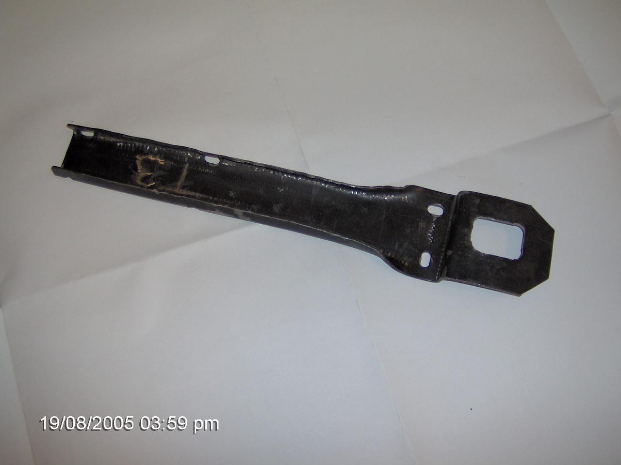

Here is the type 3 generator pulley tool I made in desperation one evening when I first got my squareback. I worked so well, I haven't bothered replacing it with the correct tool.
