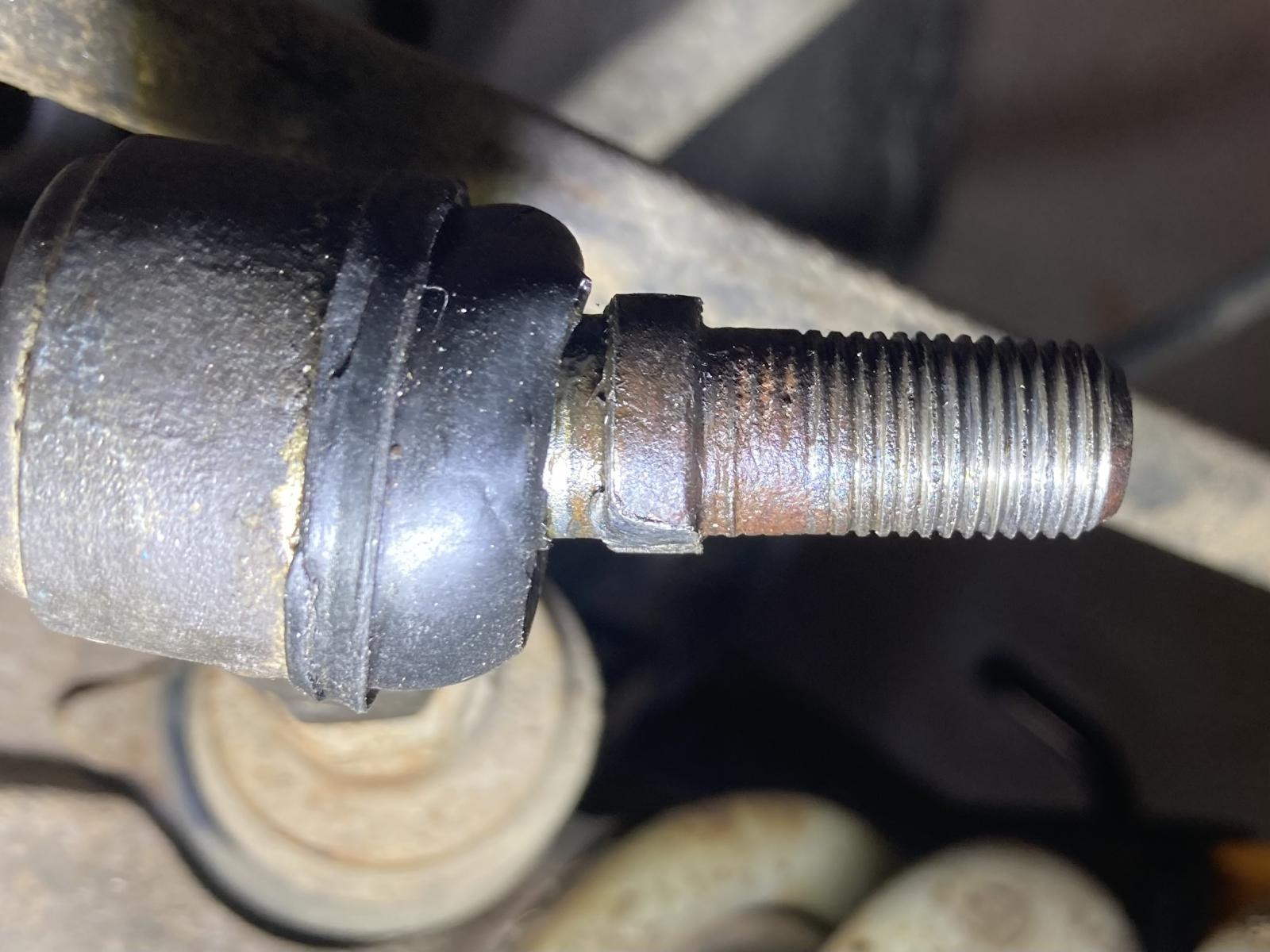

The M12x1.25 nut on the anti-sway bar end link took a leave and the threads on the end link got buggered. I don't have an M12x1.25 die and filing w/ a triangle file isn't delivering an effective result.
Is this end link a candidate for repair or replacement? If repair, what is recommended: thread chaser, thread cutter, file?
Thanks.

Follow-up: repairing threads on the T3 Technique HD endlink

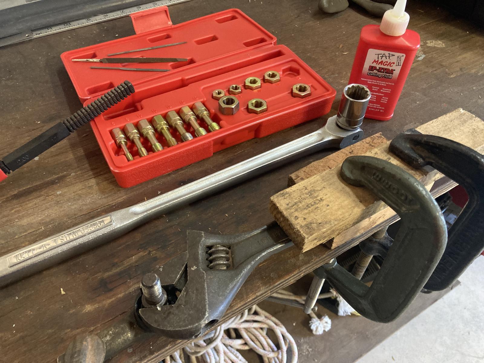

I bought this cheapo thread repair set on amazon that included both a file and a chaser die (one hardware store in 35 miles and it doesn't stock such tools)
https://www.amazon.com/dp/B07VYGK6GN?ref=ppx_yo2ov_dt_b_product_details&th=1
- First, it became clear that there was no way the die could have been used to start the repair because the threads were too damaged and the chaser couldn't be turned with reasonable force.
- The thread repair file (it is a life changer!) did great work returning the threads to some semblance of their former selves but they still needed work in order to function.
- I could then use the chaser to finish the work and reinstall the end link.
- It took about an hour to repair the thread.
Before (after attempting a fix for about 20 minutes with a triangular file, the first four threads looked as bad as the rest)
After
Not having a vice in this shop required some creativity to hold the threads while using a breaker bar to turn the chaser
