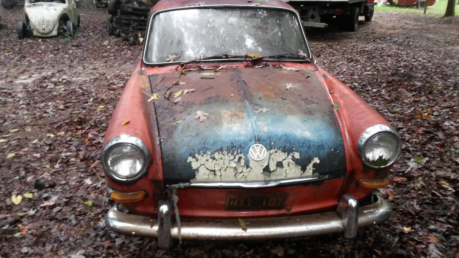

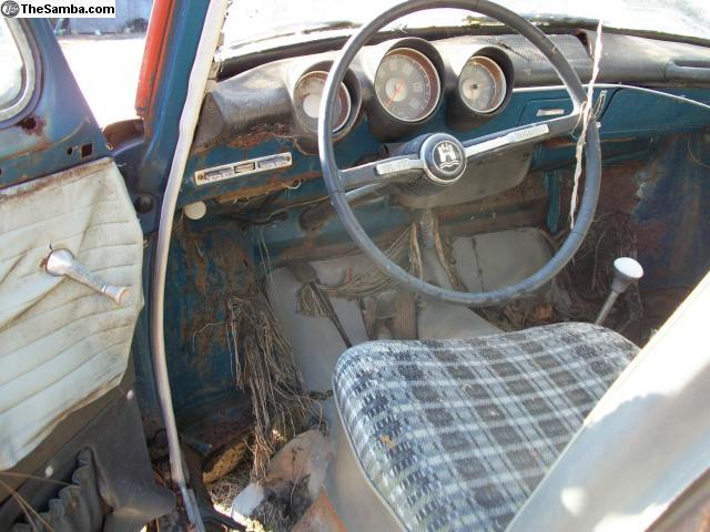

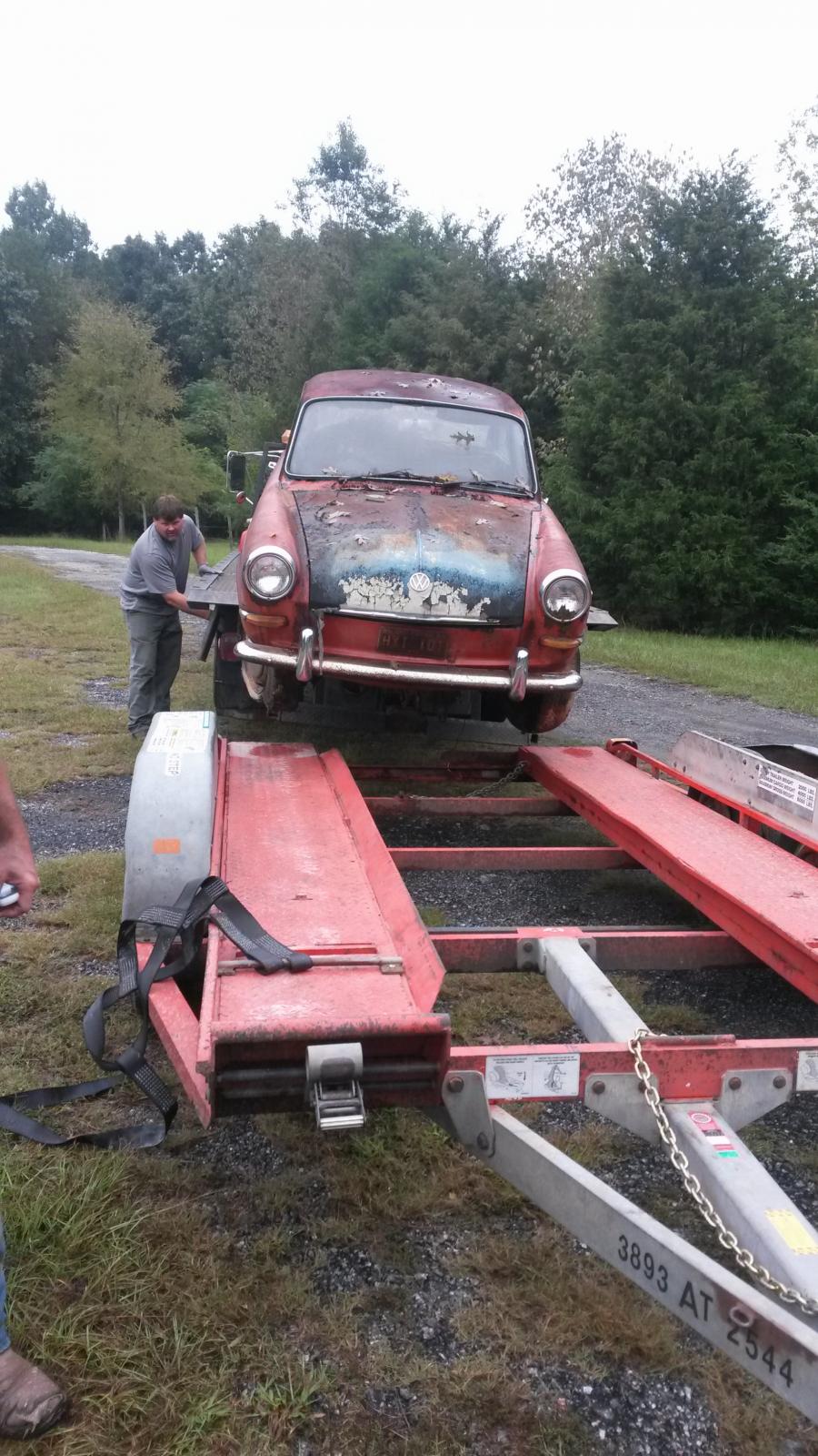

And I stumble across this one in the classifieds… not too far away

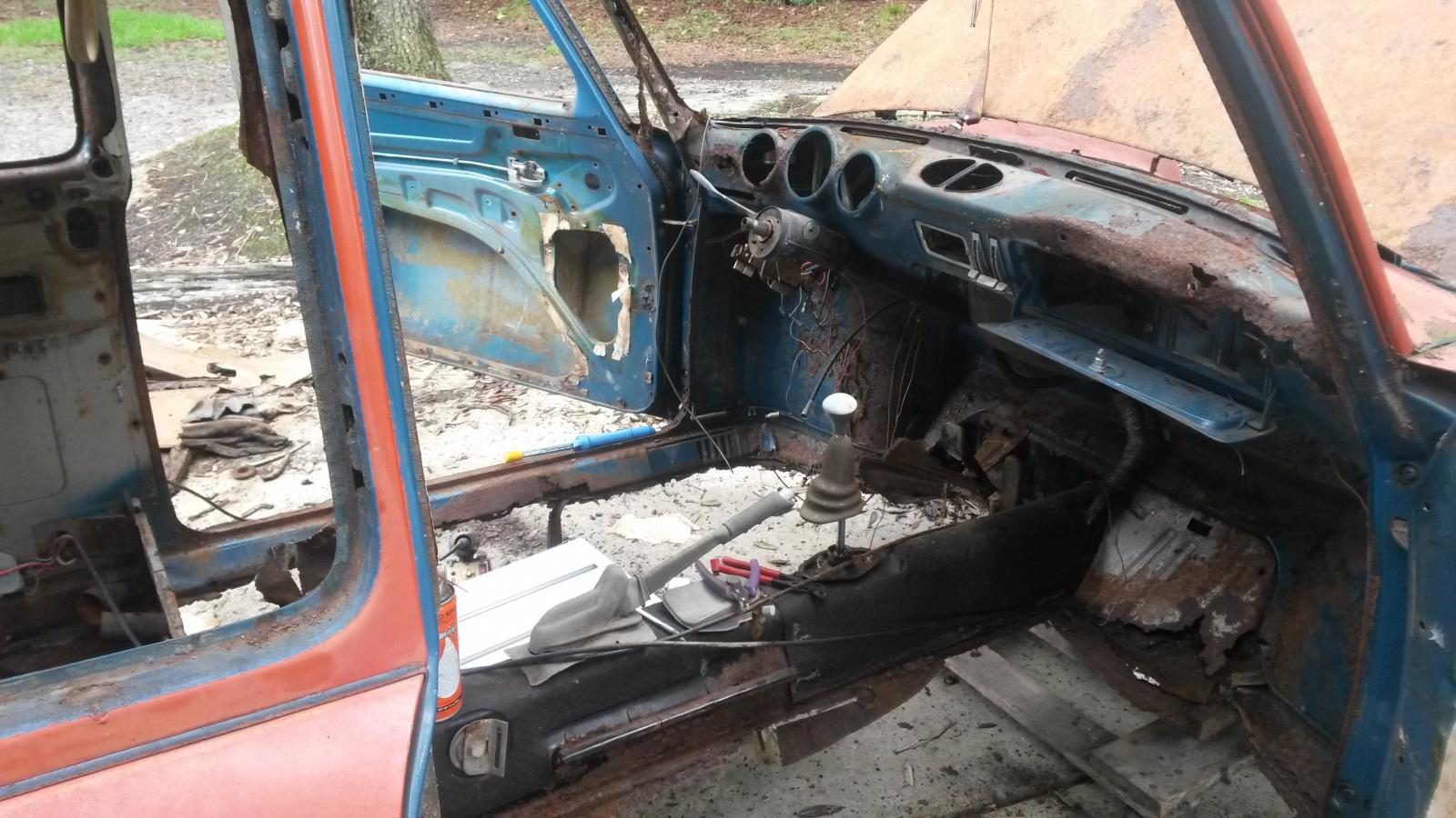

Now you really don’t have to be a genius to look at these pics and know that the best thing you can do is stay as far away from it as you can!
BUT… I had spent many days recently scouring through the Samba, looking at all the restorations, and after seeing guys like Flyertim with his ’57 Ohio Oval and Bert3’s Fasty , those two being my favorites, but certainly not the only, I figured it’s just time and money, and it’s really about the journey, right???

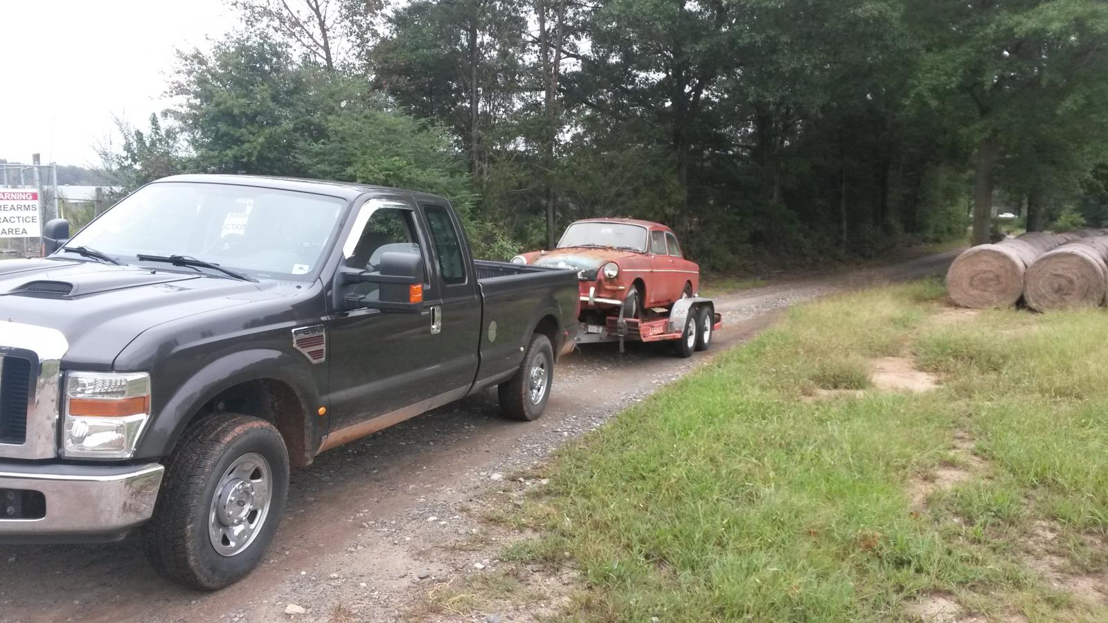

So I went up to Greenville, SC and bought it.
It’s all original, numbers matching front to back, 77000 original KM’s, red needle gauges, original wheels, and basically zero molestation except for the one extra shot of red paint, and what used to be a vinyl top that was added at the same time, to the roof and the front bonnet.
The roof has paid a hefty toll for this foolish decision, but I have plans…

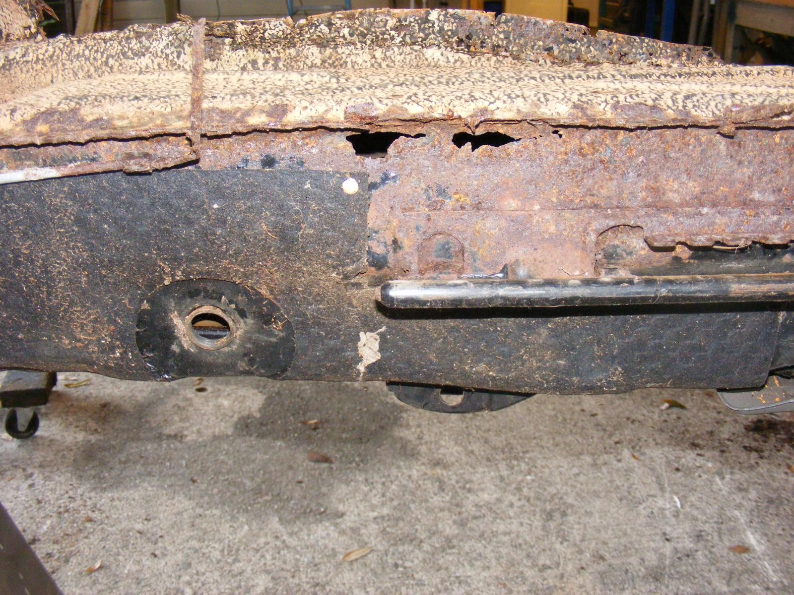

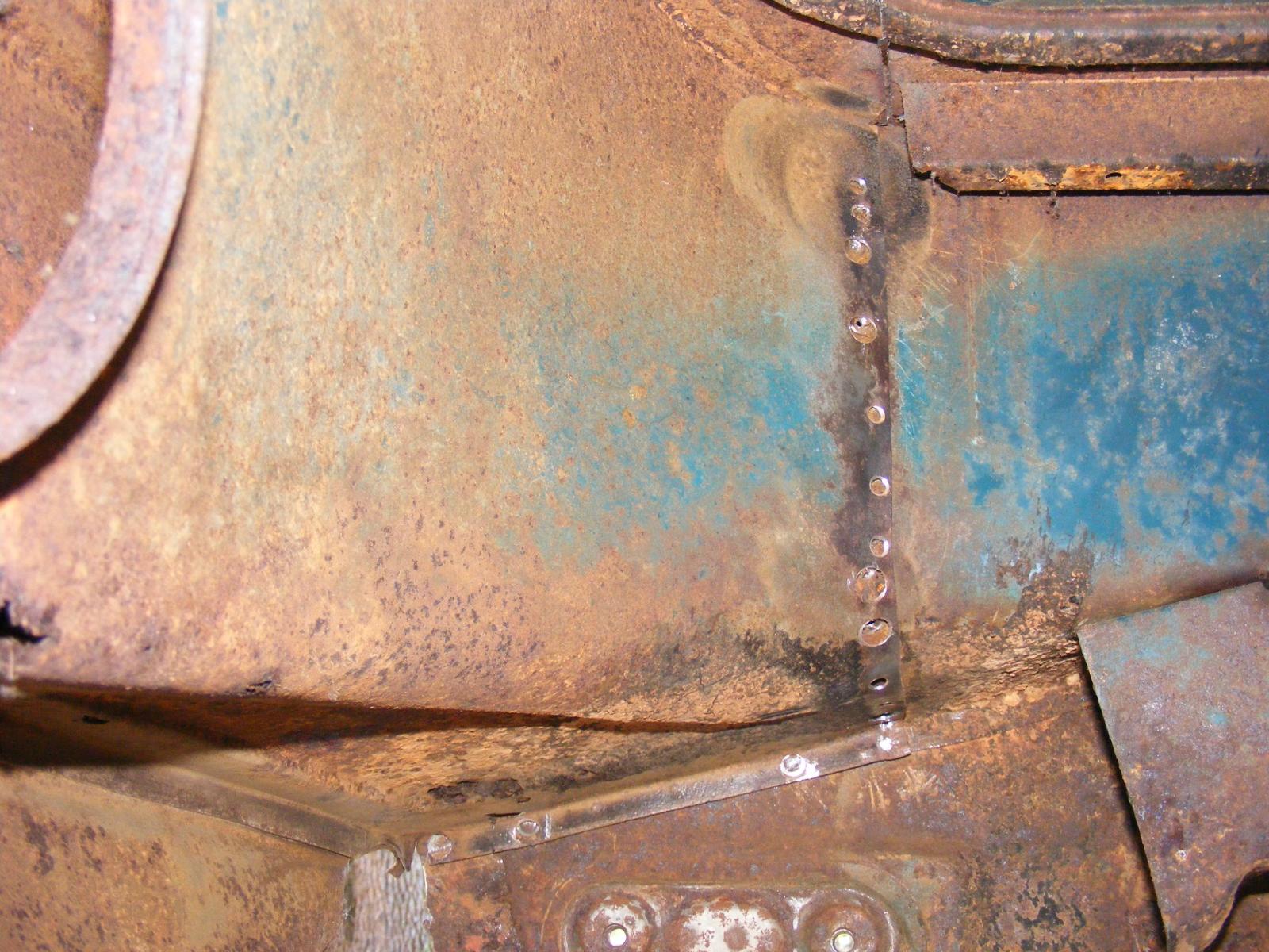

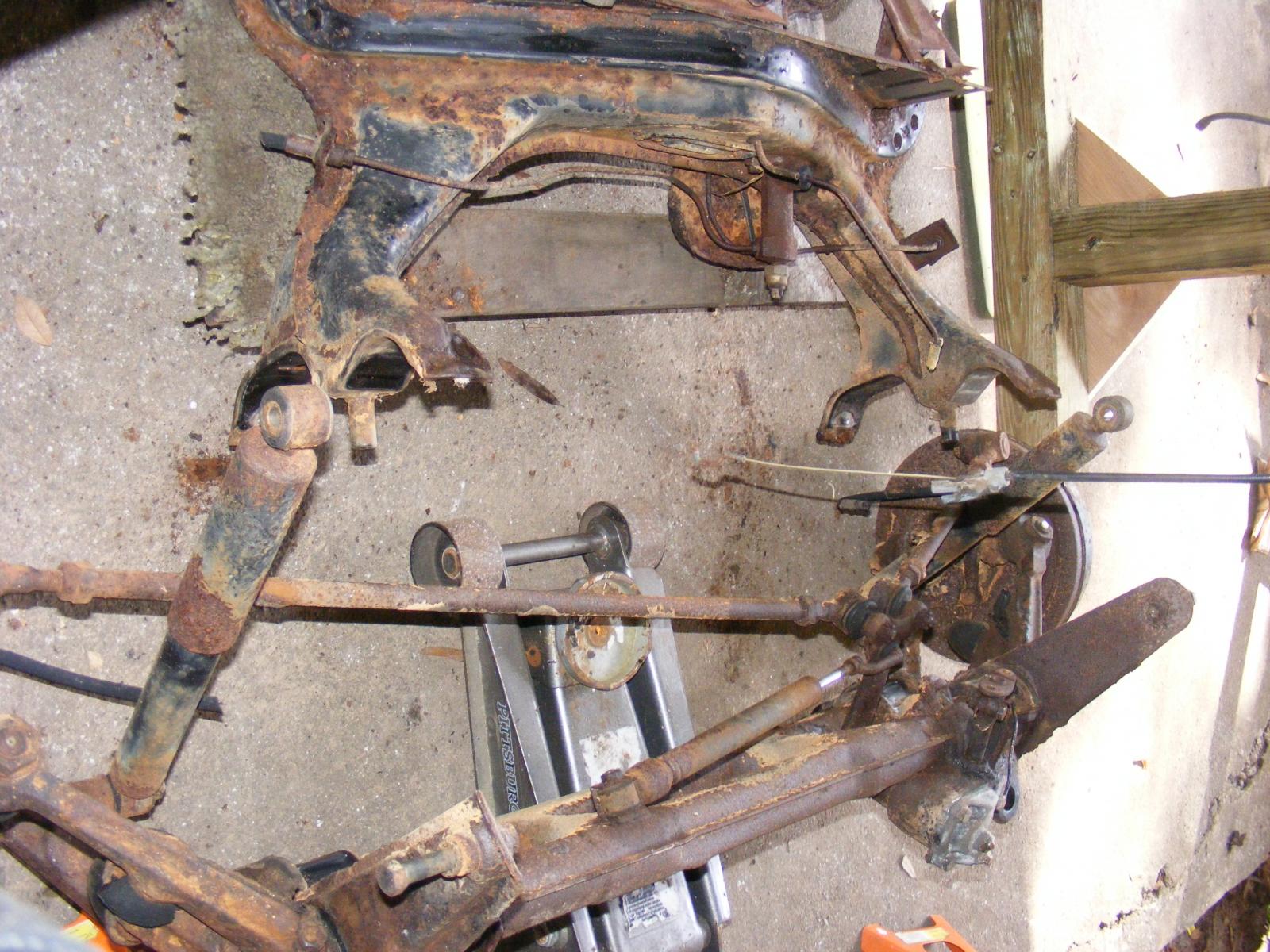

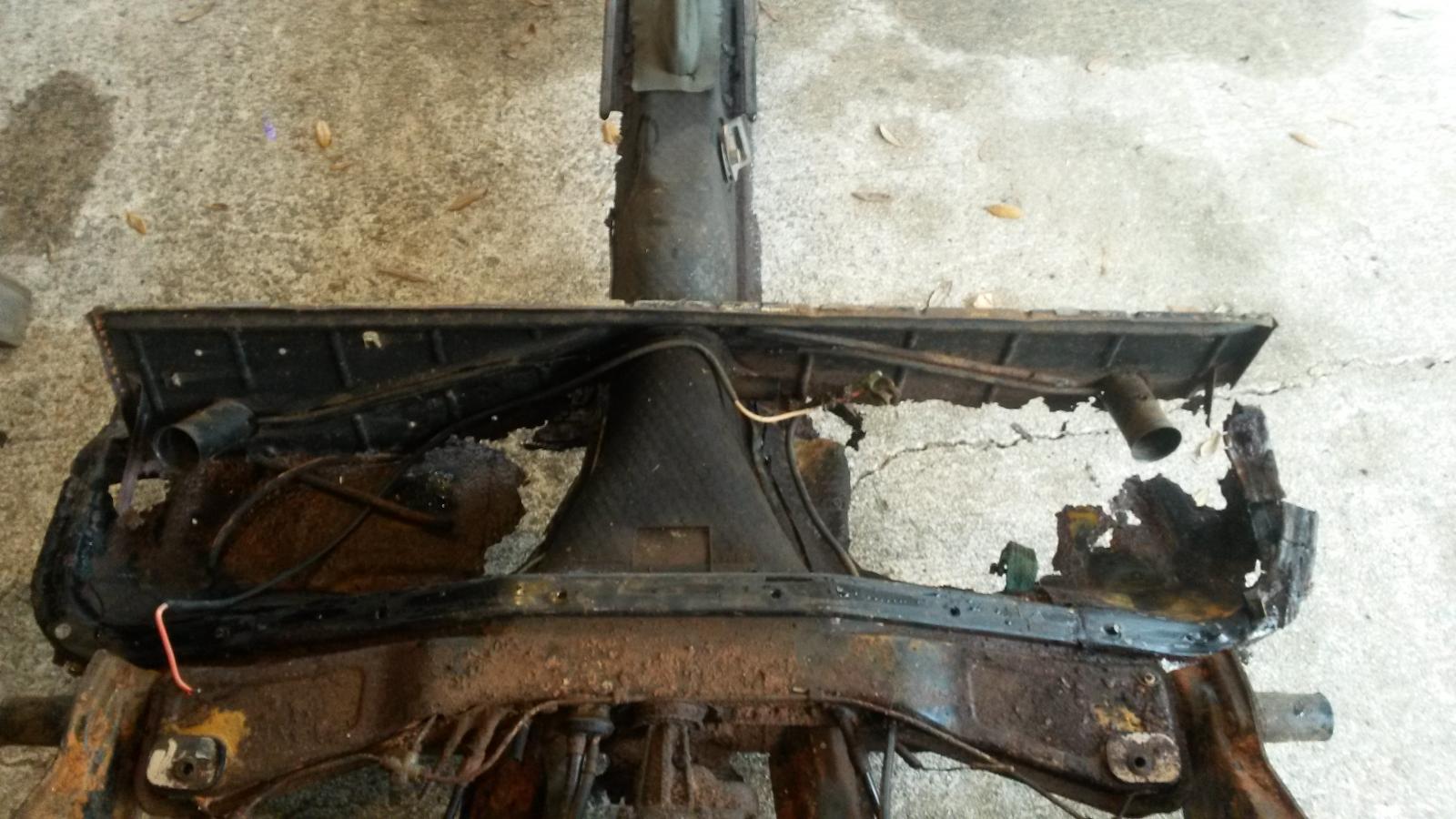

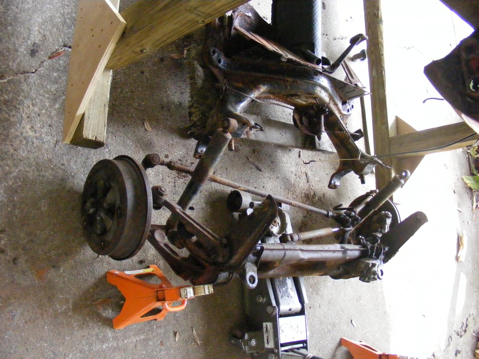

I got her home and immediately began disassembly.
No, I have not cut the pans out…. They simply weren’t there anymore.
But hey… less bolts to have to fight with right??!

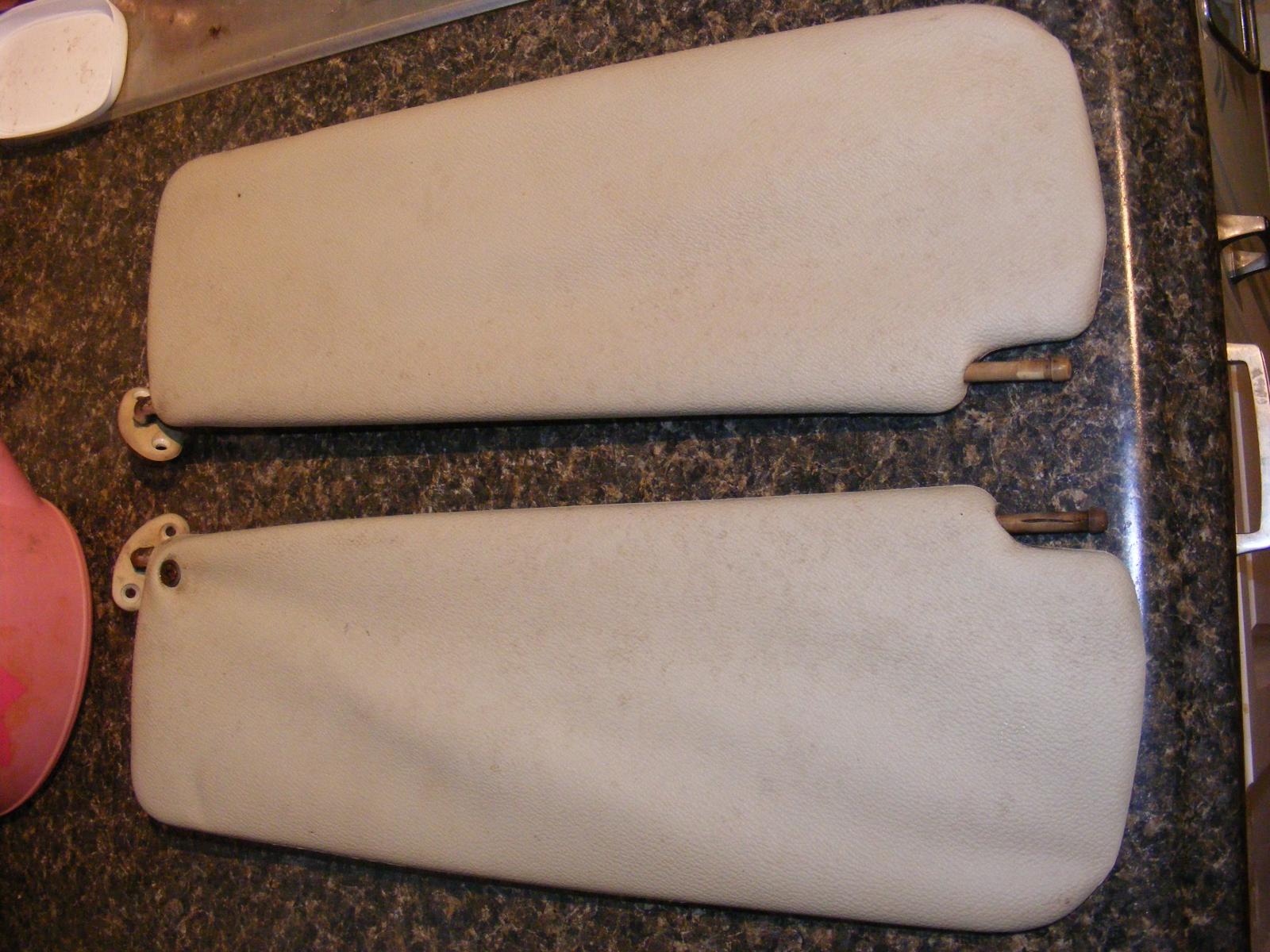

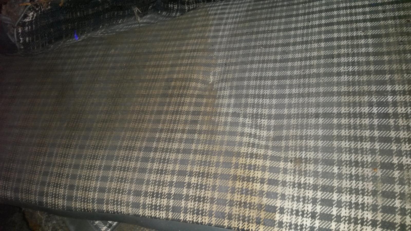

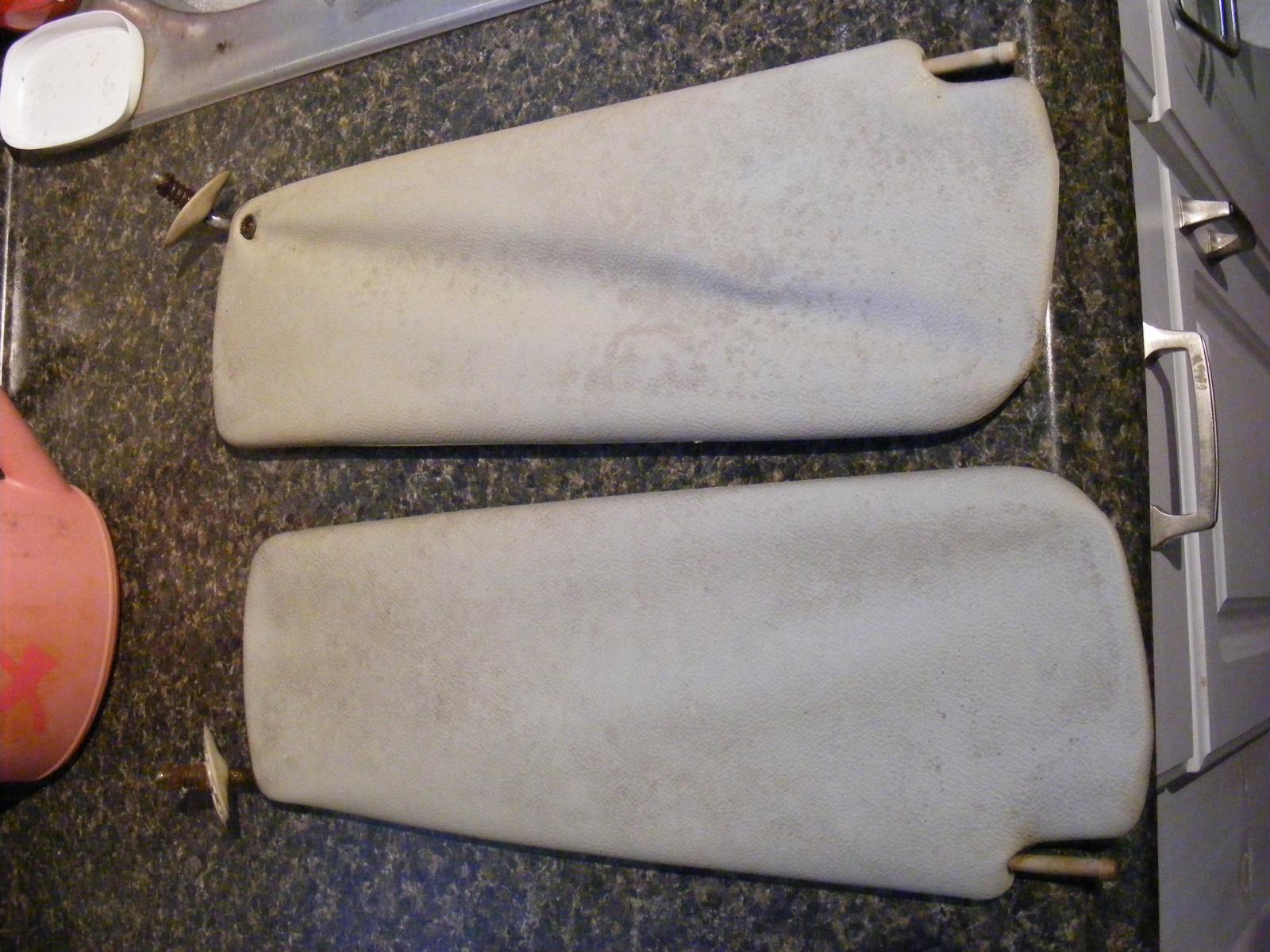

I thought I had the original interior, and maybe got some crossover into ’64 with some S&P fabric
But some research and a couple back and forth emails with Gizmo Bob determined it to be a recover.
I simply cannot get myself to like the ’64 original pinstripe fabric, so I am planning to go with S&P if they’ll sell it to me. (need to do 2 cars… more on that soon)

Wow! I say that again WOW. I've taken on some rusty cars before, but man that ones seen better days. I sure hope you got it cheap enough, as it's going to need a ton of work and metal tossed at it. By the time you're done, you'll have Joel's (Boo-Koo-Z) phone number in your speed dial. Laughing Shocked But seriously, take a look thru the links in my signature, as I've delt with rust before (I have more pics in my gallery too).
I even started with this (with my son's help),
and finished with this (my son's car).
Needless to say these are a couple of old pics, as the car is currently in the shop getting a couple of updates, in preperation for a type 4 engine (out of a 914).
Good luck with your project, and keep us updated with pics (we like pics).

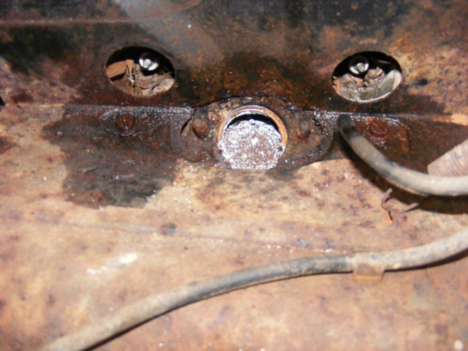

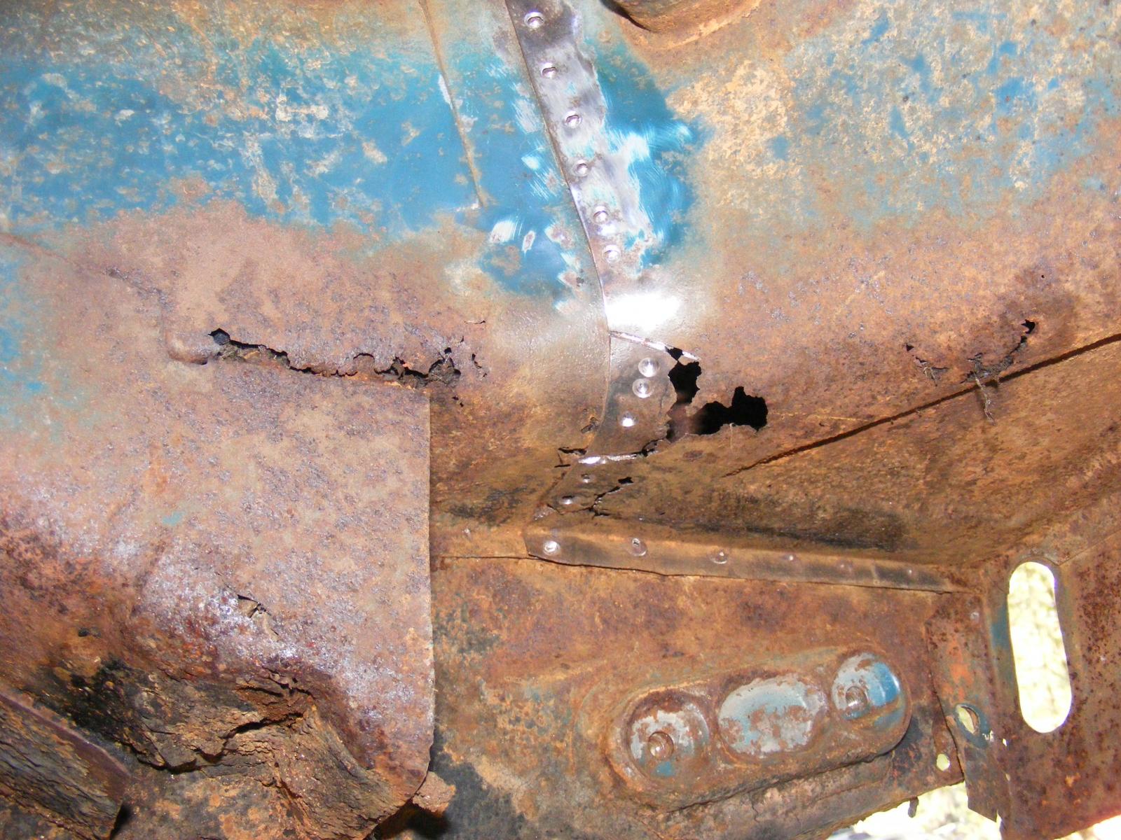

I did get a little work done on the pan. Started cleaning up the edges, found a bit of repair work to do on the center tube and frame head.. what a mess!

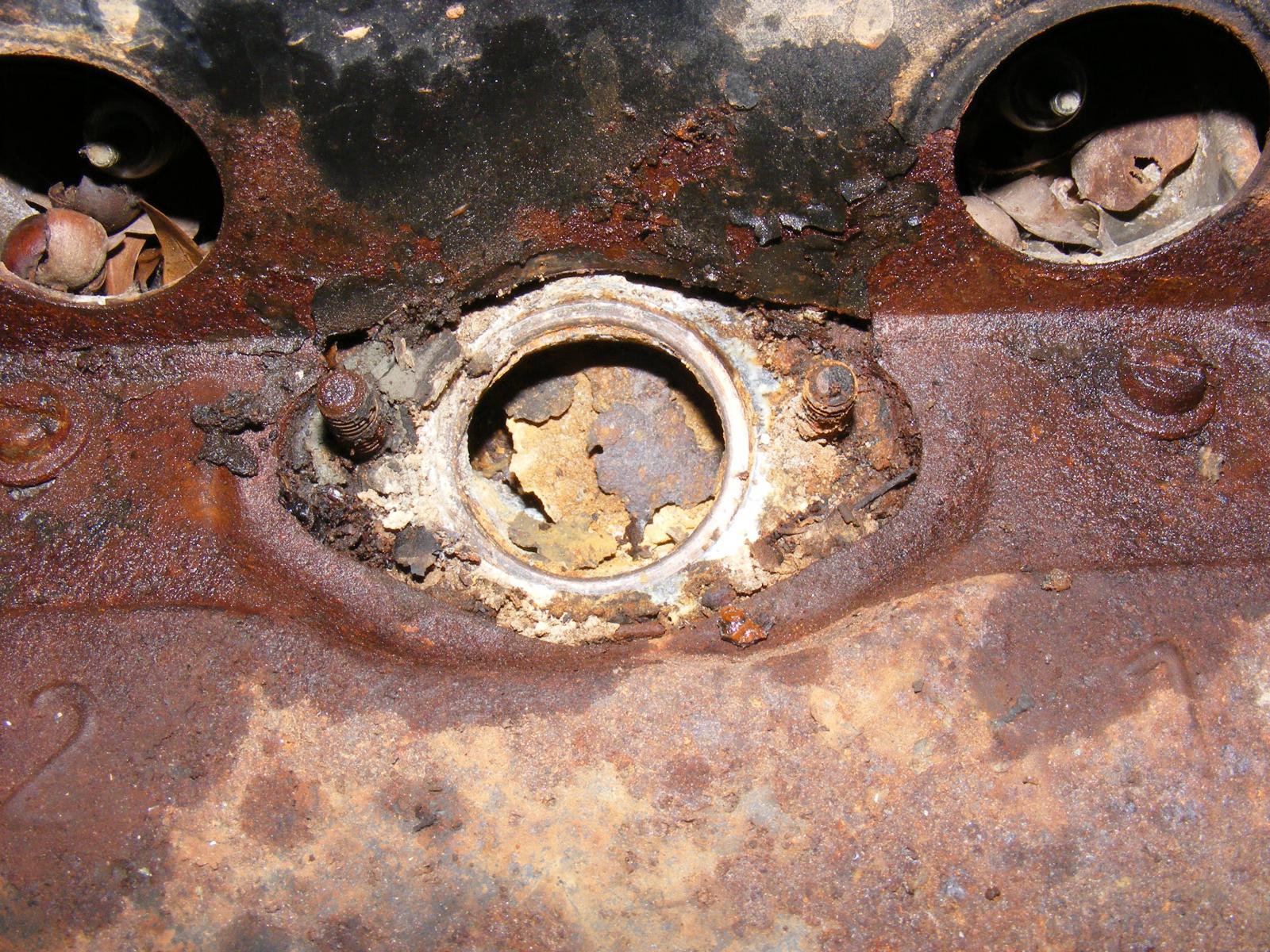

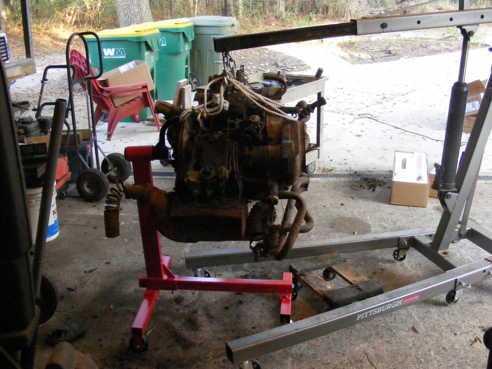

Got the engine up on the stand. It’s froze up after 40+ years of sitting, but it’s complete, and the oil was real clean

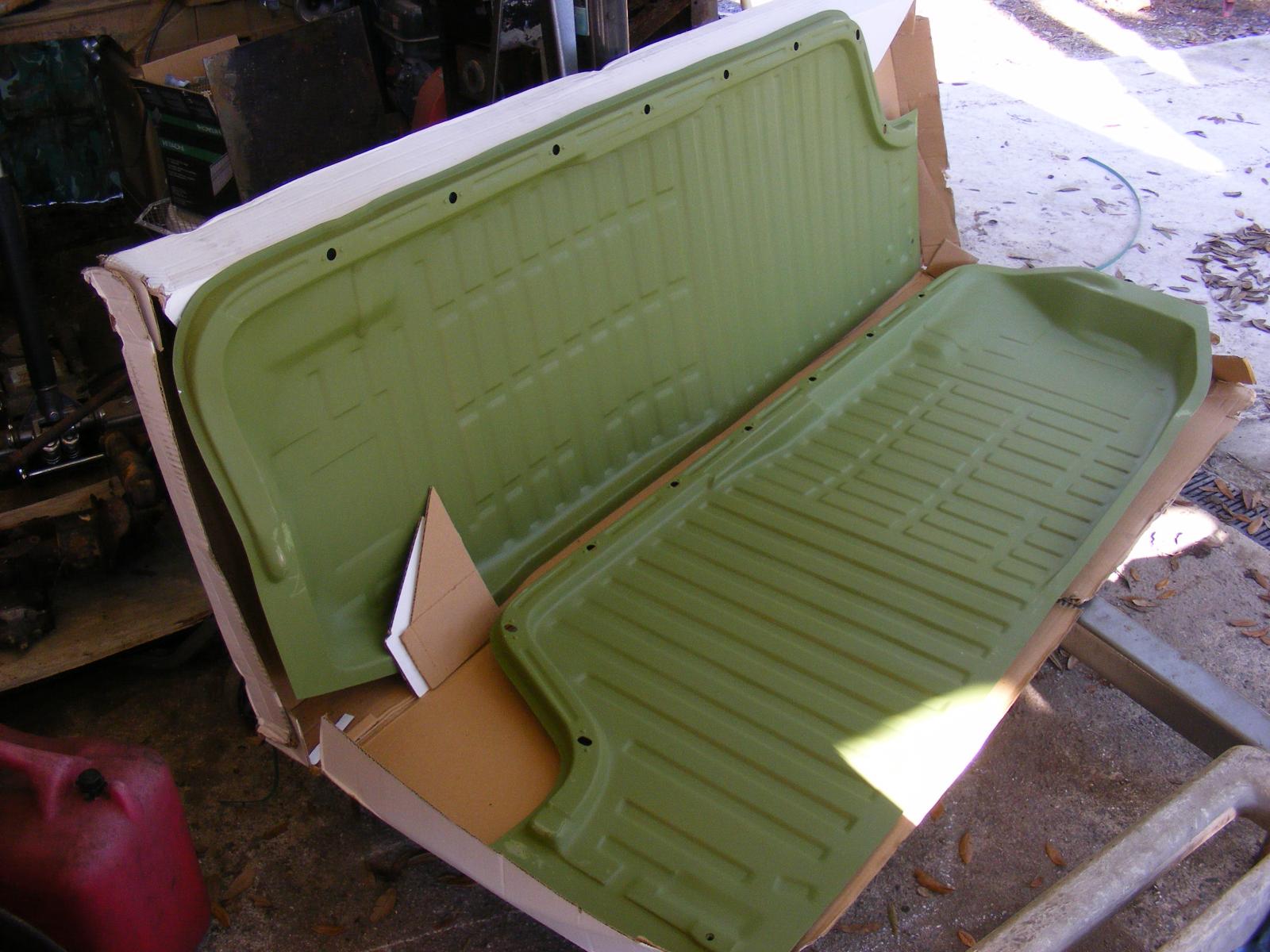

Then as I was wrapping up for the day, DELIVERY!! I got my funky green sheetmetal from Gerson/Monkeynut!

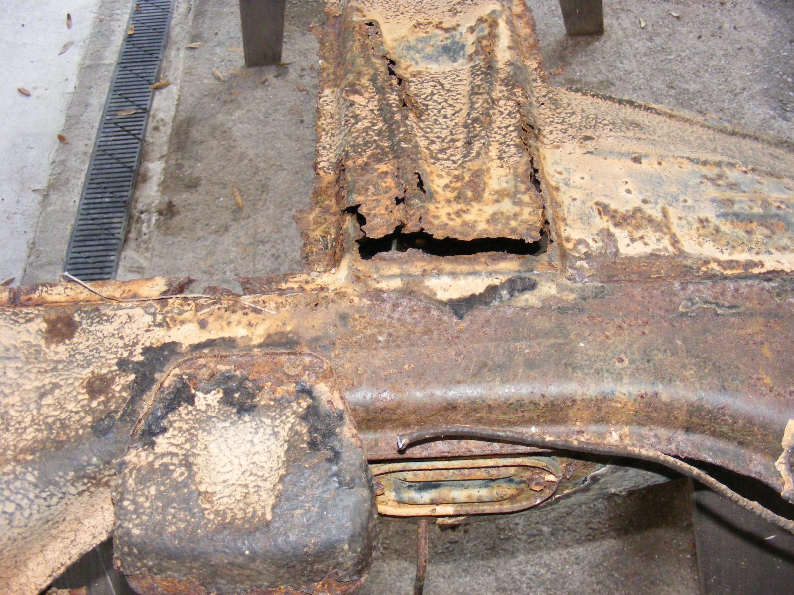

Granted, I’ve done a ton of cleanup, and have started cutting out the cancer, but getting new parts and preparing to install them means it’s really a restoration now, and not just disassembly!
Still miles to go, but it’s cool to put my hands on a clean, NEW part!

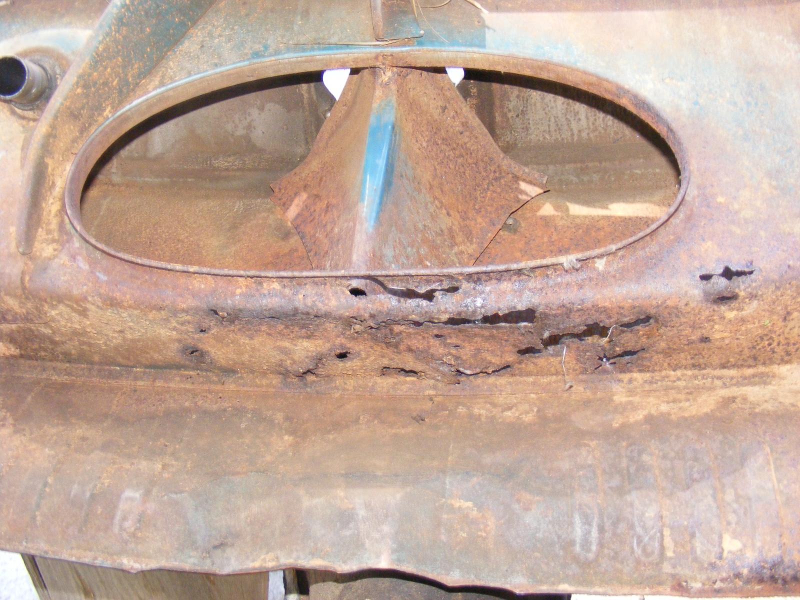

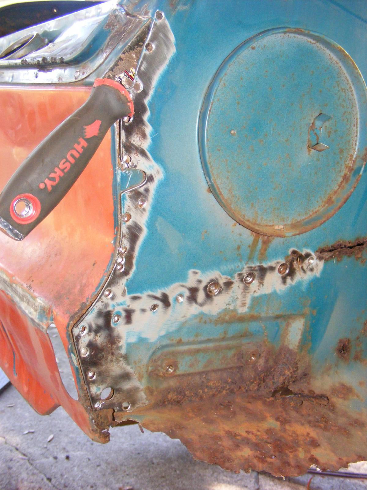

I got the rear apron removed. The top engine deck will be replaced, and I have a few areas in the duct that need cut out and replaced. I figured the best way to get in and stop the inside-out rust was to take it off, and prep the inside. I keep finding more and more to replace, but so long as I can find the parts that fit, should be no problem… right??? (grin)
I’m using the Harbor Freight spot weld cutter and a combination of drill sizes, as necessary. The ¼” drill seems to be the most common one used, and removes much less material than the HF cutter does. I’m trying to remove as little as possible, knowing it all has to get put back!
The Husky putty knife is doing a great job as a separator. It’s real thin, yet still stiff enough to give it a whack every now and then

I've got a butchered up 1968 T3 that I'm getting ready to cut up for scrap. I don't need any of the sheet metal for my rail except the tunnel for the shifter and E-brake mounts. There's rust in the usual places for a car that has been up north (Montana) for a while. However it does look a bit better that what you've posted in your last set of pics. If you need any specific parts of the metal let me know and I can post some pics to see if you want it. I can't help you with the nose or the roof as I didn't get one with this car. You can have whatever you think you can use for the scrap weight price plus the cost of shipping. I've got some older pics of it in my rail thread in my sig.
EDIT: I went out and took some overall pics. Here's a link to the Photobucket album. Let me know if you need any pics of specific areas I didn't get.
http://s326.photobucket.com/user/GoMopar440/library/Butchered%20T3?sort=3&page=1
Here's a few of the pics.

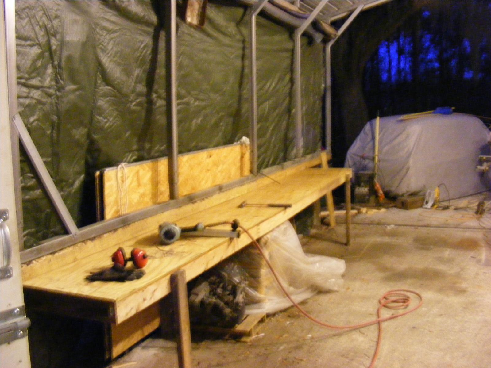

It has become clear that my shop and carport are nowhere near ready for all the work that will need to be done! My workshop is basically set up for woodworking, and it’s already too small, so Sunday I decided to build a workbench along the side of the carport with some scrap lumber.
If only the car work would go as quickly! Anyway, we now have some space to work on things, and eventually will put some cabinets underneath.
I also pulled the carbs off the engine Sunday… “just to have a look”.. and it ain’t pretty.
How the heck to acorns get under the tins? The bellows was torn, but the plug wires were all in place.
Good thing I’m already planning a full rebuild.

I also got the visors cleaned up too so I can store them. They came out much better than I anticipated.
Before, as they came straight out of the car
And after, only took about 10 minutes with some mild soap and hot water.
I need the little retainer clips. Are they out there, or did I find another piece of unobtanium that I need?
What are the visors made of inside? Cardboard like the door cards? One of them feels all crunchy inside, but it still has shape.

PostPosted: Sat Dec 19, 2015 1:34 pm    Post subject: Re: Restoring "The Cougar", a '64 rusty Notchback Reply with quote
ISP West has the visor clips.
Justin
