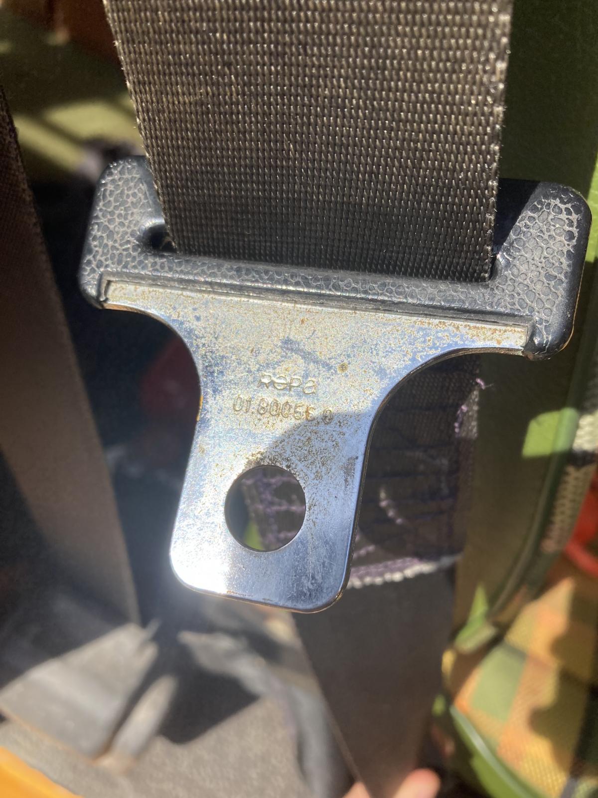

PostPosted: Mon Sep 27, 2021 11:32 am    Post subject: Re: OE style retractible seat belt? Reply with quote
The belt tongue says "REPA" and then a part number, and the buckle also says REPA and has a VW Logo.
AFAIK REPA was VW's OEM.
-Ian

PostPosted: Mon Sep 27, 2021 11:58 am    Post subject: Re: OE style retractible seat belt? Reply with quote
I texted the folks over at the Busted Bus, who have literally some of the best customer service I've ever experienced. (definitely the best for a company that sells used car parts)
And they texted me back several photos of seat belt mechanisms until we found a match. Early vanagon belts seem to be an exact match. Down to the part number on the tongue.
Luckily they had several in great shape, so I grabbed one. Which will let me use the stock buckle and everything, exactly like I wanted.
The plan is to re-wind the old one as a spare though.
-Ian
'77 Westfalia - 2.0 F.I

PostPosted: Thu Sep 30, 2021 11:16 am    Post subject: Re: OE style retractible seat belt? Reply with quote
Got the new belt in the mail, it's identical in every way, except the tongue is slightly too thick. I'm going to try and take it to a friend of mine with a belt grinder and fix this issue.
Meanwhile, I have been unsuccessful in trying to find a shop to re-spool the old belt. Has anybody else had this done? I don't trust my sewing skills enough to attempt it myself.
