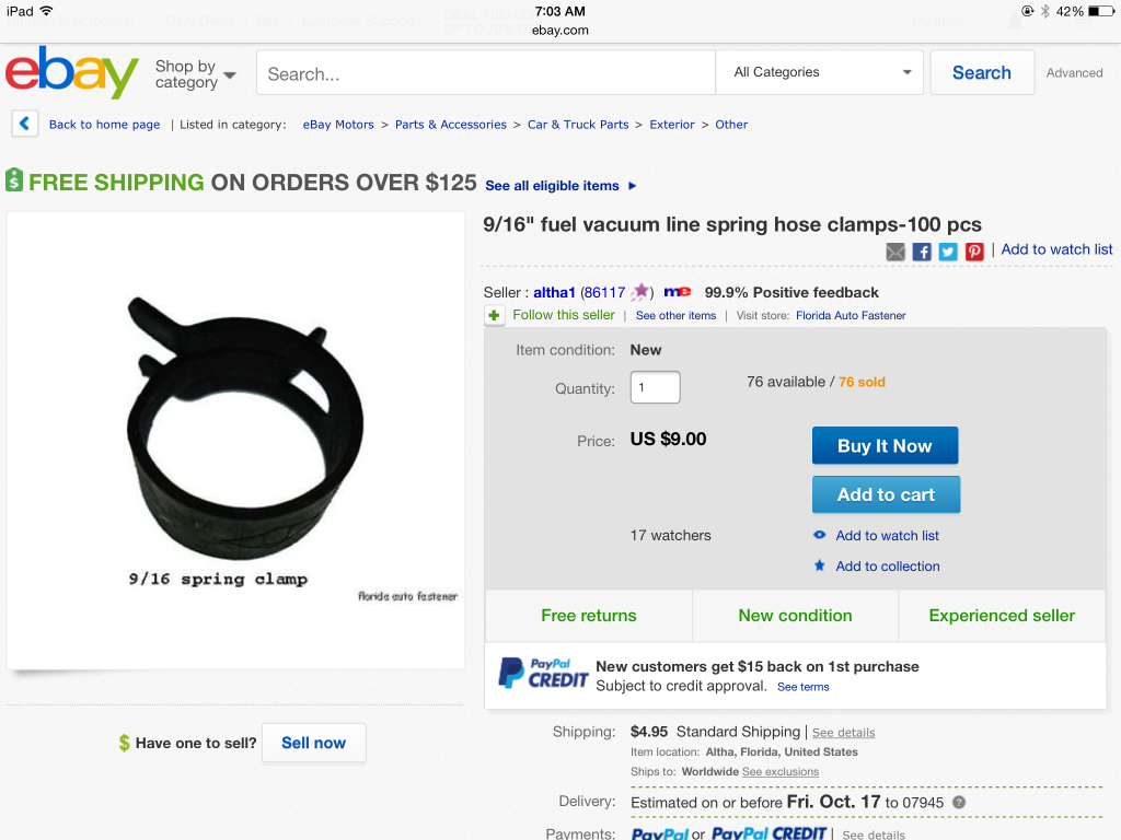

these are what i've been using for the last couple of years, i've gone through 300 or so, all the vans i've put fuel lines have had these fuel line clips these are reuseable unlike the oetiker clamps, and a good bit cheaper.
i had them on lucy for over a year before i put them on other peoples vans, no leaks on any of them.
if you pop the hood on a modern VW you will find these all over the place, and they are LOT more expensive if you buy them from VW Wink

Do you know if this fits the gates 27348 hose? I might give these a try.

sorry i have no idea, i don't have any gates fuel line, what's the OD of the gates fuel line, i can go and measure what i have, if that would help.

Intellectually I understand Spring Clamps and the principle behind their function.
Be it the flat spring steel clamp or the wire spring clamp......
The constant squeezing action through expansion and contraction cycles makes perfect sense........
A proven method of installing hoses for DECADES!
In my over half century of wrenching...... I've seen very few actually fail, a few squeeze ears broken off and an old wire type simply broken ........
But.....
There is a mechanical inner force in me that doesn't quite trust them, that force wants to rotate a screw to make something tighter!
Not unlike knowing that Ice Cream isn't good for you and that frozen yogurt crap isn't as bad...... But ice cream tastes SO GOOD!!!
Rubbachicken's link.........

Hopefully not a significant drift...
Is there a specific tool out there for this type of spring clamps? I always use pliers of one sort or another...
Yes, they are all over my GTI.
Oddly, the emissions pipes also have Oetiker style clamps on them.

Are those rated for fuel injection pressures?
I can't see how they possibly can be and certainly won't be using them on my bus anytime soon. They just seem so weak.
Heck, I put a new carb on our Dodge truck recently and It used these, and I wasn't overly confident with their tension to hold on a fuel line that operated at a few PSI, let alone the high pressures of the vanagon system.
To each their own I guess.

Come to think of it, I think these are only used on the GTI for cooling system hoses.

go look under the hood on a new VW, these are all over the fuel lines, if you have the right size for the hose, they clamp very well, remember over tightening damages fuel line anyway, like i posted i put them on my van first, before using them on anyone elses, they are fine.
http://www.amazon.com/OTC-4525-Cable-Type-Flexible...amp+pliers
Couldn't work on my VW's without my Craftsman version... it's gotten lots of use.
According to the VW parts catalog, these are the factory clamps on the fuel lines, which are spring-type: http://www.vwbusshop.de/epages/GuenzlClassicParts....iewProduct .
My van has reusable metal clamps that I've no clue what their proper name/type is. Next time I have the lid off, I'll try to remember to snap a pic of them.

those pliers are WAY to big for fuel line clips though.
i use just a regular pair of pliers, for the fuel line clips, those are for coolant hose clips
