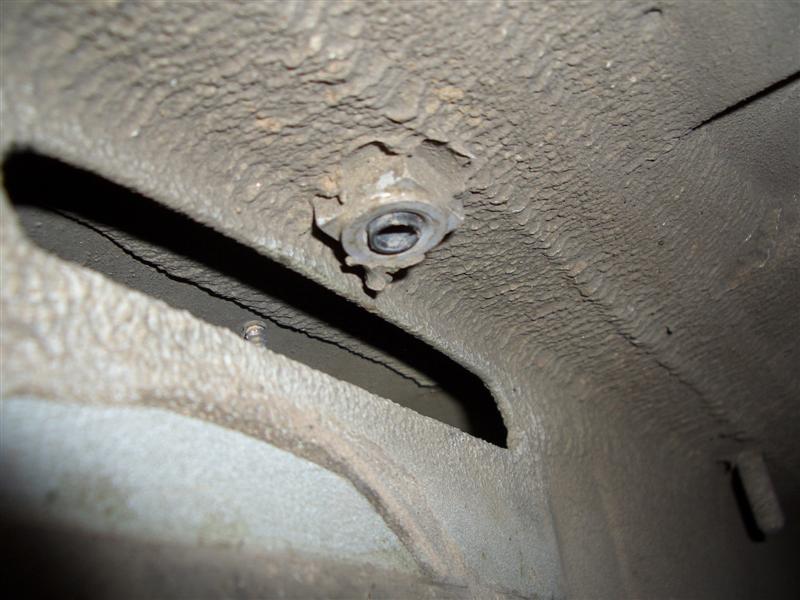

Having a problem with my Westy water connection. Hooked up to the city water connection, and after a few minutes, heard water leaking on the ground. Found water to be running from the underside of the van on both sides. 3 spots on each side of the van. Crawled underneath, and here's what I found...
Passenger side
Quite the puddle
View from underneath, just inside from the sliding door
Another similar spot
Is this a body drain hole?
After quickly shutting the water off on the supply side, I checked under the sink - found water all over the shelf, and the wonderful smell of wet insulation. I figure the seal to the sink from the city water connection has to be bad. Gonna pull the whole works out next week and try to track down the problem. I'll replace all of my water lines while at it. Hope I didn't do any damage in the meantime! This is the first time I've ever connected for any length of time. Only connected once before, for just a few minutes, and that was several years ago.
Anyone have any input? _________________ No need to bear the weight of your worries, you let them all fall away...

Ya, I have some input. Nothing earth shaking. You have a leak. Did you use a pressure reducer? You will simply have to find the leak. Start under the sink. You may also end up pulling the outside connection off to see. Otherwise the hose is damaged somewhere and will need replacing.
No the big problem is all the wet insulation. I know very well from experience that the stuff does NOT dry out. Crappy ass stuff holds water better than a sponge. YOU HAVE A PROBLEM.
When I discovered my rear heater had leaked, I ended up pulling almost the whole interior out. That van reeked when it got hot inside. Only thing to do was to clean clean clean the funk of the decades out. It is nice and fresh in there now. BUT, I did get some insulation wet. Put it in the So Cali Summer sun and it took days, almost a week to dry out. At that I had to flip the stuff over, too. BAD, BAD, news.
Sorry, I think you are going to be pulling stuff out before it smells and starts to rust.
"That's my opinion, what's yours?" _________________ "Use the SEARCH, Luke" But first visit the Vanagon FAQ!

I had a feeling that pulling the insulation was in my near future. My last camping trip of the year is coming up next weekend, so I'll do it all when I get back. I've got lots of work to do in the near future (carpet kit, wiring, etc.). What's one more project, eh? _________________ No need to bear the weight of your worries, you let them all fall away...

This topic hit home since yesterday I just pulled out all of my interior (bench seat, sink cabinet, and water tank cabinet) to deal with some "kitchen rust" I found after removing my fridge. Anyhow, I've yanked out all of my insulation and I'm going to replace it with something that is closed cell that doesn't hold water. I've seen several posts about using "Frost King" from Home Depot, haven't checked it out yet.
The city water connection is real simple. Unless the hose itself is leaking there is only 2 fittings, one at the back of the utility port outside the van and the other attached to the faucet. Unscrew the faucet and you can access the connector. There is good diagrams of all of this in the Bentley. Pulling out the interior was not too bad, If I were you I would probably pull it all out anyway to get rid of that surely wet insulation and check for rust etc...

Before using your water hook-ups you should go through your connections and seal any that might be leaking, most westy's are pushing 20 years or more and some have never been inspected or even used.
I wrote a post on using the plumbing awhile back:
http://www.thesamba.com/vw/forum/viewtopic.php?t=120652
If you have a water leak in the van don't have a heart attack yet.
The rust problem comes when you have a leak that soaks into the insulation in the wall.
One thing that was done when your Westfailia was made into a camper was to put sheets of fiberglass insulation in the walls of the van.
It's just like the scratcy rolled fiberglass most people have in there attics, you know the Pink Panther stuff.
It works as an insulation, but it also makes a great sponge, so it holds water against the steel alot longer then if it just leaked out the bottom.
If you just noticed the leak (or you caused it) get as much as you can, and it will more than likely dry up on it's own.
Since it's still warm out I would park that side of the van in the sun and let the sun heat it up, might help it dry up quicker.
