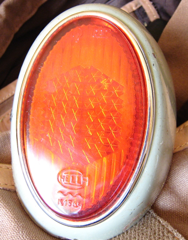

Are these the "reflectors" ???

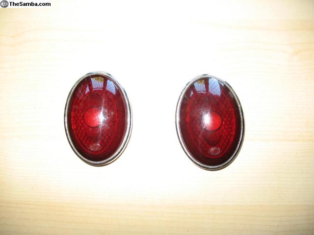

AlteWagen Troll
Joined: February 23, 2007 Posts: 8730 Location: PNW
Posted: Sun Aug 23, 2009 10:44 pm Post subject: |
Still never got an answer here
http://www.thesamba.com/vw/forum/viewtopic.php?t=354891&highlight=late
I still think there was an early (54? thru 55) extra low snowflake tail light fender.
Here are the swedish lights.
Are there any survivor 54-early 55 swiss cars with these lights?

The two cars I posted here, with the "reflectors" are Swedish. So, I think it is possible to be what he are looking for M 018
And so, we have cars going to Portugal, USA, Canada, even Germany. So looks like it is not only Swedish. Am I wrong ?

BTW. I am pretty sure M18 is not related to tail-lights at all. in 54 there were no cars using snowflakes, but we can see M18 in 54 and 57, so two differet taillights. pretty sure it is the reflectors attached to the bumpers. _________________ 1957 Typ 113 - Polarsilver

Posted: Mon Aug 24, 2009 11:53 am Post subject: |
| igtoth wrote: |
m018 states Larger reflector in brake / indicator light
didnt splits have the brake light in the nose cone and the indicators being the semaphores? I thought the fender lights on splits were just running lights. |
