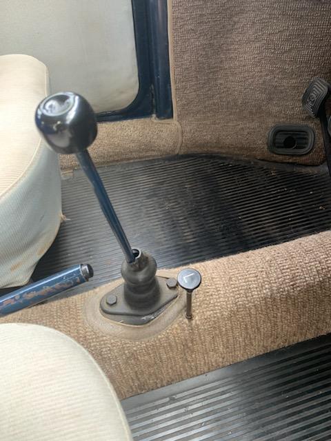

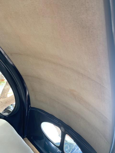

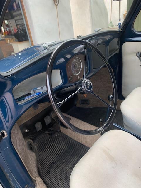

just got these from the seller, what do we have here? thank you
sled
Joined: February 16, 2005
Posts: 6248
sled is offline
PostPosted: Mon Apr 25, 2022 7:26 pm    Post subject: Re: 52 VIN question Reply with quote
It appears to be an August of 1952 11A standard beetle. It was very common back in the day to add trim to standard models to make them appear more "deluxe"
also, some Hoffman imported standards received trim from the factory.

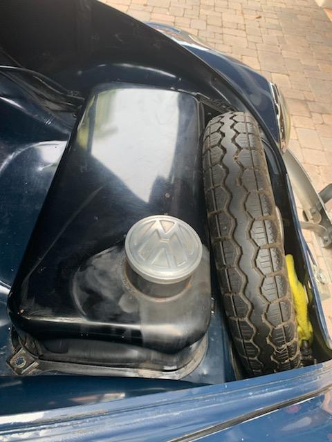

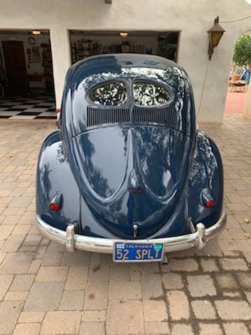

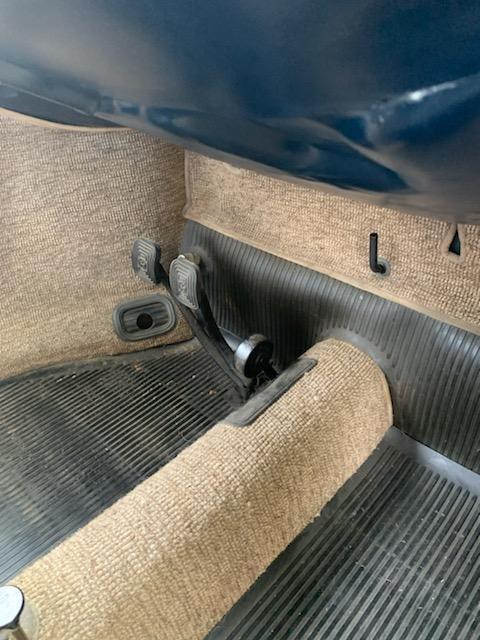

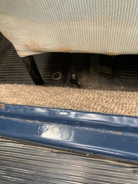

PostPosted: Mon Apr 25, 2022 8:19 pm    Post subject: Re: 52 VIN question Reply with quote

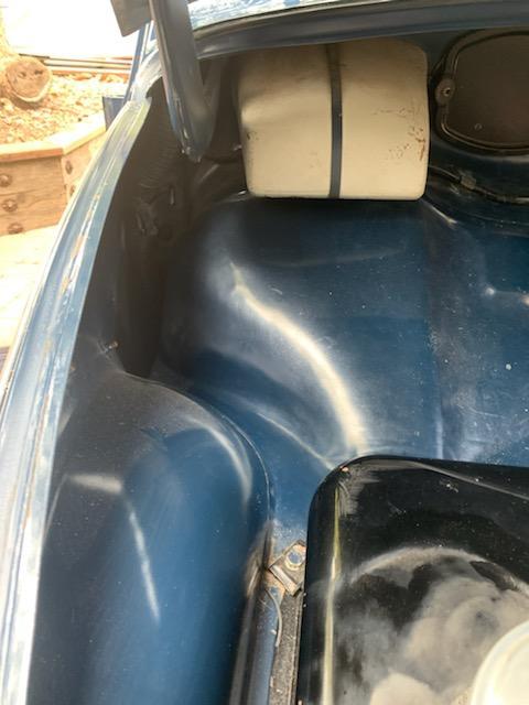

more pics...

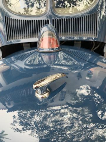

no, that is incorrect about only deluxes being imported to the USA, many standard models were also imported. Though you won't know about this car for sure without getting a birth certificate from the Volkswagen museum. IF, and thats a big if, the speedo is original to the car, that could be indicative of a USA delivery as it is MPH not KPH.
the engine may be original to the car (again can't prove without a letter of authenticity from VW museum) but almost all of the bolt on parts appear to be incorrect. If you were to chase down all the right parts, they are quite costly.
the interior parts are mostly correct, but the materials used are not. The seats and headliner appear to have been recovered in the wrong fabric. Also the carpet has been replaced with a later style kit, mats replaced, and tunnel mat having been removed. The tunnel mat is a standard only feature and sets them apart. Semaphore knob is broken and polished over, which is weird.
do you know if it has the correct split semaphores? if not, those are $$$ as well
gas tank appears to be 54-55 style
all in all, looks like a decent car to start with and enjoy, but if you're chasing correctness/authenticity then it will need some improvements.

the seller states that semaphores are original ribbed and have been serviced to work as intended. the replaced wrong inside material is news to me as it was presented by the seller as original, as was all of the engine including bolt-on parts. i knew the distributor cap was a replacement and the nut on the pulley but not much more...
i also understand that the color is wrong and was not offered in a 52. as a good starter car what price range would you put it in, 20K? 30K? or 40K? i'm seeing complete ones in pristine condition go for 50K at auctions so...

PostPosted: Tue Apr 26, 2022 12:44 pm    Post subject: Re: 52 VIN question Reply with quote
to add to what others have said:

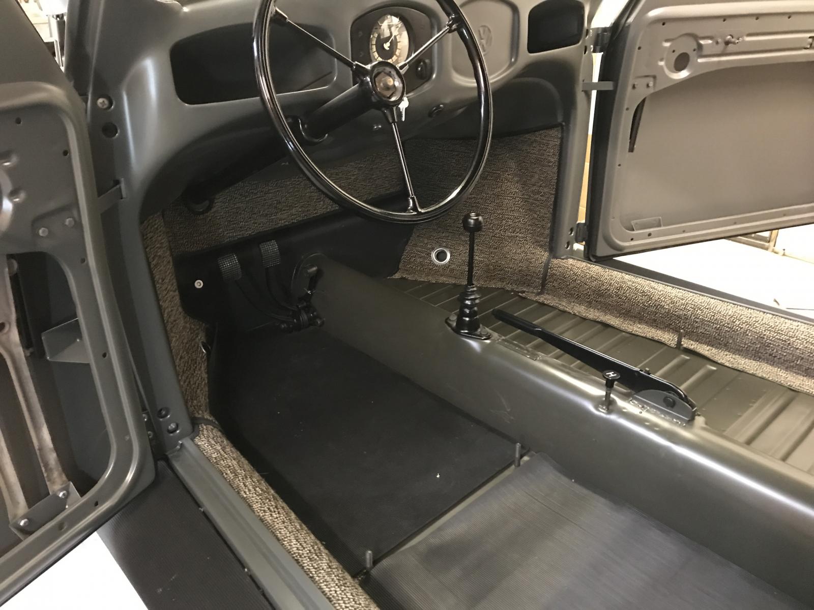

the fuel pump is a later model. this car came with the 8mm flat top seen here:
the forward vent holes on the heater channels have incorrect shaped openings. they left the factory circular instead of rectangular/oval. like this one:

PostPosted: Tue Apr 26, 2022 1:33 pm    Post subject: Re: 52 VIN question Reply with quote
No, they are the correct holes, it’s the easy to fix carpet kit that’s creating the illusion.

PostPosted: Tue Apr 26, 2022 2:20 pm    Post subject: Re: 52 VIN question Reply with quote
RUNKLE wrote:
most likely correct. i also suspect that it is the carpet, but once you are certain its been subjected to aftermarket modification it is difficult to know what has been done without inspecting it. the pic i referenced is with carpet in place to show the original factory appearance. that photo was taken from the gallery and was listed as a 1947 so its a loose reference only.
