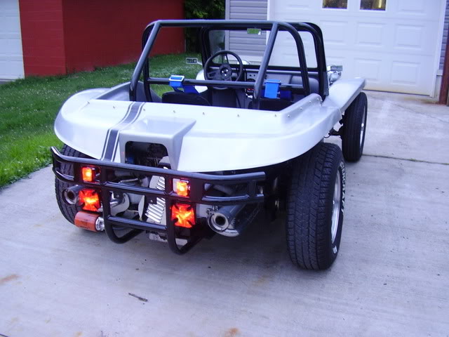

I'm running P255/60R15 on rears and it fills rear wheel/fender area really well, But am pushing buggy with estimated 100/110 HP at the wheels...
Running P225/60R14 on front's... Difference in wheel size is because that is what was on buggy when I bought it and I chose to restore wheels vs, new wheels when I restored buggy...

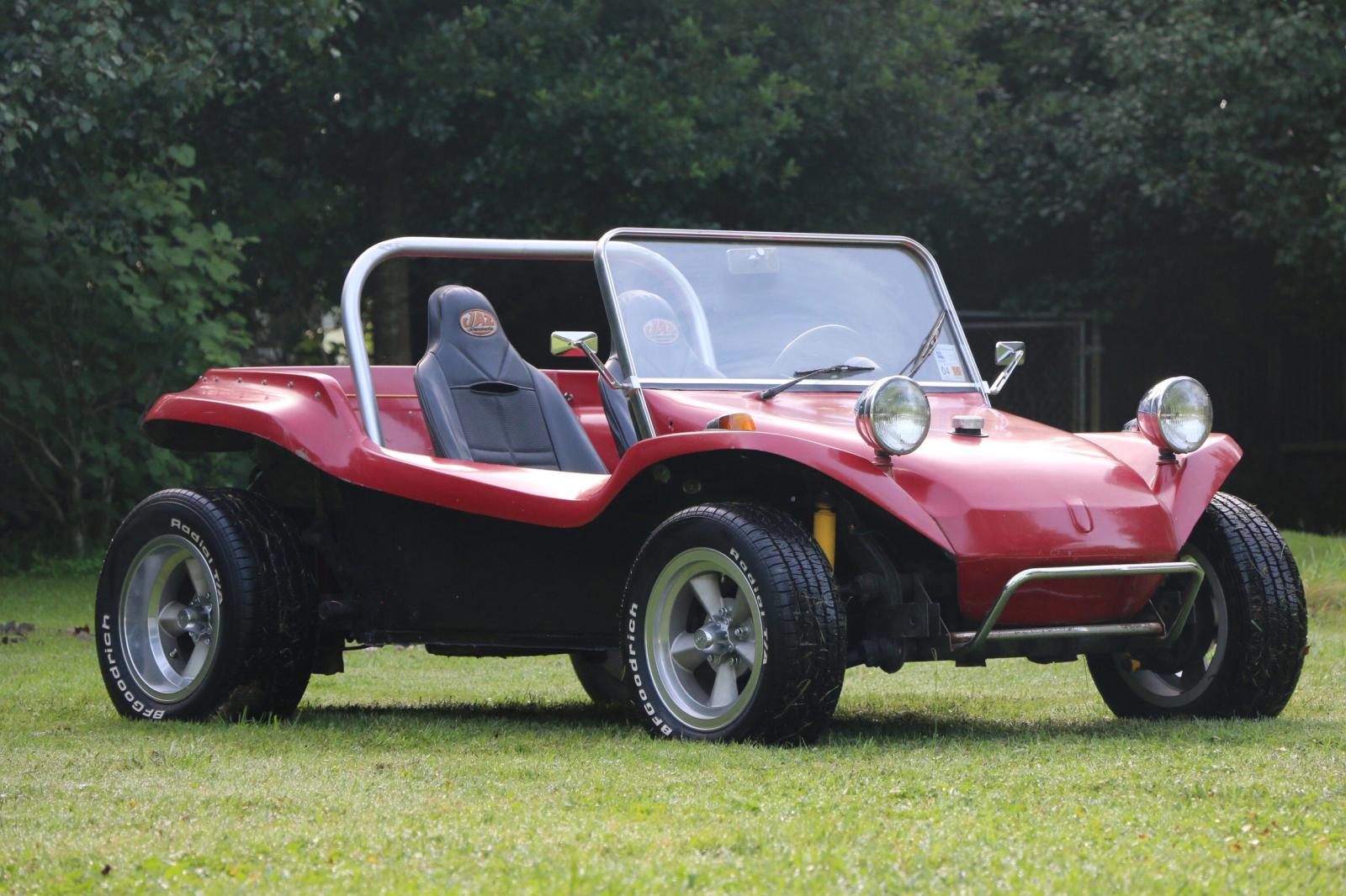

PostPosted: Fri Feb 24, 2017 10:38 am    Post subject: Re: Rear tire size Reply with quote
I use 205/60/15's front.. 275/60/15's hangin' out back.. stock single port 1600 with an IRS 4.13 R/P gear. Does run out of steam at 60.. but will go 72ish..max..
Perfect around towns and up to 55..
I wanted the look.. not the top speed... that's all I needed/wanted... for this one..
(Wanted 195's for the front.. but BFG.. stopped producing that size.. Confused )

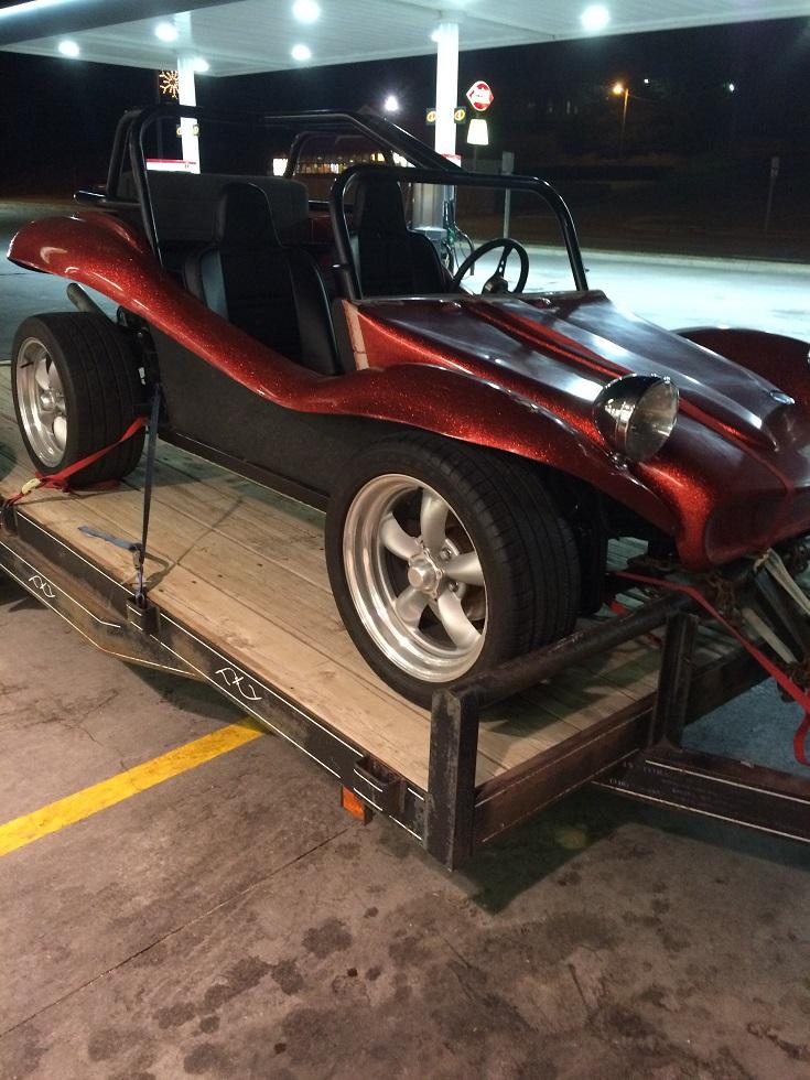

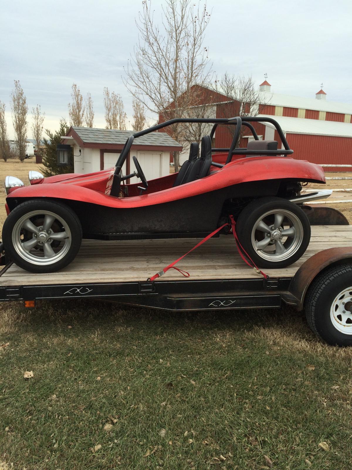

PostPosted: Fri Feb 24, 2017 11:03 am    Post subject: Re: Rear tire size Reply with quote
Front: 205/60/15 - 6" wheel. Rear: 245/60/15 - 8.5" wheel. Stock 1600 will eventually hit 80 mph. I'm going taller on the rear when I wear these out. But I may have to build a bigger engine to push them. Laughing

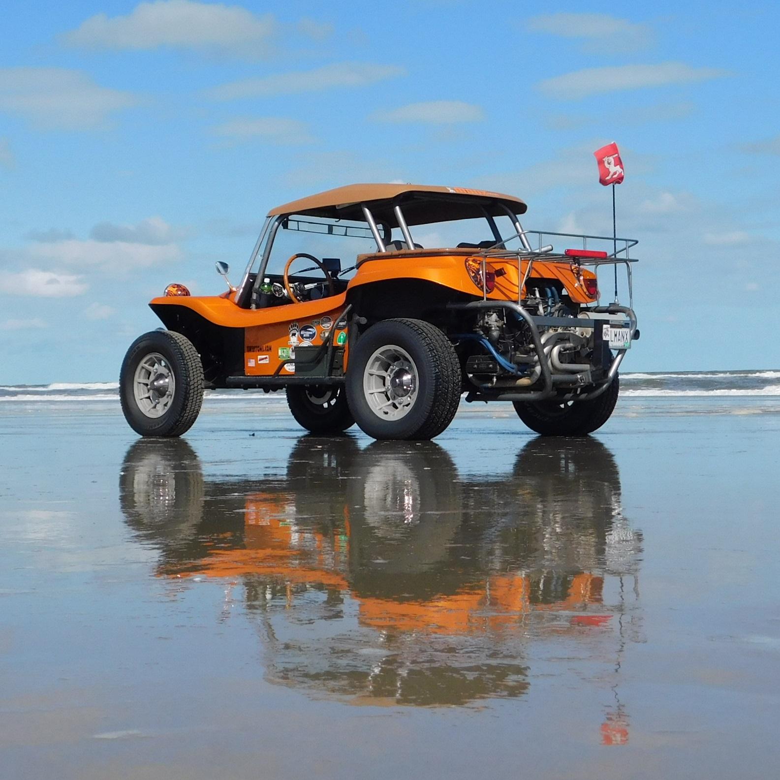

PostPosted: Fri Feb 24, 2017 12:52 pm    Post subject: Re: Rear tire size Reply with quote
I m runnng 255 Avons on the back. They fit nicely with the car and are a good compromise between meaty looks and low weight. I calculatd the dynamic weight benefit to a 275 size tyre and it would have the same effect than adding about 70 kg to the car. That is a lot.

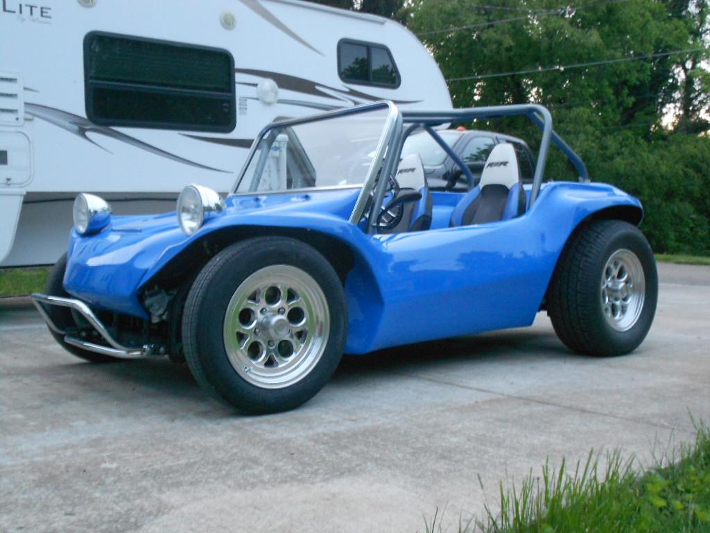

PostPosted: Sat Feb 25, 2017 10:52 am    Post subject: Re: Rear tire size Reply with quote
I run 275/60-15 TA's and love them on my turbo 1679cc.
They are 28 inches tall and give me what I think is the perfect gear ratio for my buggy. I like cruising at 3100 rpm at 70 mph.
I did run my Brother's worn out 295/50-15 TA's on the back when I first got the buggy running with a single port 1500 and Dual Kadrons. They are around 26 inches in diameter. It was pretty good but would run out of steam at around 80 mph. It would go faster but the time it took seemed like there wasn't enough road to get there...... Embarassed
I also ran the 275/60-15's on the buggy with a DP 1600 and Kadrons and it would do ok.
I just really like the gearing of the bigger tires.
With the extra power of the turbo they are perfect.

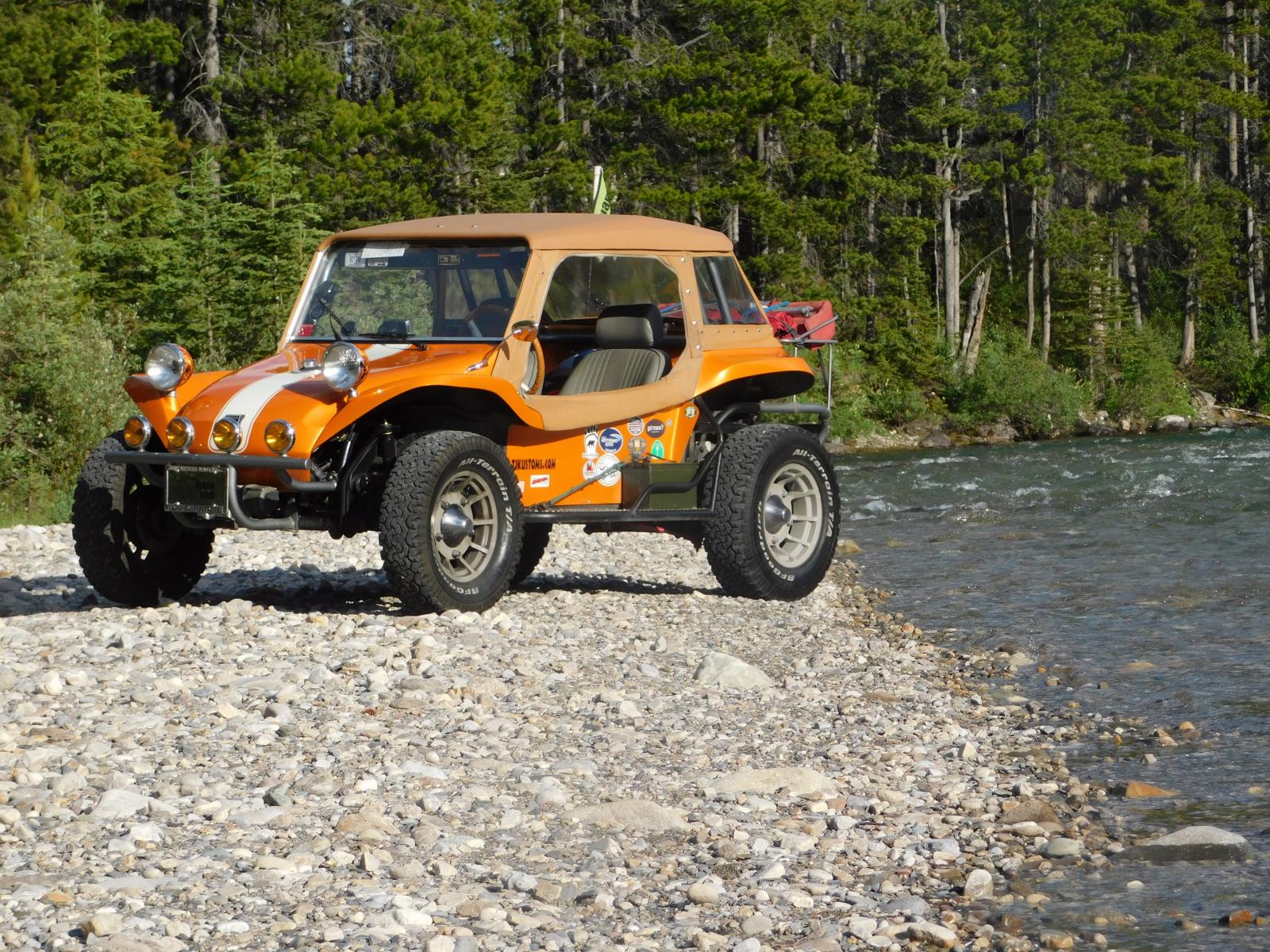

PostPosted: Sat Feb 25, 2017 11:45 am    Post subject: Re: Rear tire size Reply with quote
BF Goodrich came on this buggy.
P245/60R14 on the rear,
P195/60SR14 on the front.
The resulting gearing seems to match the 1600DP pretty well, tops out at 90mph and runs 3400rpm at 65mph.
