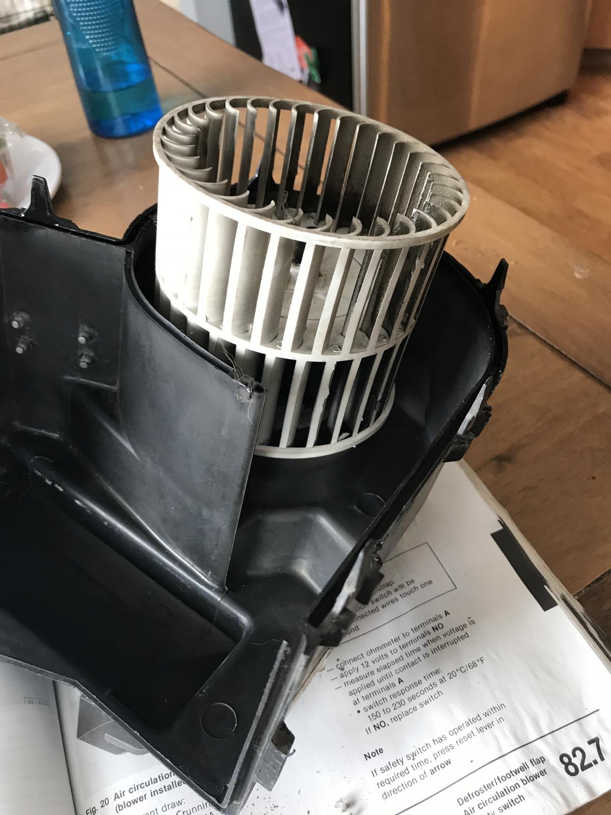

PostPosted: Sun Feb 16, 2020 9:14 am    Post subject: Re: Squeaky Rear Heater Bearing Reply with quote
A few weeks ago, before a trip to Colorado, I dropped the heater and attempted, again, to quiet the squeak. I know I used some silicone lube and I think another lube to try to get in there and quiet it down.
I also noticed that if I tweaked the meal housing a little, it seemed to help, so I gave that a shot.
It was quiet running sitting on the ground, so I put it all back together.
Well, the squeakiness quickly returned on that trip!
I am going back this coming weekend, so I'd love any other ideas on how to quiet this thing that any of you might have.
Also, now the squeak is present on high speed, too!

Ugh. Well yesterday I dropped it again and added some 3 in 1 oil. With the heater still sitting on the ground and running on low, it was nice and quiet.
But I left it running as I mounted the splash pan back up, and the ding-dang thing was starting to squeak, though (so far) quieter than before.
I'm not optimistic that it'll stay quiet for any length of time, but I guess we'll see. May start looking for a good used rear heater unit. (Squeak free!)

Are you sure the blower cage isn't rubbing on the shroud some where once you start reassembling it?. If it's quiet with no sheetmetal around it, then it should stay quiet once installed.
Again no silicone oil/spray, you want thin Turbine type oil, also known as machine oil. A Zoom plastic oil bottle with its long nozzle will last you almost a lifetime of oiling bearings, and the oil in the bottles is the right stuff for the job.
