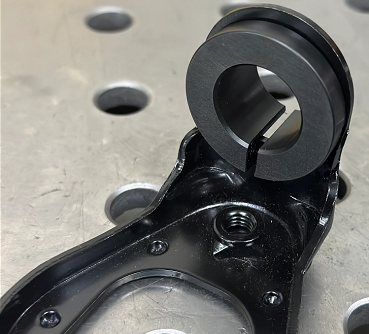

In the past some talked about using Delrin for a Shift rod bushing. Someone else had this idea and has them for sale now. Nice option, anything is better then the stock one.
https://washburns-metal.myshopify.com/products/high-quality-delrin-shift-rod-bushing

I have seen this one made in Europe, but now sold at CIP1 as well.
https://www2.cip1.com/c24-111-701-259-akit/

I wonder if it will slip on a bus shift rod that has the bend in it?

I think we talked about it a little in the thread about the metal shifter bushing. Delrin should be far better than the original polypropylene. It's tough and slick.
I think I also mentioned that properly molded nylon.....would be ideal. A long time ago, a lot of our factory shift bushings were nylon. They were tough and slick....but....they had a lifespan. After maybe 6-8 years they got the crusty, white/yellow cracking disease ....because back in those days 1960s/early 70s they were using nylon 6. Wrong nylon we know now.
So they went to polypropylene. Tough, very slick....but much less abrasion resistance than nylon and they wore out over time. But they were cheap so no big deal. And since it cannot be easily machined, the molding has to be top notch.
Then cut to 90s and 2000s cheap aftermarket. The molding started getting sloppy. Then some of them got even much cheaper and we started seeing some $2 bushings that were not even polypropylene but were soft polyethylene instead Rolling Eyes
Short life span, soft and easily distorted and wore out like mad.
So....in a perfect world.....precision molded nylon 6-6 or better would be the best and last the longest.
But second best in lifespan, abrasion resistance....and able to be precision machined.....is Delrin.
Even better but not complaining.....would be Nylatron (nylon + Molybdenum disulfide) or Delrin 500AF (Delrin +20% Teflon).
Those should be nice bushings!
because its split, I'm sure one could easily pry it open slightly as they are sliding it over the bends.
drive your split.

I have one of the soft polypropylene now and its about shot. Just ordered one of these
Thx for the heads up Jeff Very Happy

74 thing, thanks for bringing up that other shift rod bushing, that one is the 2 piece design, that relys on a constant pressure on one side. It looks like it works fine but kinda lost my interest abit. The red material looks suspiciously like urethane, but who knows. Its always good to see what everyone is coming up with.
Ray, appreciate the very complete vw/industry timeline on plastic/nylon. You never dissapoint. The $2 current offerings are frustrating. This fact is what makes me appreciate folks that sell something better so we dont have to rely on the junk out there. Would Delrin benifit from superlube or anything? Using dry kinda bugs me.
Chris, ditto what Sled said. It will work just fine.
I have one of the bronze bushings in each of my 60 bugs and works great. But the Delrin option seems like a great option too.

From the Washburns Metals part description,
Recommended to use graphite lubricants' while using this bushing for prolonged life.

The only reason aftermarket uses Delrin its easy to machine. It has horrible wear property's you can scratch it with your fingernail! Delrin can be set up and made in huge numbers on a CNC lathe with a low paid felon pushing the button.
UHMW is the best you can get but its tough to machine accurately. It Really needs to be Molded. Teflon is good but Virgin Teflon is Big $$$$$ so valuable in fact its remolded in to second hand blends. I've made tons of bushings for custom machines out of UHMW lasts a lifetime it takes an experienced Machinist its more time consuming needs to be made on a Conventional lathe. UHMW changes size with temps and machines different through the day . Its like trying to catch a snake once you have it figured out it changes direction. For our VWs just buy the molded polypropylene bushing use Synthetic wheel bearing grease replace when needed its a cheap wear item.

Disagree. Just because it scratches easy doesn't mean it has horrible wear properties. there are many flavors of delrin with different hardness
