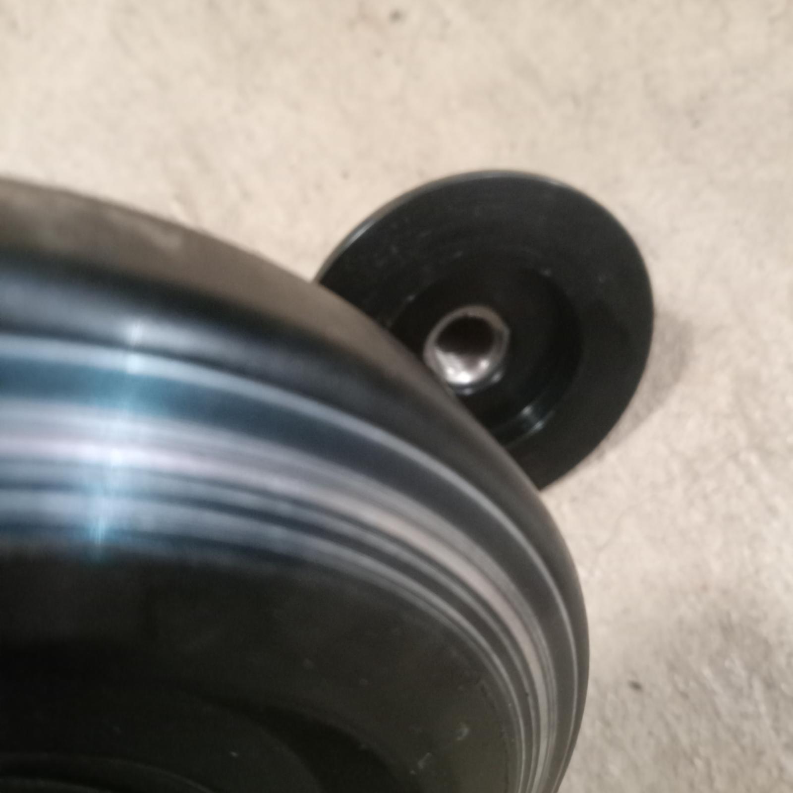

Here is something that is many times overlooked.
Crappy photos but you will get it . I use a spring clamp and clip a aluminum angle iron section and measure from belt to its edge at the crank pulley then up at the alternator, generator or in this case vacuum pump and shim from there . If you keep your belt square you will never have any issue

I like the solid gates belts and always adjust so when I have a wrench
On the alt pulley I can break it free easily and spin . Will help with wear

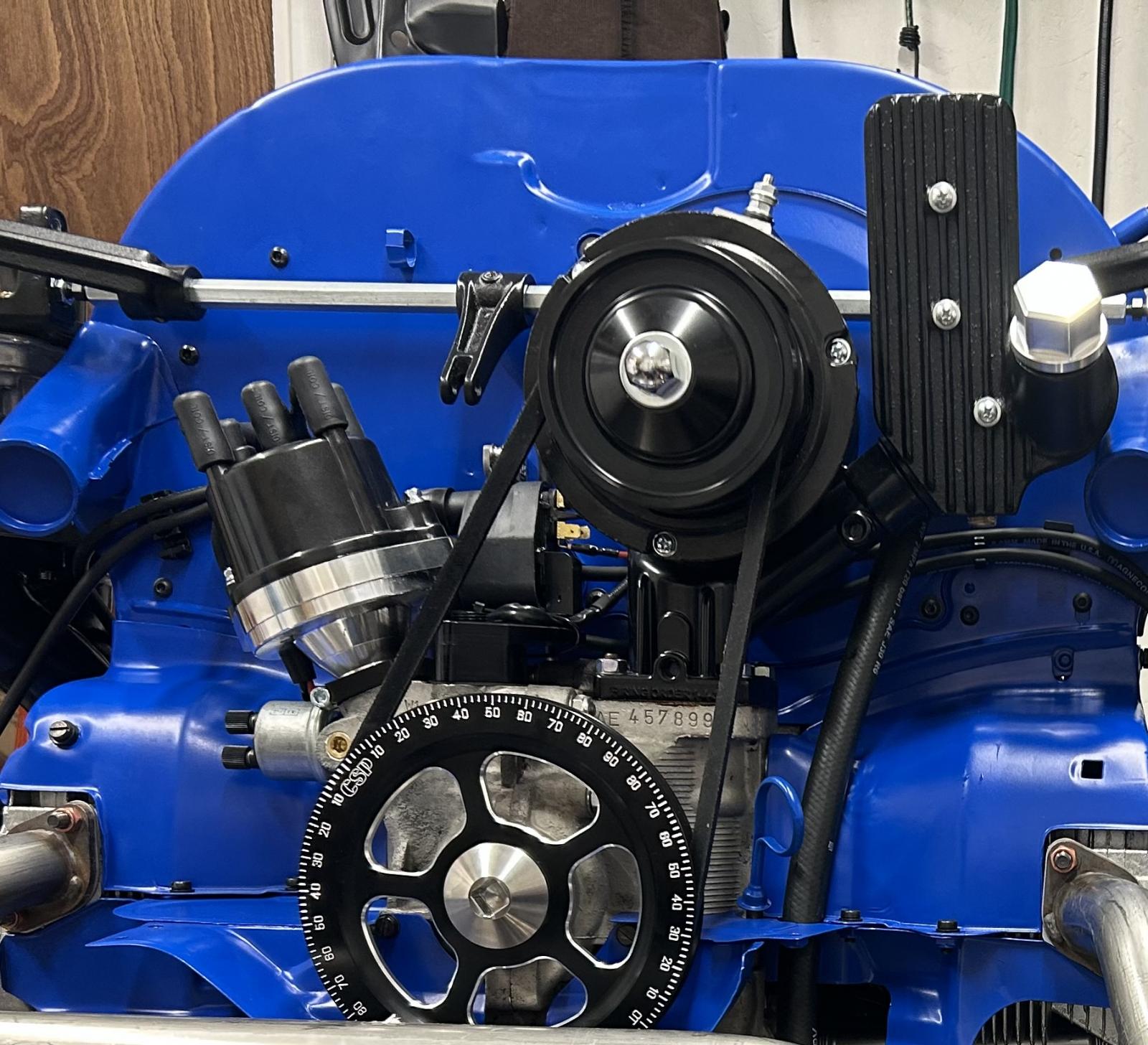

On my 1800cc build, I went with the CSP Pulley, very well made, and fitted perfectly
On my current 2007cc build, I have gone for the RossWulf kit, yet to open open it up, but looks nice as well
