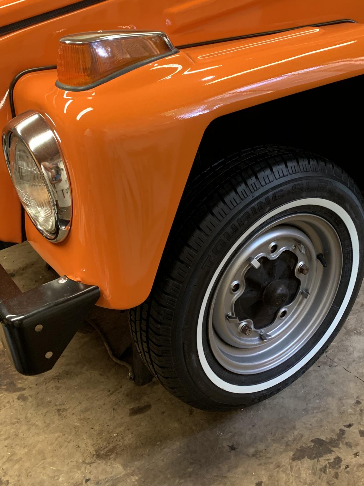

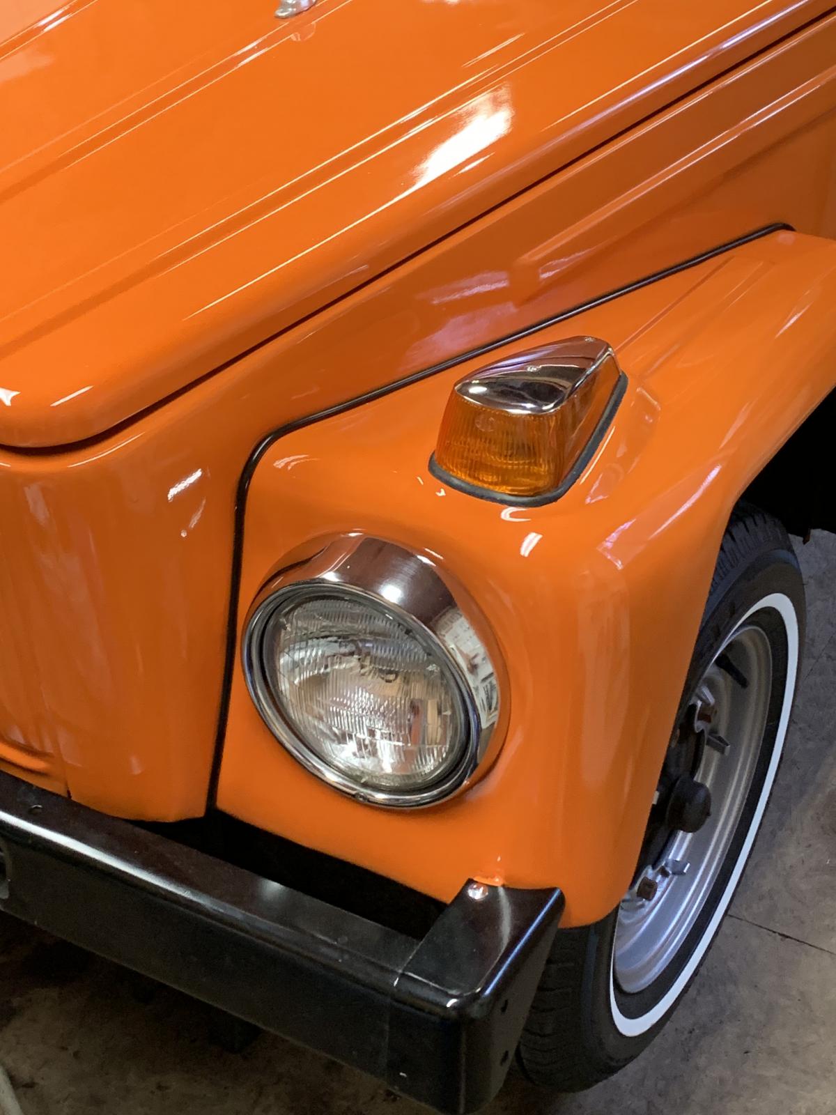

I’m a sucker for the stock thin whitewall look. It’s become increasingly hard to find decent tires in the 185-195 14 range. I finally settled on the Milestar MS775s in a 185/75r14 which can be found on eBay for around 50 bucks a piece with free shipping depending on the seller (I bought mine from simpletire) My car will primarily be used for fair weather pleasure driving, so I was more concerned with stock looks than anything else. Spare fits perfectly under the hood as expected...
My car is still on jackstands in the photos below so there’s obviously less of a fender gap when it’s back on all fours, but these pics will give you a better idea of the general aesthetics of this particular brand...
[/img]

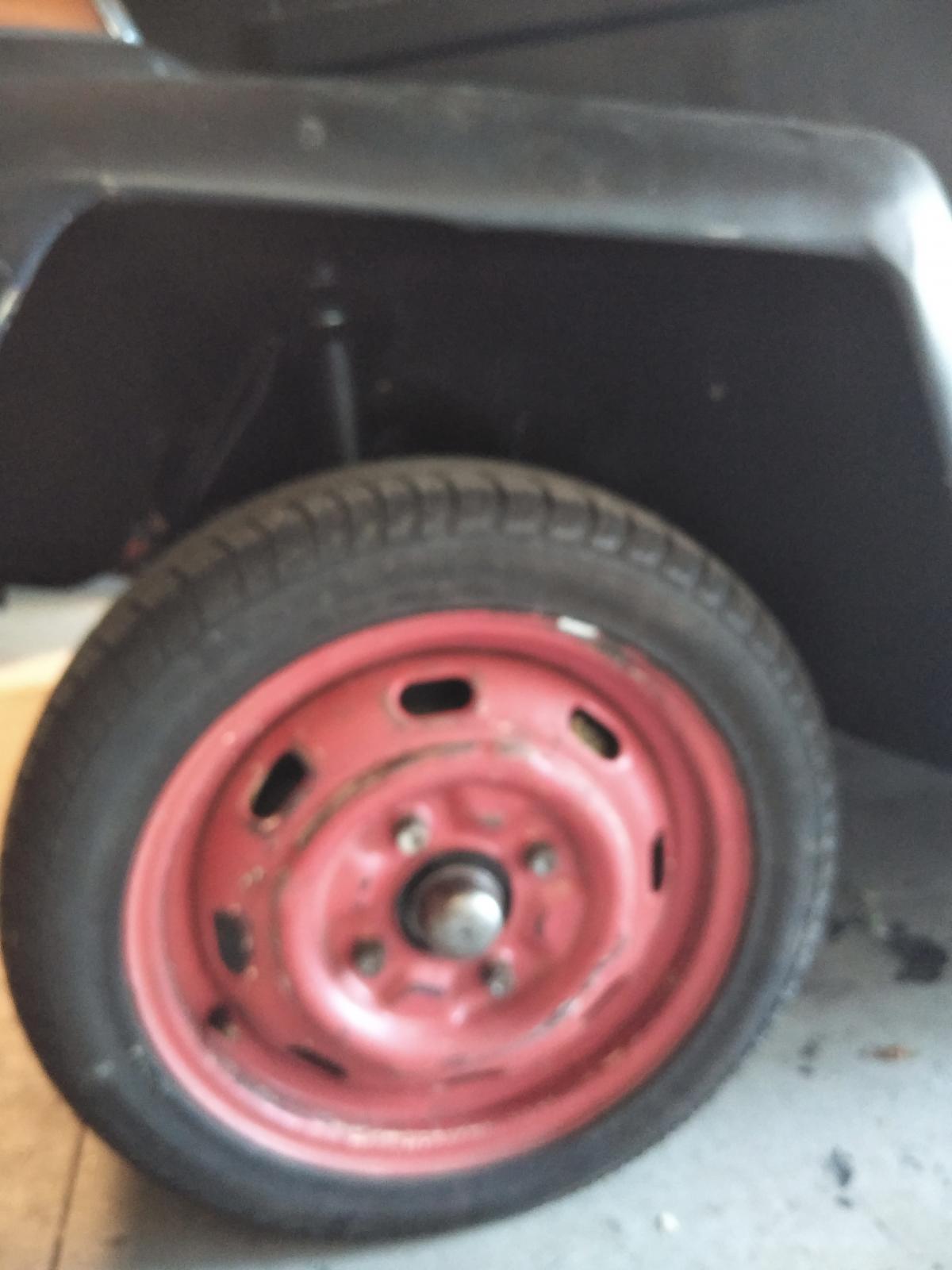

Hello all, I have these four lug 15 inch rims (beetle), on the car that was previously lowered. But now I'm going back to a standard stock Beam, (just installed 👍🏻), and I want to put a new 15-inch tire on this rim.
I think the 215 65 15 we'll fit, I think along the way in this thread somewhere I read that the geolanders look pretty good. Can anyone tell me the width on this rim. And maybe suggest the biggest meatiest tire that'll fit without rubbing on stock ride height. Thanks all happy thinging.

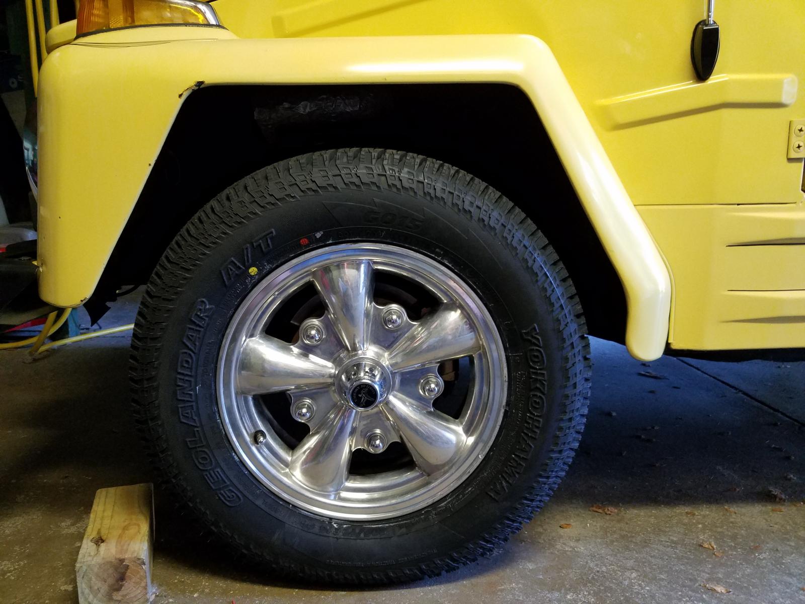

I can't tell you the width but here is the 15" Yokohoma Geolandar AT G015 205/70/15. I didn't try to go bigger in the front, but definitely could have in the back. Let me know if you need additional pix.

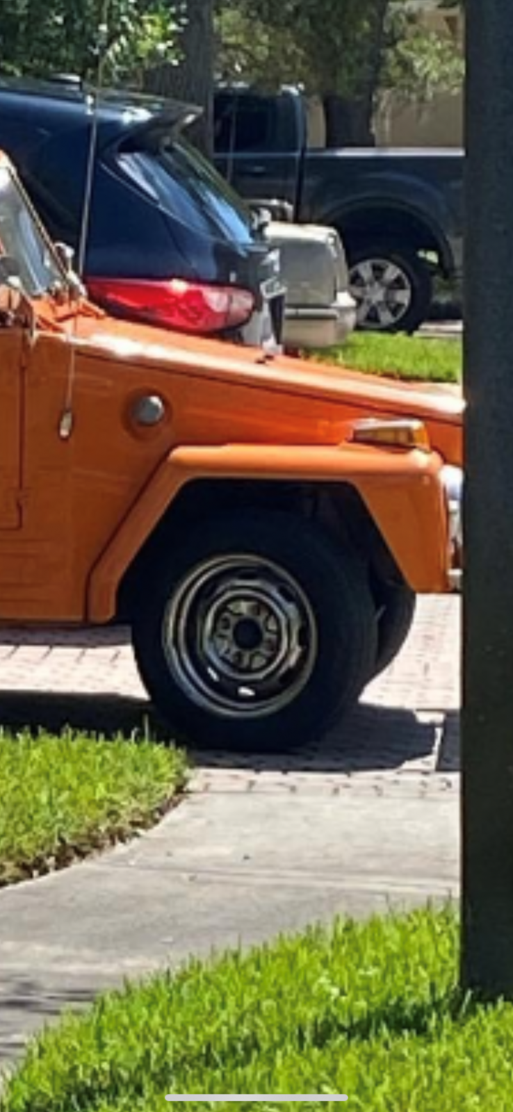

Hello all! Newbie Thing owner here. 74. Question: I noticed my 74 Thing has 4 lug wheels. Didn’t they all come stock with 5 lug? Not that it’s a huge issue but why would someone change to 4 lug from 5? Is there an advantage?
Thanks in advance.

PostPosted: Mon Sep 27, 2021 8:06 am    Post subject: Re: Wheel/Tire FAQs-Wheel/Tire questions/answers? Start here! Reply with quote
post a picture of your rims
