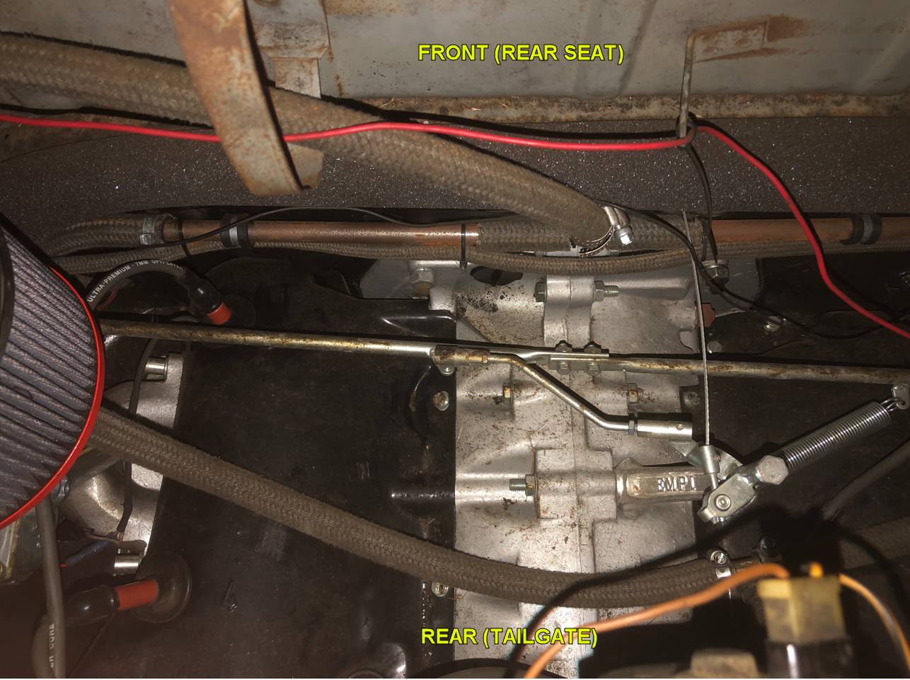

I have another question related to these carbs. Can they be installed backward? I have been watching a video on tuning the carbs and the video I saw has the throttle linkage on the frontside whereas on my setup the throttle linkage is on the backside. Does it matter?
The video I am referring to is on YT ("Kadron Solex H40/44EIS Tuning and Installation Clinic").
Cheers, Max

I forgot to include a picture with my last post.
[/img]
