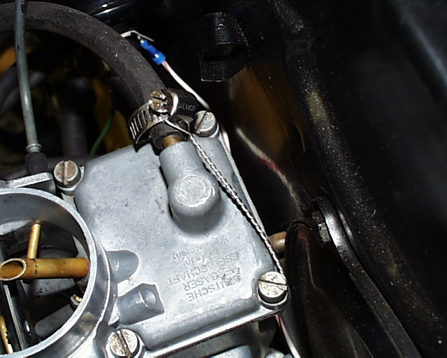

Usually from leaking fuel lines.
Second would be from the little brass nozzle on the carb coming loose. Better than the safety wire shown is a "threaded in" barb.
Third would be from butchered up wiring.

The threaded idea seems best, but probably easier for some folks than modifying carb & fuel pumps for threaded fittings, is just removal of the fittings, cleanup & re-insertion, using JB Weld to keep them secure. Haven't had any come loose yet (however, it's only been 30 years).
