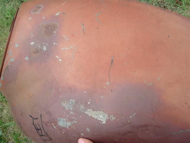

PostPosted: Mon Jul 14, 2008 7:24 pm    Post subject: Heres my passenger side fender Reply with quote
Heres why I asked about my fender, I didnt see any horn grill on this side....thanks for the info

PostPosted: Mon Jul 14, 2008 7:32 pm    Post subject: Re: Heres my passenger side fender Reply with quote
i dont think that is the right fender it has dempled headlight buckets..
what does the nut for the headlight screw look like?

PostPosted: Mon Jul 14, 2008 7:52 pm    Post subject: Reply with quote
yeah, looks later, '54 front fender headlight buckets inside should not have those sharp lines up and down like that one has, early ones had much smoother contour inside , the headlight ring hold down screw should be a "weldnut" kind of a nut made out of stamped sheet metal, the later ones had a heavier square nut instead, started sometime in '55, Personally I would be more concerned with finding a pair of good matched fenders, nice matching running board flares and matching above headlight flares, its getting practically impossible or not economically feasible to find actual "early" fenders anymore, unless its a standard get a pair of matching fenders with grilles, all VW made pre-'60 fenders are going to look pretty much the same except for the headlight bucket and weldnut, later fenders got less distinct running board flares over the years, your grill-less fender is probably a later replacement although the headlight flare looks like a pretty deep/high stamping like I like to see, if that one is not too rusty check for a metal wire tube coming out of the bottom of the headlight bucket and bolted inside the spare tire well, if its got the metal wire tube its a real VW fender and pretty early, worth keeping around

PostPosted: Mon Jul 14, 2008 9:20 pm    Post subject: Re: Heres my passenger side fender Reply with quote
valentinesr wrote:
Pre '55 fenders also don't have that hole inside the bucket. That's for the parking light wire on sealed beam units. Here's a pair of early front fenders with no horn grills
You can see the runningboard mounting flange, headlight wire tube & smooth headlight bucket. Harder to see is the welded captive nut for the headlight screw. Sorry these aren't 4-sale as they now reside on my '47 Wink

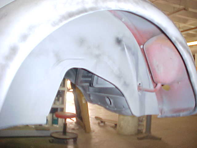

RareAir
Joined: May 11, 2002
Posts: 14577
RareAir is offline
PostPosted: Mon Jul 14, 2008 9:22 pm    Post subject: Reply with quote
Backside shot of the front fender on my '54

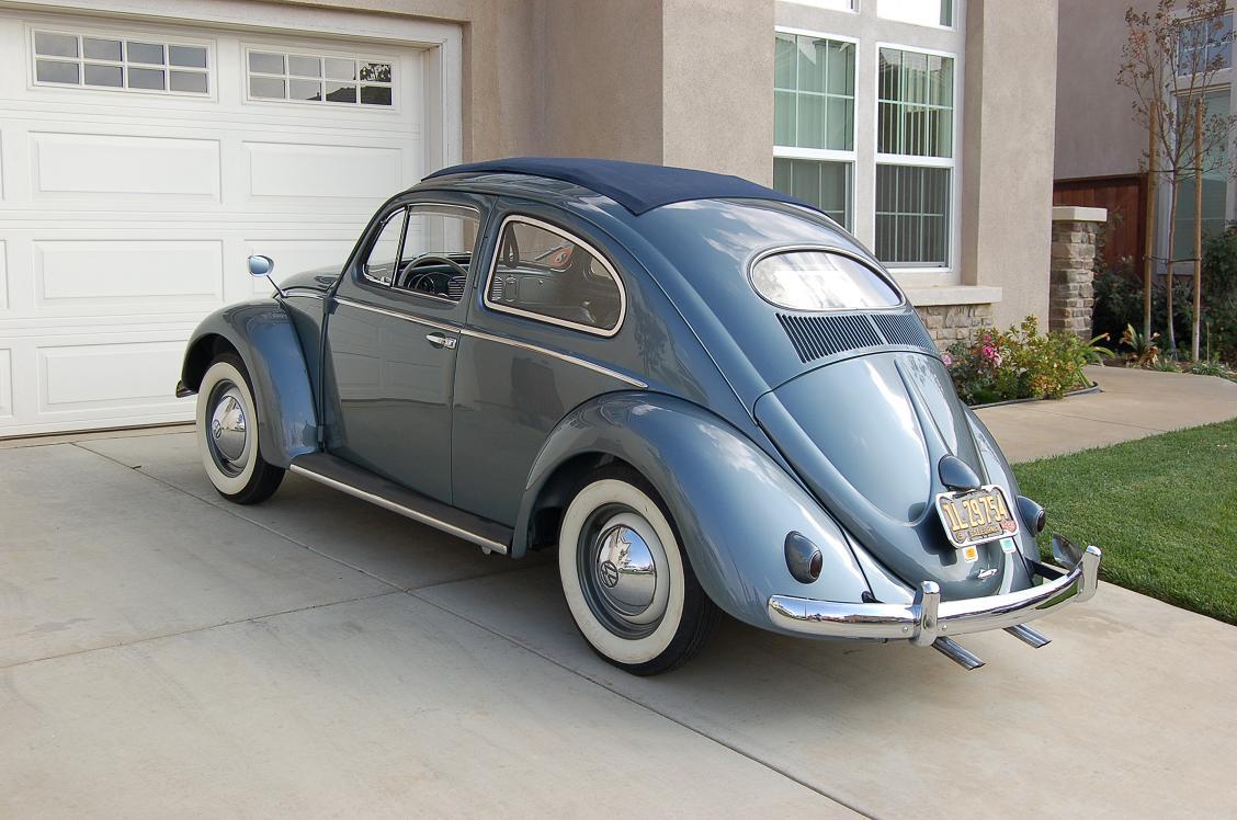

[img]https://www.thesamba.com/vw/gallery/pix/468517.jpg[/img

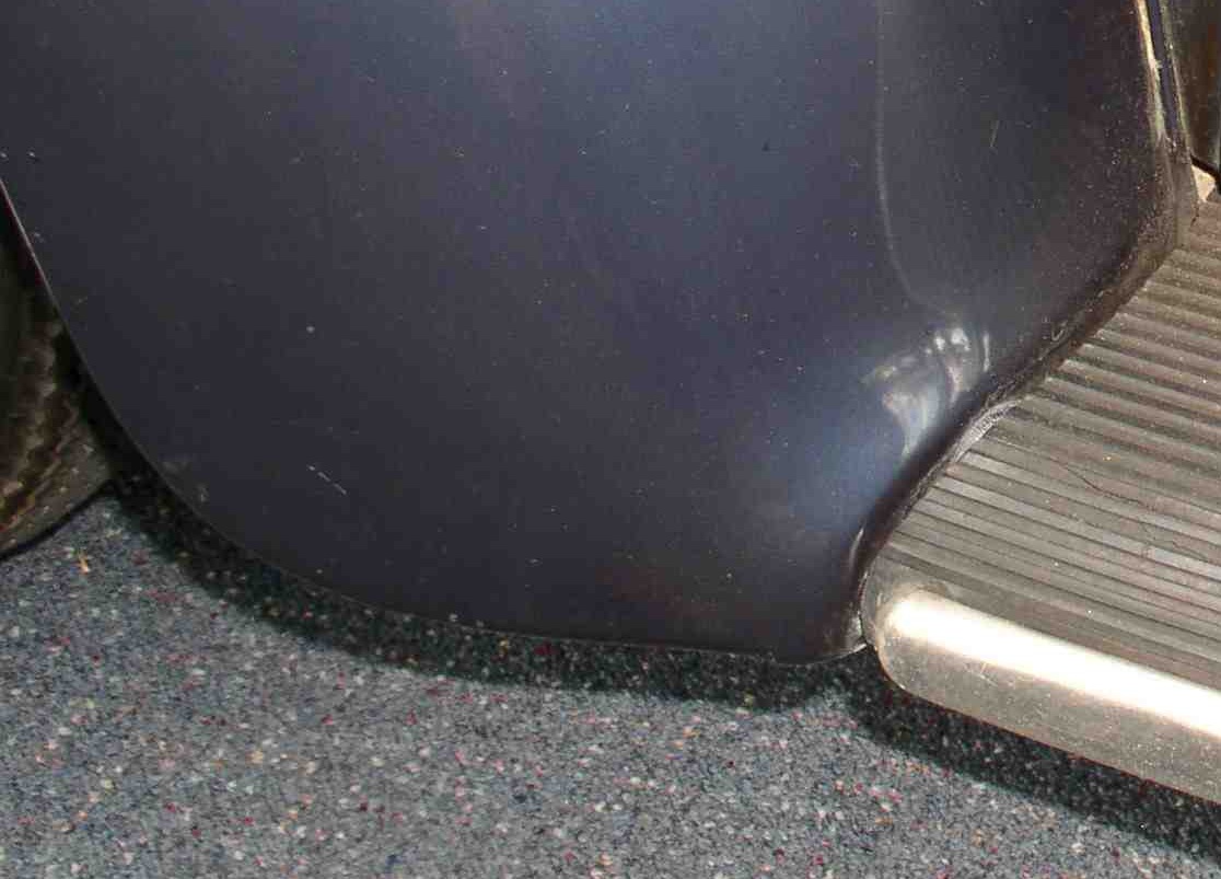

PostPosted: Wed Aug 13, 2008 8:10 pm    Post subject: Reply with quote
Okay I found this pic from Matts 53 in the Gallery..I can see the mating surface to the running board here good. I can see how there is a flare..but I dont think the photo up above in the red primered fender is as flared..so would have to agree with "RareAir" that this is to be 56-59 drivers side front..Any Comments??
Confused
