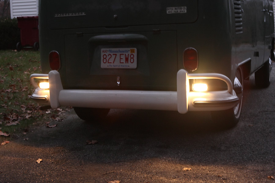

Just sharing my solution to the backup light problem for pre-'67 buses...
I decided to do the same thing my father did when he bought his 1965 11-window Sea Blue/Blue White Standard. He had a pair of dealer-installed Beetle lights on the rear bumper, as seen in this 1968 picture. If it was good enough for him, it's good enough for me. Smile
I scored a couple nice used lights off the Classifieds, and got bulbs from WW. Some have fashioned a bracket to avoid drilling the bumper. I chose to drill, it's secure, protects the wire attachments a bit better under the lip of the bumper, it's historically accurate, and it's my bus. Very Happy There's not a lot of room for mounting these lights; they're very close to the bodywork. I couldn't fit the drill in position without removing the bumper. It's a lot easier attaching things and putting in the wires if you remove the bumper, anyway. It's only attached with 4 bolts (6 if you have splash guards). I wired the lights together to get power from a single wire; I also ran a separate ground wire just to be sure.
Some pics from 3 dimensions:
For wiring, I don't have the switch that comes on the '67-on transmission nose cone, and wasn't sold on the speedometer cable switch (as some have noted, you actually have to move the bus a few feet before it kicks on), so I stuck with a manual switch. It was probably overkill, but I decided to wire it using a Bosch relay.
I had other wiring plans anyway, so I created an additional wiring harness by running 5 wires through a protective sleeve, routing under the bus using the same path as the main harness, up through separate holes into the front and engine compartment. Made some "special tools" out of wire coat hangers to pull the harness through the frame tunnels. I used wire connectors at the bumper end so I can detach the wires when I remove the bumper. Don't forget to use rubber grommets to protect the cable. I tapped power for the toggle switch off the inboard 16-amp fuse on the fuse panel, which is switched, so the backup lights will go out when the ignition is off even if you forget and leave the switch on. (The end fuse position is always live, so don't use that one)
I haven't figured out a final solution for mounting the switch, because I'm going to add fog lights too, and want to put a pair of matching switches under the left side of the dash. I haven't found a suitable switch panel, maybe will have to make something, and don't want to drill if I can avoid it; still researching what to do. I've searched but haven't seen many non-intrusive solutions by others to get ideas from.
For now, I just used a plastic rocker switch that is attached using the existing screw for the headlight switch. Not too obtrusive and works fine. I'll replace it in the spring with something better after the weather warms up and I (hopefully) have some better ideas.
Off:
On:

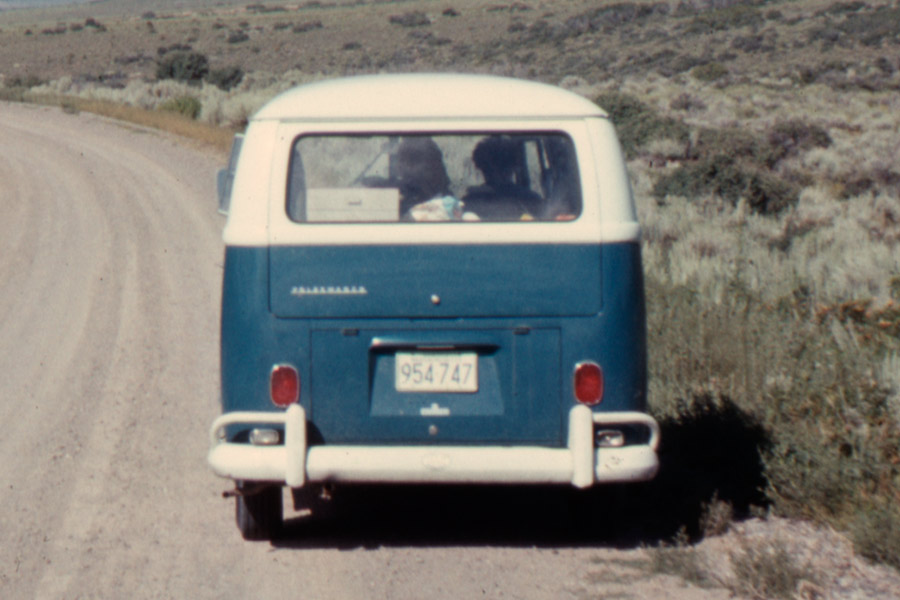

Wired into the standard taillight signals:
In Stereo, Where Available!

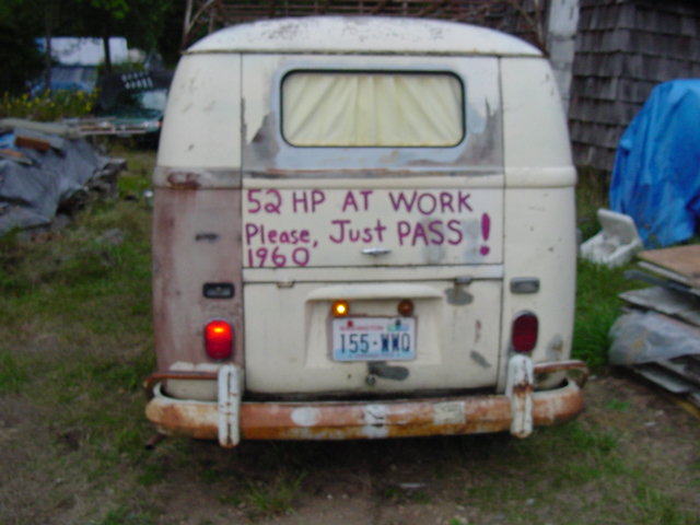

Here's mine:
I used the bolt that would normally hold the hoops in place.
