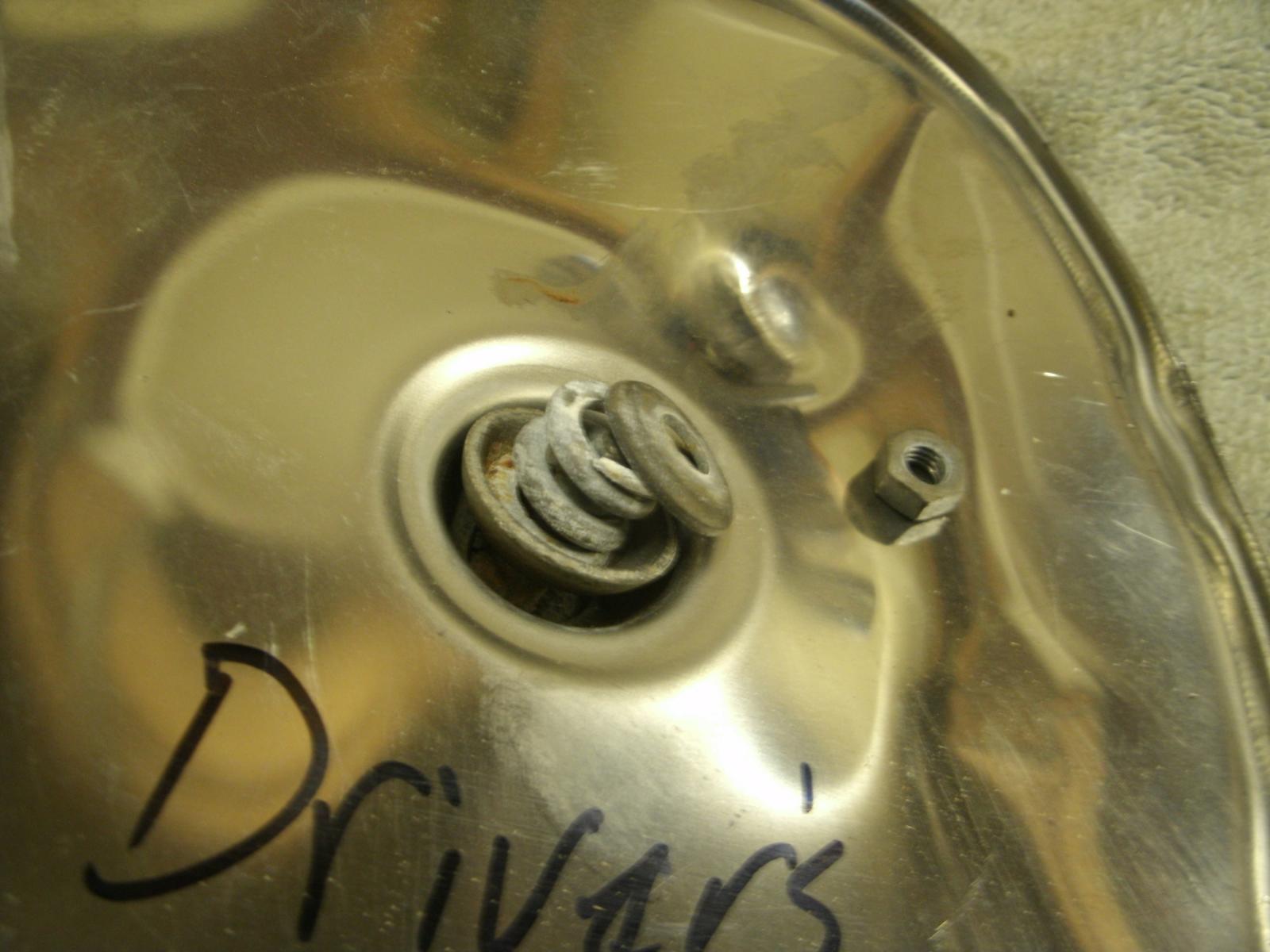

Globespotter wrote:
My mirrors are loose on the arm. How do I tighten them?
Hello,
If what rsbadura said wasn't the problem. And, we are both getting old Stephen...
If the mirror won't stay in place on the arm and you have too readjust it to see(mirror loose on arm) as I understood the issue. You will have to remove the glass from the housing and tighten the nut too increase the pressure.
Here are some pictures of whats behind the glass
You need to tighten up the ball and socket joint/connection. Ignore the drivers side note on the mirror housing(they will fit any side) it was to written in reference too the arms which are directional.

Angus II wrote:
Hello,
Thanks Angus - yes that's the problem. I wonder if pulling and turning the mirror could possibly tighten the nut without removing the glass? They are re-pops but in good shape. It just annoys my how loose they are. Not sure how easy or wise it would be to try to remove and replace the glass.

Angus II
Joined: June 01, 2016
Posts: 724
Location: Mammoth Lakes Ca. 93546
Angus II is offline
PostPosted: Sun Jan 31, 2021 11:37 am    Post subject: Re: How to install new mirrors on your baywindow bus 1968-1979 Reply with quote
Hello,
You may give that a try.
But, I should have posted more pictures....
The stud that makes up the connection is squared off at the base keeping the cupped part of the ball and socket from moving.
It's not hard to cut the outer edge of the mirrors seal/gasket. And to reinstall mirror use vinyl caulking compound not silicone(it's easier to clean up). And, if you do happen to break the glass, a glass shop can cut a piece to fit. It only cost me $4 each to have new glass cut too size.
Good luck with the project.
I'd rather fix an OEM part than buy aftermarket parts....that's just the way I am.
