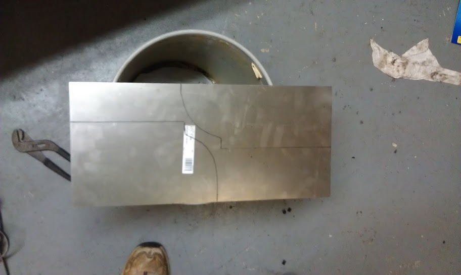

It's not hard to make your own tin so you can use the header and not sacrifice cooling.
Just get a header that clears the tins and thermostat and a set of Type 126 tins.
