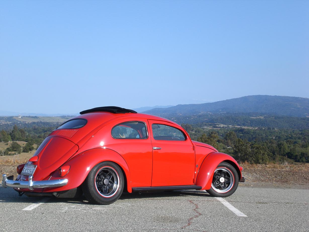

wow this sounds like its gonna end up lookin like my ride, except mines still an early beetle
only thing I can say is dont chop a super... ever, you wont be able to have a glass windshield anymore, and if you were to graft an oval and ragtop into a super it would look totally out of place
buy a 60s bug, chop it, and then graft in an oval and or ragtop section if you still feel like it

bingo... thats exactly what I did... but then the only problem is that you wont be able to see the the light turn green when your stopped at a light, Laughing so I still had to have my seats lowered 3 inches Laughing, yet I still have to open the ragtop every now and then to see the stop lights
and then ultimate tip when chopping a car... buy one already chopped. I picked mine up for 200 bux right here off the samba

If you are going to be cutten, welding and fabricating, don't let a little thing like the curved glass stop you! You could always graft on the front window clip from what ever car you get the rag clip from.
Make that curved glass flat.
