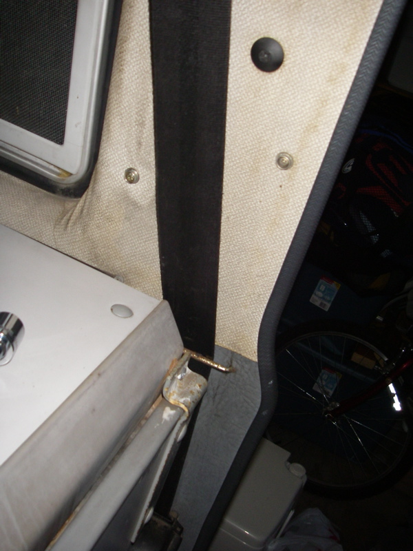

First thing that I wanted to change in my new (old) van were the seat belts (previous owner mentioned that one of the rear ones didn't click well, and the front ones were somewhat difficult to slide). Next in my list are the fuel lines.
I got my new set from GoWesty and replaced today the two rear ones and the front passenger . Unlike the passenger seat, the driver's belt goes through a "guide" (see pics below) that doesn't seem to have a direct way to dismantle, should the cabinet and side trimming need to be taken out ?
This is an 87 Syncro Westy, but I'm not sure if this extra "guide" is standard equipment or something that a previous owner added.
Any tips/pointers will be appreciated (and yes, I know I have a lot of cleaning and sanding to do in the inside, outside and between)

I just replaced my seat belt with a GoWesty too. I have a late 90 Westy with the same metal guide. In my case the guide has a small screw on each end that hold it in place. It was a little bit of troble getting to work around this. I didn't need to disassemble the cabinet although I ended up taking out the sink/stove cabinet lid. If you get somebody to help you hold the guide in place you won't need to take out the cabinet lid.
To replace the body of the belt you'll have to empty the cabinet under the sink and the divider shelf and work from inside the cabinet.

Thanks ! It was dark when I started tackling the driver's belt, and didn't notice the small screws, will check again tomorrow.
