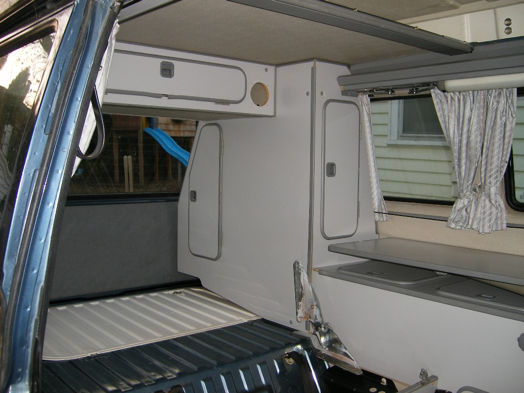

Factory 89 Westy with no AC. Not Canadian or import. I knew I should have saved that cabinet!

Thanks for the advice and the breakdowns. Best condition within my budget seems to be the consensus with the specific year being personal preference. The no body rust, cabinet differences, and bumper comments are especially helpful.
I have heard that the engines will almost always need replacement or significant rebuilds with heads needing help almost without exception. Should I expect to have to do this if it hasn't been done already?
Since I'm a newbie - does the a/c unit take up all the space of that cabinet in the rear ceiling?

Agree, especially the part about rust, avoid it like the plague, two spots are common, left panel behind the stove/sink unit and right panel behind rear hatch window washer bottle (right back panel). Look for rust in outside seams and where panel meets the undercarriage
archicarp wrote:
I have heard that the engines will almost always need replacement or significant rebuilds with heads needing help almost without exception. Should I expect to have to do this if it hasn't been done already?.
Yes, these are high mile engines. Ask for shop records and receipts, see when and who did work, if any, on the engine/heads. If done properly you might not need to do anything.
Yes, and some room in the engine bay.

Yeap the AC takes up all the overhead space. Hard to know what kind of engine work to expect, you can't believe what most seller tell you. I personally like to look for a vehicle with easily discernible engine or transmission problems and get a big discount on the price.

I have an 89 Westy with no AC.. and it never had it.
Delivered new to Wyoming, then sold to a guy in San Diego, then to a guy in San Rafeal. Now me, in SF.
There were three days among the last 6 yrs when I REALLY wished it had AC.

I have an 89 GL Westy with no AC.. and it never had it. No holes in the deck where the hoses run in the back along the pillar.. no marks where the evaporator would have been, no hardware marks where the compressor would be, no evidence of the hoses under body
