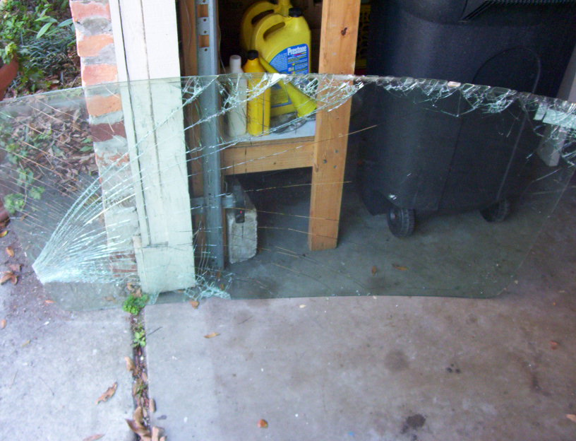

I understand that the removal of the glass can be accomplished either by simply pushing out along the edges, or by using a flat head screwdriver or similar implement along the inner edge of the seal.
I'd rather not break the old windshield if I can avoid it, just because ... I mean, what if they show up with the wrong glass tomorrow or something?

Take an exacto knife and cut the seal. The windshield will just pop out after that with little resistance.

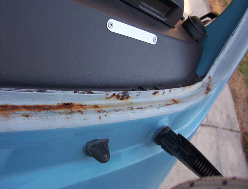

Here's what I found:

Ok, so after attacking the rust with a wire wheel, I did find one small hole (maybe 2X4 mm) Could I just use por15 + filler?

I am going to be the un popular one here. rust will not go away with ANY chemical. It needs to be cut out and replaced.
Grinding it and priming it is a waste of time. While products like POR 15 and such are good at keeping rust at bay. it just sends it back the other way.
If you are going to attempt to fix such a problem,I suggest getting the product you are going to use and read the direction Carefully before doing the work. Most of these wonder chemicals require time to out gas before top coating .And almost all of them require a top coat as they are neither UV tolerant and are porous .
When replacing your glass, In my opinion the only seal worth using is a dealer seal (from Vw) not "made in Germany" this is way more important than an OE glass. Make sure that the installer seals the glass between the rubber and the glass especially at the bottom and half way up the sides. Before installing the seal, the glass should be prepped with the same Glass primer they would use for a glue in installation,so that the adhesive has something to bite to.
So write off what I say or bypass some steps as unnecessary and you will be visiting this again sooner than you wish.
I have been in the glass trade for 20 plus years,and have lived through the experience of having a rusty Pinchweld on a car.It did not go away ,the rust that is. I sold the car and now it is someone else' worry.
Feel free to contact me in regards to any of this. I don't think I am right I know I am.

Here's what's under the filler and rust:
Doesn't look all that great to me.
I'm thinking about applying fiberglass and por15 over the corners, a coat of por along the entire thing, and then filler and primer.
Stacy: POR is supposed to be top-coated *before* it's completely dry so the paint will adhere properly. In this instance, at least, it isn't necessary to wait.

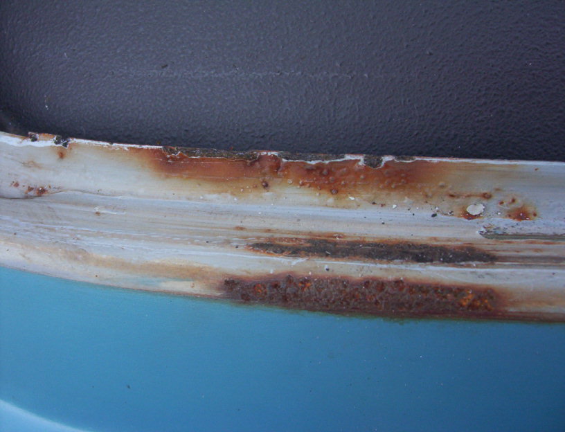

Look at this mess:
I actually paid money for that!
I'm thinking about printing these pictures and taking them to the owner of the shop . . .
Anyway, what do you guys think about por15 and fiberglass (soaked in por) patches and then filler? At least I can do that myself, and I figure it would be a lot better than just filling this up with bondo (again).

Mmm.... first thing first.
It's not that bad. Far from it, most van have rust there but a lot don't even know it.
Money VS labour. Of course, the right way is doing that is:
But forget that, It's a painful job, it's time consuming and you may need a welding machine.
So, you have time and it look like you can do it yourself, of course you can!!!
So, pour Zinc over there, let it dry 1 big day.
After, put some Micro fiber. It's resin with micro Fiberglas in it. Don't put to much, micro fiber look like that:
Putty (GOOD BRAND!!!, use Evercoat with hardener):
Sand everything smoothly, test fit window with old seal.
Conclusion:
You are here for advice mostly because you don't have money to have it done by pro's. You know what, good for you. That whole project won't cost you much, you will learn a lot and men!! if it's back in a few years... do it again.
Of course, new metal is the way to go, but over there, it's hard to put new metal, unless you have a donor van. It's one of the worse place to do nice body work.
Body work = labour of love and patience! Don't rush it.
