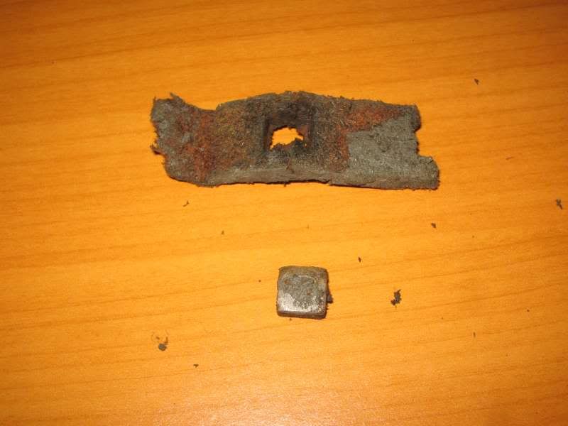

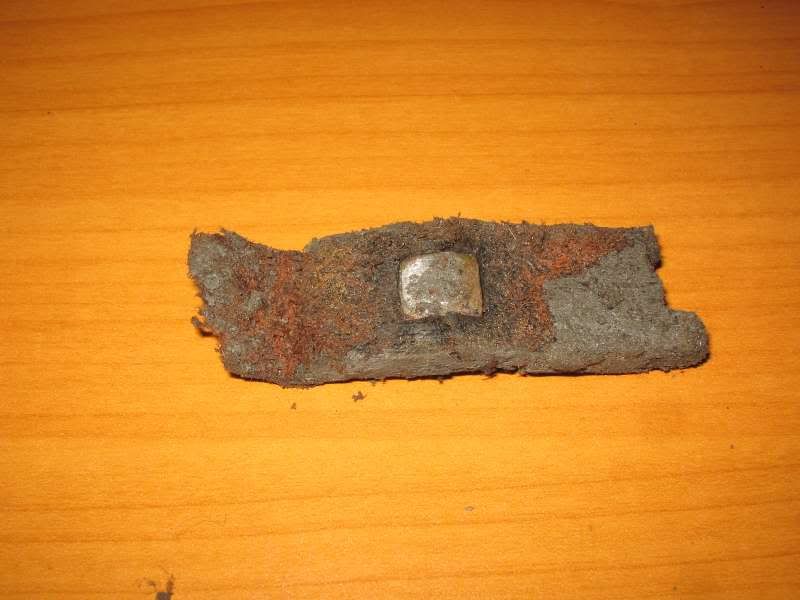

PostPosted: Sun Sep 06, 2009 10:49 am    Post subject: Reply with quote
could you tell me what this is ? ; closed my sunroof 15min ago and this fell out ? , its the second time this happens

Stanw3
Joined: September 26, 2003
Posts: 1077
Location: Albuquerque, NM
Stanw3 is offline
PostPosted: Sun Sep 06, 2009 1:10 pm    Post subject: Reply with quote
I don't recognize that. Looks like some padding - not sure about the square in the center. Neither were in my sunroof.

Vermeulen
Joined: October 30, 2005
Posts: 250
Location: Belgium
Vermeulen is offline
PostPosted: Sun Sep 06, 2009 1:12 pm    Post subject: Reply with quote
the square thing is metal and looks like there is a broken screw in it .
it's a 66 sunroof standard bus , will do some inspection on the bus itself next week .
