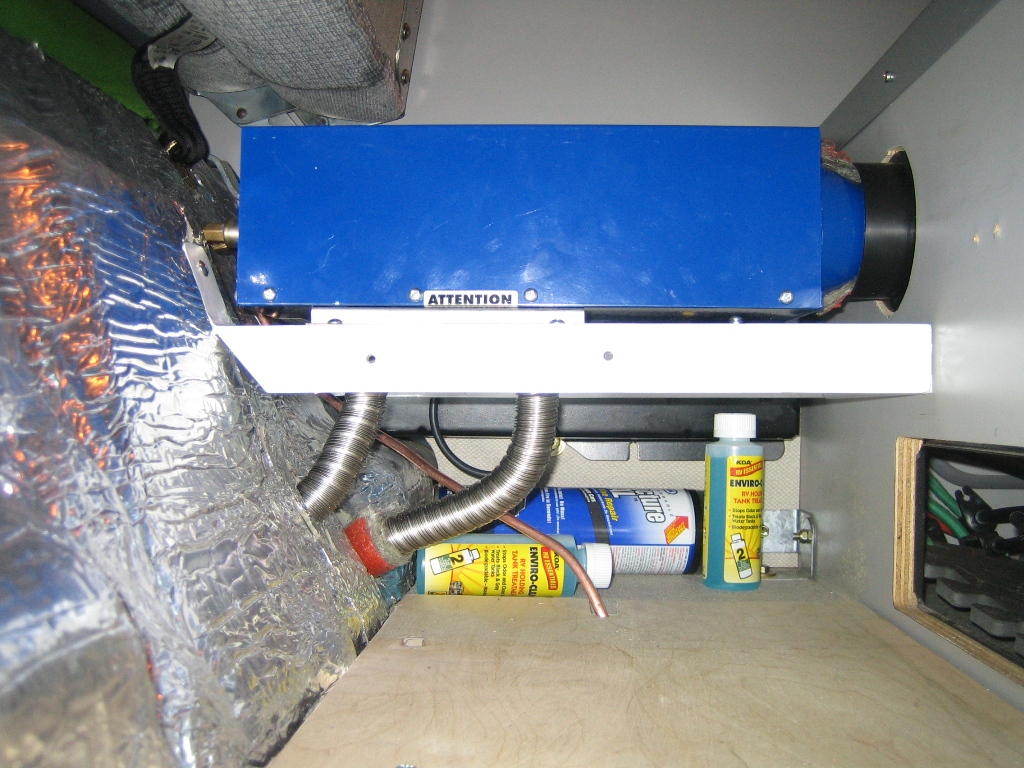

I put mine under the rear seat facing fore and aft. It gave me some room underneath to store some stuff. Not pictured is a guard that keeps stuff away from the exhaust/intake/propane line and I did remove the factory heater. Very happy with the space savings.
Simple angle iron bracket
Mounted about a 3/4" below bottom of seat
That heater makes winter trips very comfortable.
Steve

SSWesty, that's a nice install. I like that the vent goes straight out to the cabin and not through a bunch of funky ducting.
