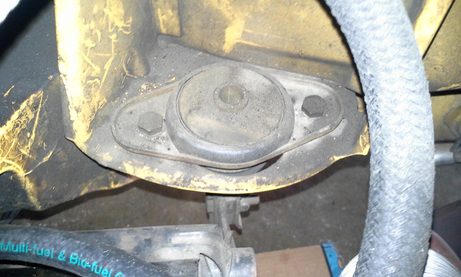

This car has always had a vibration even with a rebuilt engine and auto trans both I rebuilt. The engine running I don't see it shaking and this vibration has been there since I got this car in 85.
It only does it with the auto trans in drive with my foot on the brake. As soon as it take my foot off the brake it stops. Mainly I can hear it and feel it in the right door window and also the door itself even though the door closes fully and the weather strip is in good shape. If I press on the door it continues the only way to stop the rattle is press on the lower end of the glass inside and of course the lower seal is hard . The glass fits well in the felt channel.
Even before I changed all the FI seals and all else it didn't change plus it starts out on the right side yet after I drive about 30 minutes the left side glass and door vibrates to the point I can see the entire left door vibrate mostly by the vent window yet it's all tight and the door shuts snug and the weather strip is good.
Point is lately it's worse. I know there are 5 sub frame mounts yet they are there and not cracked or loose.
I look at the rear engine hanger mounts and they have cracks and look a bit flattened . I got a set of good used ones that look much better years ago as well as a front auto trans mount.
I don't expect an answer since I can only express this in words.
I thought of just changing the rear mounts and wondered if it's possible they might be the cause since it's been getting worse. I brough this up to Jim Adney , he said he has a calif car and it does the same thing don't know what year it is . he brought up the sub frame mounts and how calif cars rubber dies and become hard and cracks.
I stuck card board between the right glass and the inner wiper and it stops the rattle that drives me nuts, can't hear the engine over it . The left side the wiper in and out no longer have the lip so the glass does not make noise yet I still hear it. I haven't changed the mounts since they look like a job the right not so much the left has the MPS right near it.
I don't care about the glass wipers it's the insane noise.
Any suggestions ? I would change the front trans mount yet you can't get it out without shifting the drive train back at least an inch or more. I thought of removing the 4 rear hanger bolts and hang the engine bar with S hooks to the old mounts then support the trans and see if I can force the drive train back just enough to get the trans mount out . I don't want to pull the entire drive train . I would need to free the heater tubes to the ex changers . The auto trans mount is not broken so I don't feel it's the cause.
There was only one time I recall it not vibrating and it was years ago with the original engine and muffler and it was a damp rainy day . It's been real humid here all summer and that does not help.

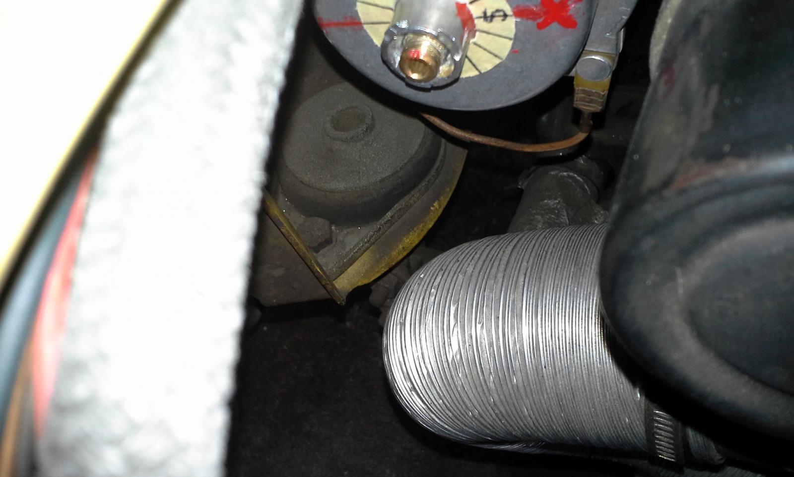

I bent the channel felt a bit can't rattle the glass now.
I took photo's of the mounts in the car compared to the newer ones .
Here is the right then the left and then the new ones . I jacking up the right side at the hanger and the top washer just came up from the rubber where it is sunk in in the photo.

So where in the world did you get new rear mounts from?

PostPosted: Fri Oct 04, 2019 4:11 pm    Post subject: Re: 73 rear engine mounts/ vibration? Reply with quote
I'll look. I got them from some place in IL back in the 2005.

PostPosted: Sat Oct 05, 2019 8:52 am    Post subject: Re: 73 rear engine mounts/ vibration? Reply with quote
blues90 wrote:
There has to be a solution to at least stop this. I can't imagine when new these cars did this.
Have you tried putting the shifter into "N"? That works in my wife's car. But then like Tram said, it's a common thing with the AT, because of the load against the torque convertor. See that's what's causing the vibration. Car stopped, in gear, foot on the brake. The drive train is ready to go, all slop is removed from the moving parts. Bump it into "N", and you put the slack back into the moving parts. Try it.
As for when new, none of this made any noise. All of the bushings were nice and tight fitting, all of the door seals were soft and supple, the window felts fit tight to the glass, the foam inside the door card was still soft and present, the vapor barrier was uncompromised, there was no 40+ year old slack in the window regulator(s). None of this was present in a new car. Now, a 40+ year old car, any and all of it is present, unless the doors have been totally rebuilt, and the engine mounts have been replaced with new parts (modified Porsche parts, or NOS parts). Just something to think about. Age related stuff going bad. I'm sure you can relate to that, as you're no longer 18 or even 21, hell you're not even 40 anymore. Wink

Bob , yes I often place the shifter in neutral if I'm sitting long enough, not only because the rattle drives me nuts driving short trips sitting doesn't do much for charging the battery. Yet with old parts shifter and cable included, at times I think how many times can I do this before the cable decides to give up. I keep a spare from the 72 in the car. Had the fitting that holds the cable to the trans arm come loose once and no tools in the car. I put blocks at the tire e brake on and got under there and put it in drive so I could get home.
I might try the mounts I got , they were not new yet certainly look a lot better than what's riding around back there. They came from a place in IL that I found doing a search early 2000's so the car probably turned to rust long ago . They just happened to have a few left. I also though that that old original oil fill rubber tube can also transmit vibrations at least the air bellows is still pliable.
I hear ya next month I'll be 24 years older than this car could use a few replacement parts.
I hear ya on the human replacement parts. Laughing
As far as wearing out the shifter cable, I doubt you'll ever wear it out in your life time. You're only moving it maybe an inch, and it's not being constantly moved like a throttle cable. If it were, then maybe I'd worry about it. It is a 3/16ths piece of cable after all, so that'll take a while of rubbing to war out.
I'd go a head and put the new hanger mounts in. At this point you don't have anything to loose.
Your right I've nothing to lose replacing the mounts while I'm at it I will replace those aluminum fan to heat Ex changer tubes I have the ones from air craft spruce since 2010 still sitting. I keep a new throttle cable with me too. I had the original snap right at the pedal long ago and used to one from the 72 . What I found odd was the one in my 73 was a single wire not a stranded cable I remember it because I was concerned the 72 might not fit , it must have been another late model save a buck deal. I have heater cables and wasn't sure I had a throttle so I was looked for a single and found all had no threaded end then saw the stranded one. It's just not one of those things I feel like replacing on the side of the road here , mine broken in the garage right as I was backing out of my garage so I was lucky. This time I will grease the cable. Now it seems I have a few days work just to do these few things. If I had another mode of transport it would not be such an issue.

PostPosted: Sat Oct 05, 2019 10:51 am    Post subject: Re: 73 rear engine mounts/ vibration? Reply with quote
blues90 wrote:
Bobnotch wrote:
In looking at your old mounts there is an additional good argument for replacing now even if it doesn't cure the vibration, and that is that I have seen these sag SO badly that the air intake boot gets stretched and distended, which ain't the best idea. Wink

Well I got them in with assorted sockets , used a 1/4" drive snap on flex handle and 13mm socket so I could reach the top bolts. I was able to loosen the bottom mount nuts without the other 1/4" ratchet yet needed it to get the self locking nuts off. Did the right side first since it is easier then the left . I marked the engine center line before just used the engine lid lip opening 30" and a small plumb bob and it was close 1/8" off to the left I tried to move it 1/8" back over to the right yet it would not stay maybe because the mounts were not new and had a set from the car they came out of. I noticed once the mounts were in when I torqued the nuts on the carrier the mounts actually flexed a bit as did the carrier same on both sides. It never did that before. The old mounts were stiff. Not getting my hopes up that this cures the vibration.
Since it raised the engine close to an inch and the oil fill tube rubber is sort of stiff it has the bellows deal should I have maybe loosened it and tried to adjust it? I noticed before I could flex the metal tube on the engine a bit it still feels about the same , last thing I need is it breaking. I plan on getting a replacement rubber tube.
Once I got the replacements in right first I jacked up the carrier higher set the mount in and placed the top bolts in then the 2 carrier bolts so I could slide the bolts through the mount and carrier then put on all the nuts/washers I just snugged the 2 carrier nuts then moved to the left side and removed the old and did the same. right away when I jacked up the center of the carrier both mounts moved just a bit one forward and one back in the mount slotted holes.
There were thin washers under each mount between the mount ears and the body bracket so I left them maybe 1/16" thick. I didn't look like the nuts and bolts through the mounts were ever touched I just saw 4 washer marks . when I was done they were almost exactly where they were before. Then I torqued then all to 18 lb. As I said the marks for the center line were very close yet before if you look in the photo's below you can see how one mount was further back than the other with the weight off they moved to the same position .
They raised the engine about an inch higher.
photo's
right now
You can't see in the old mount photo's the slot shows a bit toward the front of the car before it was all the back on the right and all the way forward on the left so the bot was at the end of the slots opposite on both sides , they just moved to the same I didn't force them for what ever that's worth. Also the photo of the replaced left mount I took from the front to show it better I do have the 2 carrier bolts all with the nuts facing the rear.
right before
left now
left before.
