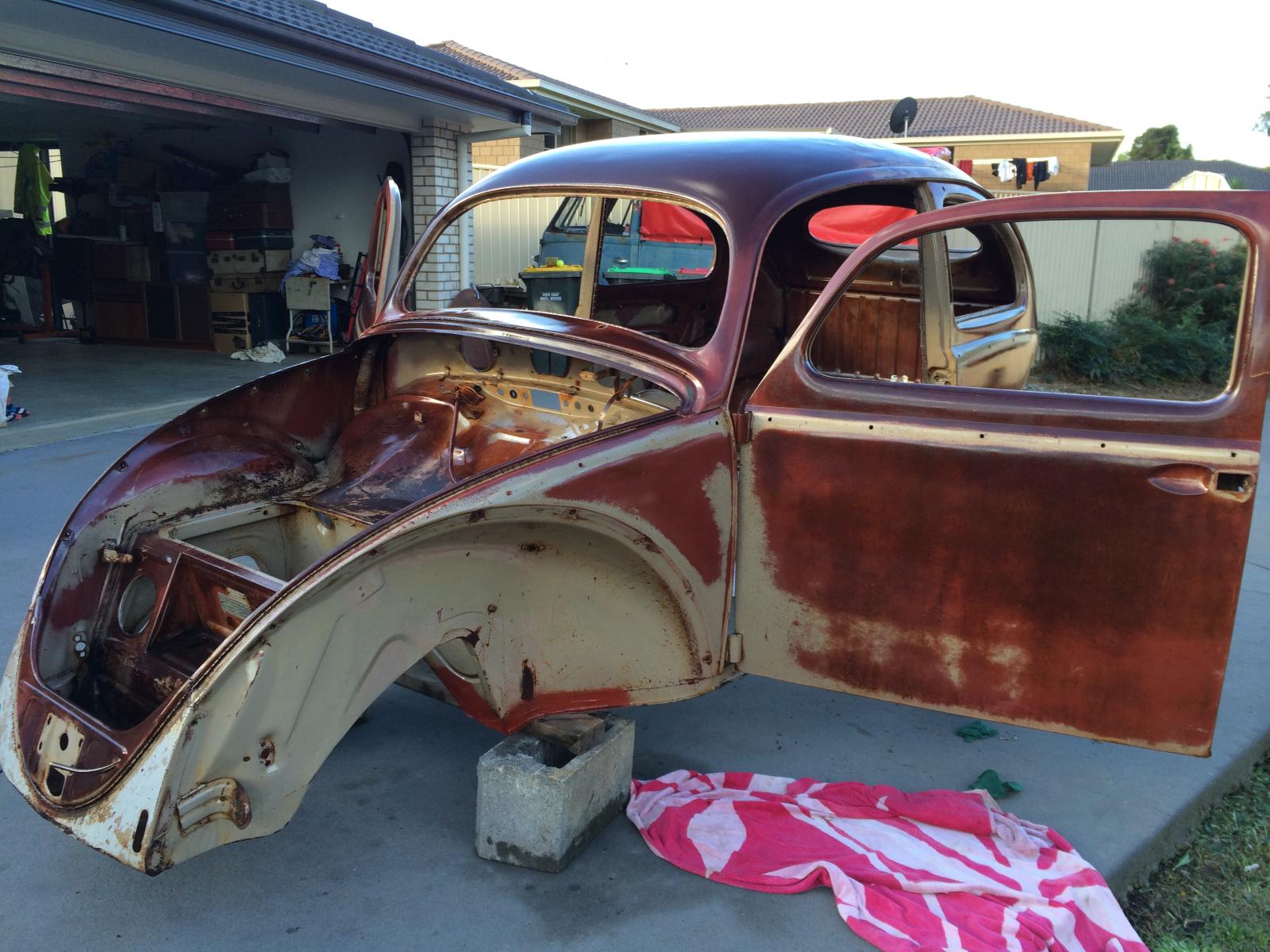

after crashing the ute into a fence, lomg story, dont ask.
finally got the body sitting on the chassis.
its not bolted on, but just sitting there for now since its raining all wknd an i need to work on it, so the shed it goes..

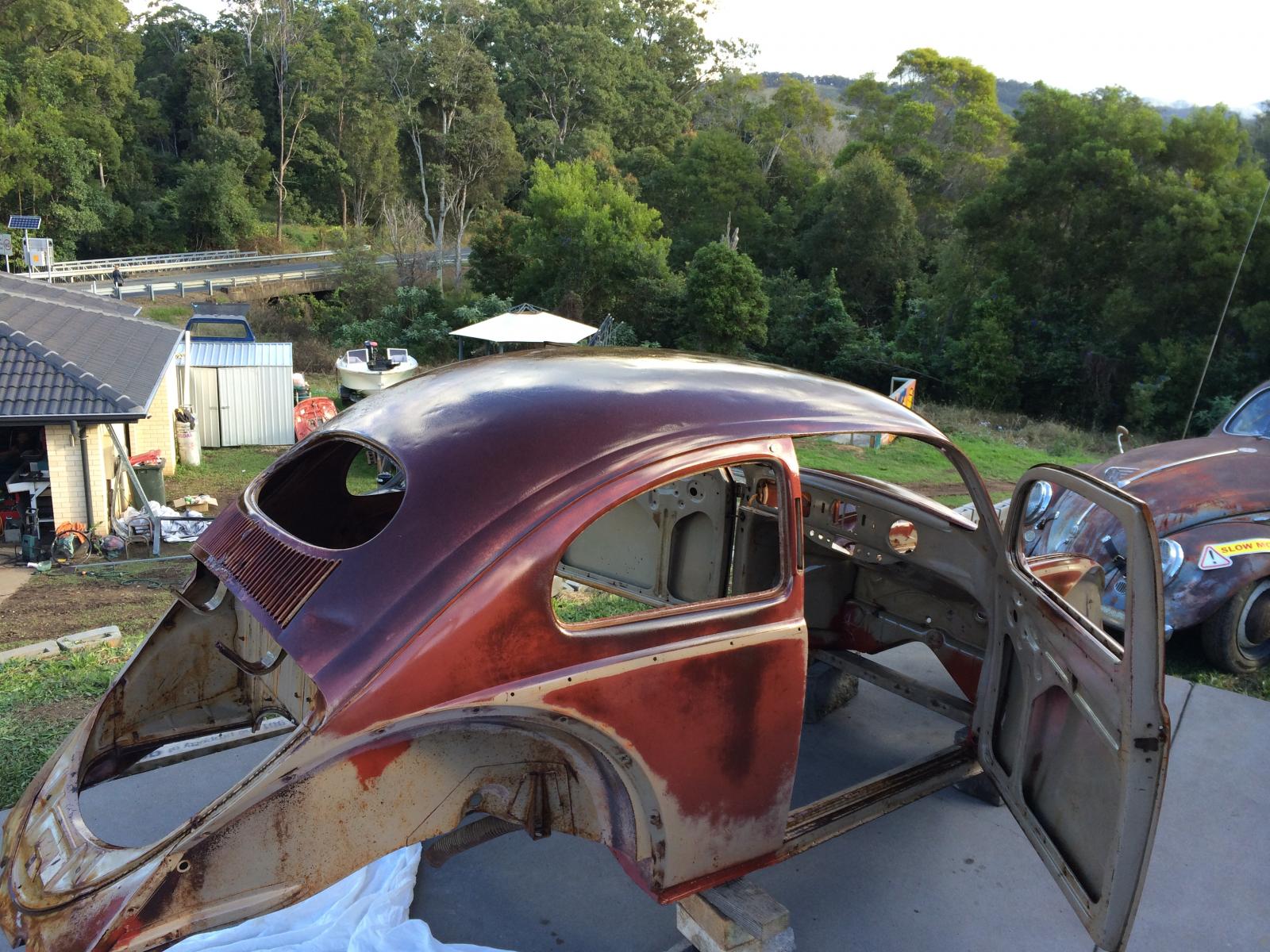

so, after the under side was dry, a good scrub of everywhere else was in order, waited till it was dry
then...
so close to body back on an bolted down now..

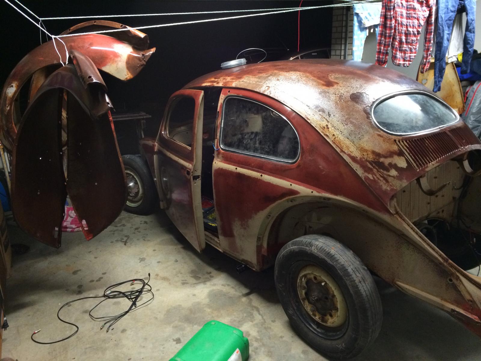

got an early mark from work 2day, so got stuck into it.
wiring in, just need to hook it all up.
empty roundup containers make for a good helper! frustrating lifting and moving it yourself but u tend to make do with what u got..
finalizing the seal an bolt holes..

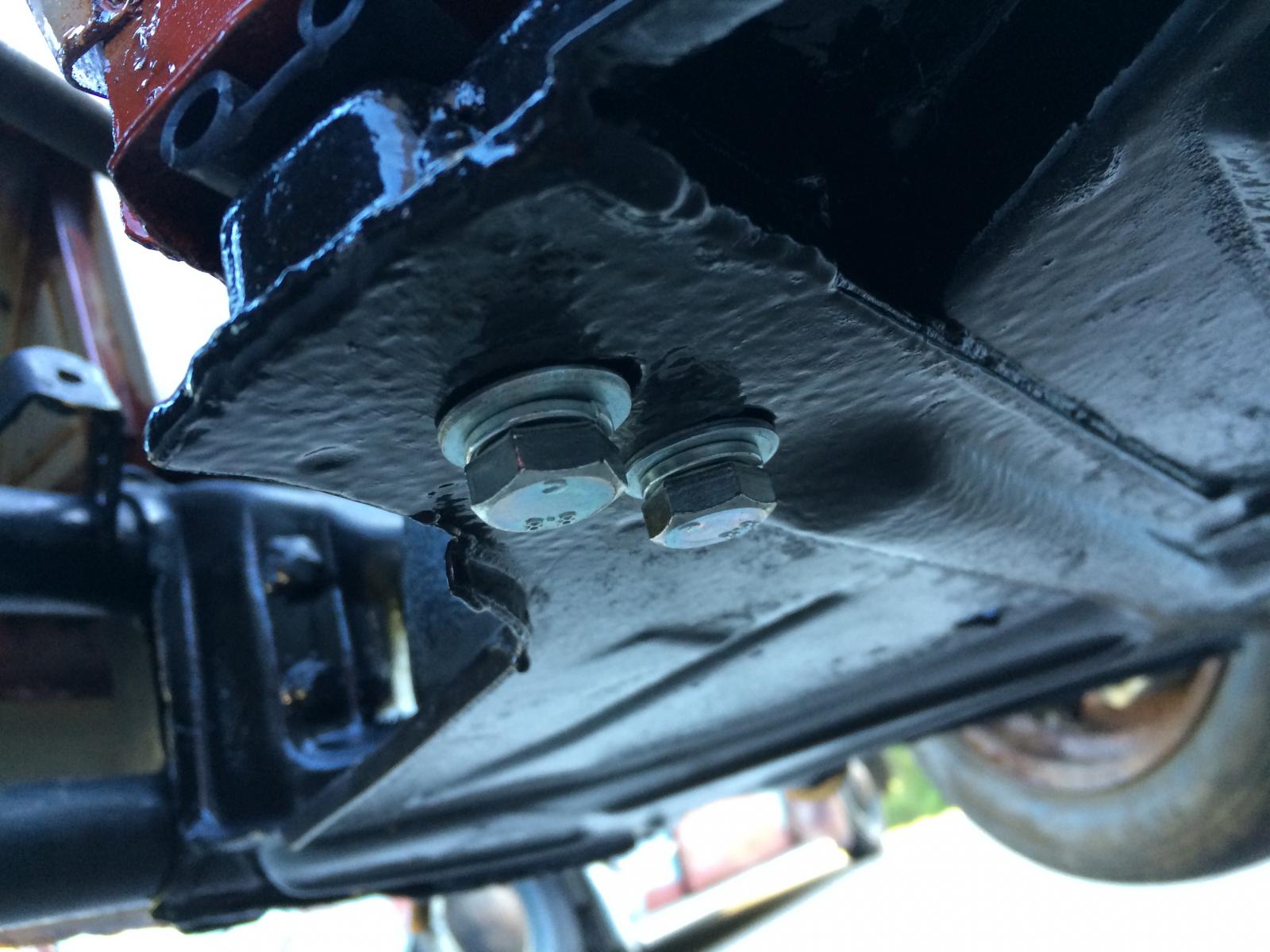

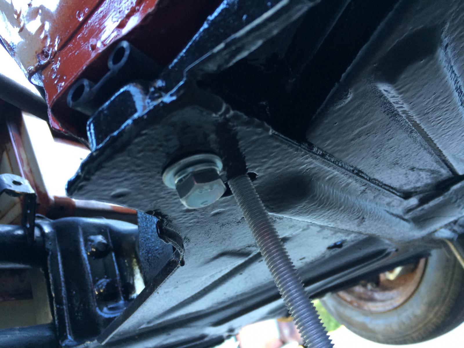

i had a thought on lining up the front 4..
insert threaded rod
drop body on pan and hold them down tight.
pull one rod, insert bolt.
have it so it has a little pressure on it, then pull the other rod an inset other bolt!
simple!!
5 mins for both sides! ive battled previous ones for ages. best idea ever!! haha

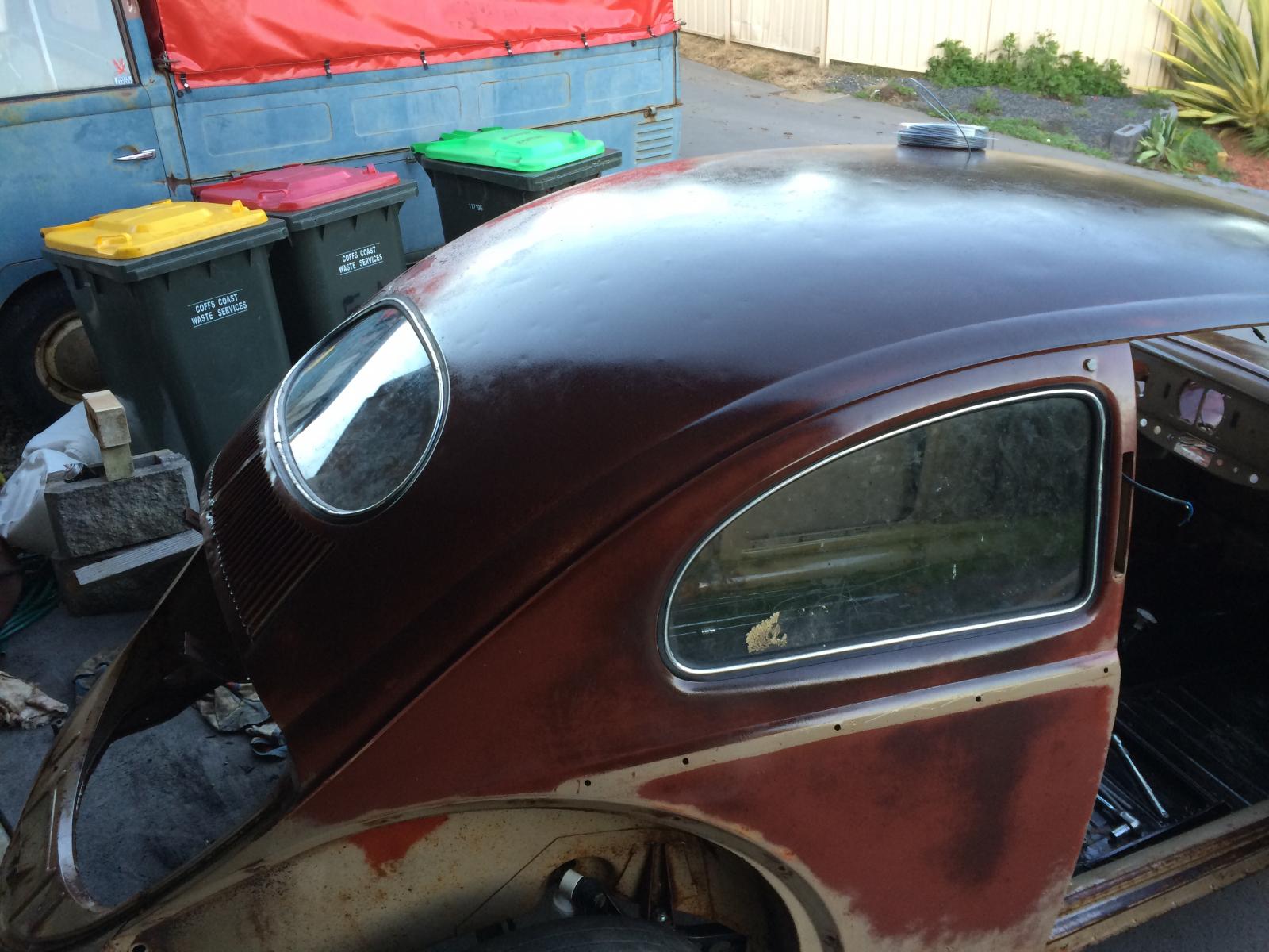

windows are now in too...
mmmmmm mossy

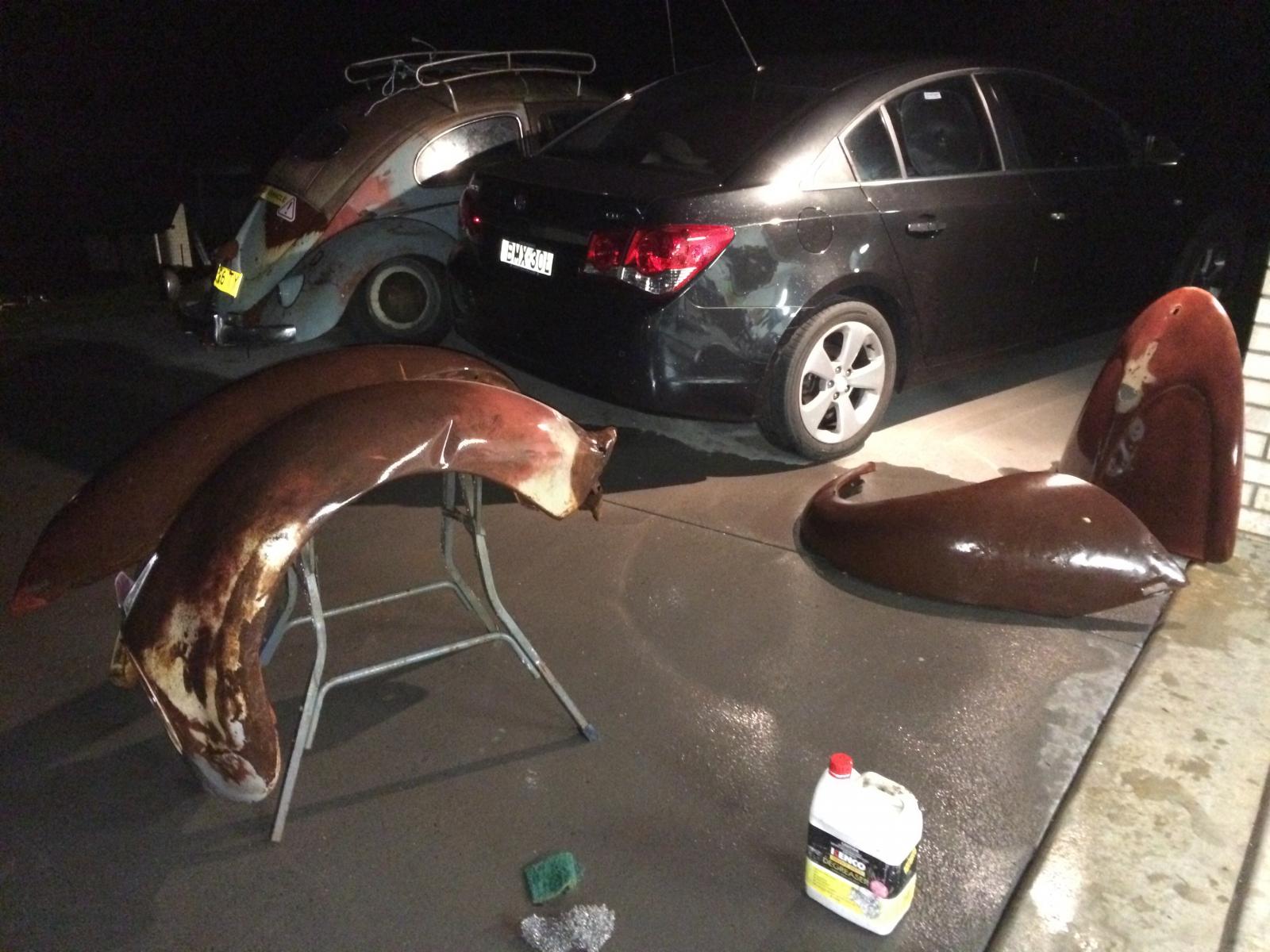

So had a moment 2nite, and scrubbed the shit off the guards, decklid and light housing.
Then hung them out to dry.
