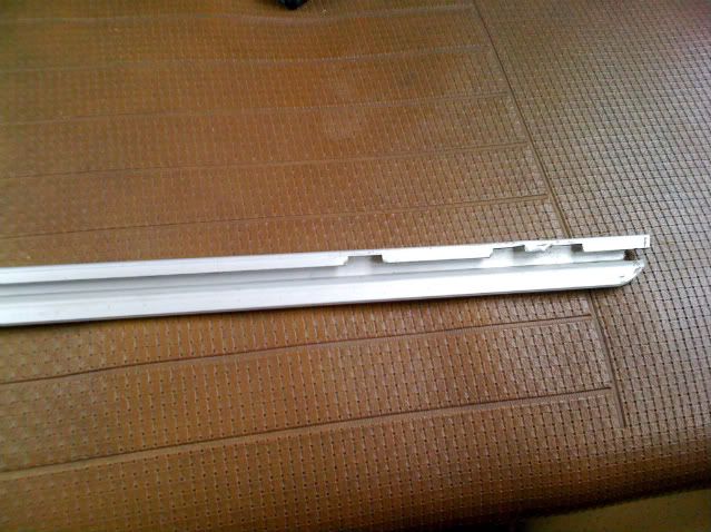

I am trying to chase up the aluminium bar that sits in the window that has the lock notches in it, my one is broken and the window can be opend from the outside (at least i hope thats the problem Sad ). If anyone knows anything about these windows it would be a great help. All i want to do is make sure i can lock the whole car up, last thing i want is my pride and joy being stolen.
BTW: this is a T2 kombi but from what i can gather the parts are fairly similar (i may be wrong).
Any help on getting parts for these windows would be greatly appreciated.
This is the part im looking for:

Looks to me like the problem with Geezy's bar is the worn edge of the first notch. New nylon sliders or felt strips won't cure that problem.

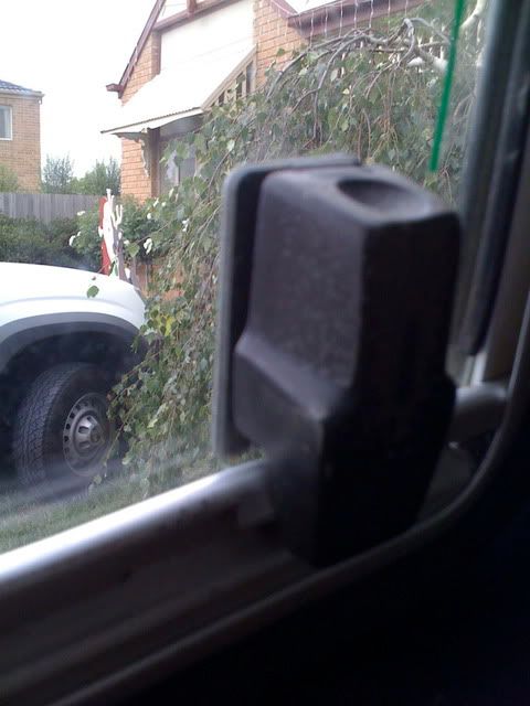

One security measure I've read about somewhere is to drill and tap a thread into the side of that black pushdown thumb button. When you really need security, install a screw into that threaded hole and bind the pushdown button from moving.
Alternate might be aluminum soldering a new corner onto that first notch. That stuff is harder than the original aluminum!

i wonder if he was to hack that worn angle off, just a shave. would that make it as good as new??

Thanks for the feedback, i have replaced the bushings hopeing that it would solve the problem but no luck (although it did make the window a lot easier to slide open). Im thinking that i might have to some how solder a new corner onto that first notch, although from what i have been told soldering aluminum can be very difficult. Its just a shame its so difficult to find a replacement, ohh well fingers crossed

Hey greezy, soldering aluminum (or Aluminium) isn't really difficult. Use aluminum stick solder - not lead/tin solder, that just won't work.
Use a small propane torch, nothing excessive. No oxy equipment. Clean the part with a stainless steel wire brush. Just heat the aluminum bar until the solder stick will melt and slide along the heated area. Don't heat the solder stick! Don't overheat the aluminum part until it goes grainy cause the next stop is a puddle of aluminum on the floor!

Just another thought for you...If you bend a small "U" shaped piece of aluminium and epoxy it onto that worn edge ..it will keep you locked for years....till you can find a better way
