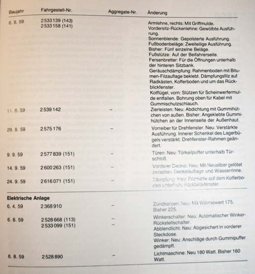

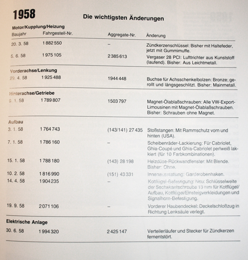

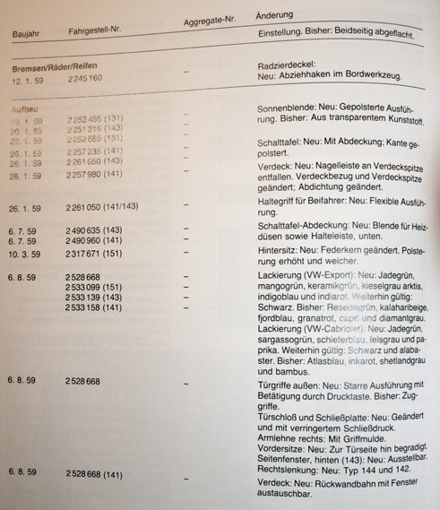

I took a few pictures from the book "Der Käfer, Band 1" by H.R. Etzold, 1994. A German book which is here more or less considered to be the benchmark standard when it comes to summaries of the most important year-to-year changes. (Although I've heard that it is not 150% perfect as well)
So, here are the pictures. (I know it's all in German, maybe I can translate a few things if it helps)
Unfortunately it says nothing about fenders, but here's another picture of my 58 - i still think they are later ones, but maybe it helps
I also just checked my 58s' birth certificate. It states that VIN 2135954 has been built on 22 October 1958. Does that make it a 59 model or is it one of the very last 58s??

Does anyone have a photo of the page pictured above in full? It looks in the photo like '59 started November 1st.
It's not impossible that there is more outside the part visible in the photo that changes the meaning. Context is everything sometimes.

mario_0609 wrote:
...........Unfortunately it says nothing about fenders,.........
Actually it does, 6.8.59 but it refers to the mudgaurd bracket, and headlamp bucket rubber wire pipe exiting the top. This info also applies to the Ghia.
You are right, nothing for the Beetle.

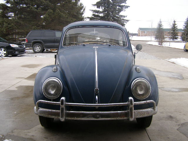

First off, I applaud you on your hunt for finding as much info as possible as well as the correct parts for your restoration. I know how fun that can be. Rolling Eyes
My 58 has its original fenders on all four corners. Sorry for the quality of the pic, its kinda dark in my garage.
Here are a couple of pics of my front fenders, I hope it helps ya. Smile

Some intresting tidbts of info here....
From production numbers, my car was made sometime in Dec '58, purchased in Feb '59, and has had a '59 title ever since.
I imagine that if you bought a VW in calender year '59, it was titled as a '59. If it was bought in '58, it was titled as a '58; I really doubt that there is a DMV in the country that gives a sh** as to when the car was made or what the model year was, because the paper trail only starts when the car rolls of the dealer lot.
Model year? I'll venture that the August 1 date is right. The page of PR under discussion appears to be all about VW pickups- and nothing to do with Type 1's
my59: Well son, my grandfather died before I got to drive it, so does that answer your question?
