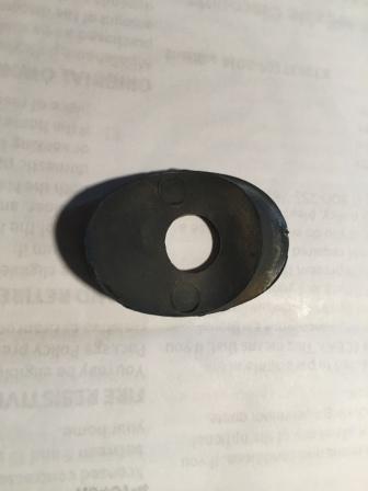

Does anyone know where I can find the bumper grommets that go between the bumper overriders and the blade on a 67 Bug to prevent scratching? Hope these pictures can help.

To my knowledge. Original (OG) bumpers did not have grommets between the over rider and the blade. After market ones do because of terrible fit up.

Those are from aftermarket bumpers, which means you don't have factory bumpers.
They aren't to prevent scratching, they were used to hide the horrible fit from the towel rail to the bumper blade from cheap aftermarket manufacturing practices.
The quickest and easiest way to see if someone used cheap crappy aftermarket bumpers on a restoration is to see those pieces of rubber on the bumpers.

Those are aftermarket from cheap bumpers. Non stock. I don't believe Wolfsburg West will have those.

If you need to fill that gap on your bumpers, you can cut your own oval-shaped spacers from inner-tube rubber. You may have to stack 2 or 3 together to fill the space, because, as others have said, the cheaper replacement bumpers used these grommets to mask the less-than-perfect fit. If you cut your own spacers, be sure to use SOLID rubber, and not any kind of foam rubber that will retain water and encourage rusting. Good luck.

Post a Wanted ad. If I had any- I'd mail them to you for free. I will never in my life put a bumper on a beetle that requires those- and I can't count how many I've thrown away.

The replies may be harsh but understand a lot of the members here are very anti non "OG" (original German). In a lot of cases it's well warranted as repops of most parts are notoriously cheap and poor quality. Aftermarket bumpers in particular are pretty poorly made and are infamous for rusting within a short time. If you're planning a quality rebuild, look into some nice original bumpers, quality replacements by Wolfsburg West or even the stainless steel ones that are being produced nowadays. They're spendy, but nice.
