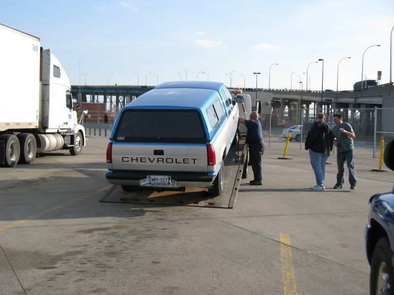

truck fuel pump dies as we enter the gate at US customs... US customs officers rock BTW!
Several hours later and unable to export the car, CAA and Mac arrive to save the day and the car is imported into Canada.
72 hours pass, I bring the car back to US customs to export it and here it is!

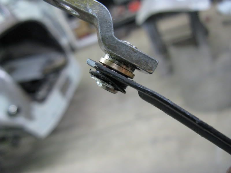

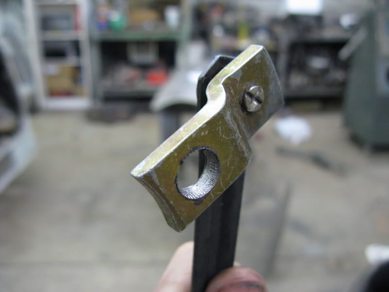

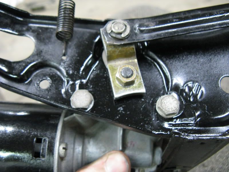

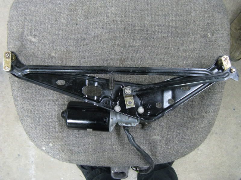

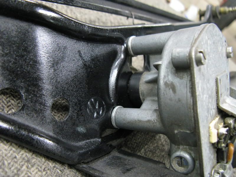

First on the agenda is to convert the wipers to 12v. i used a 72 beetle 2-speed 12v wiper motor that i found in my shop, and adapted it to the 58 assembly.
oilite bushing i made to adapt it.
Installed
Then i welded on civic wiper arm tips to the stock ones so i can use a standard blade that's available a CT. Works perfect and i even made the 2-speed switch look factory!

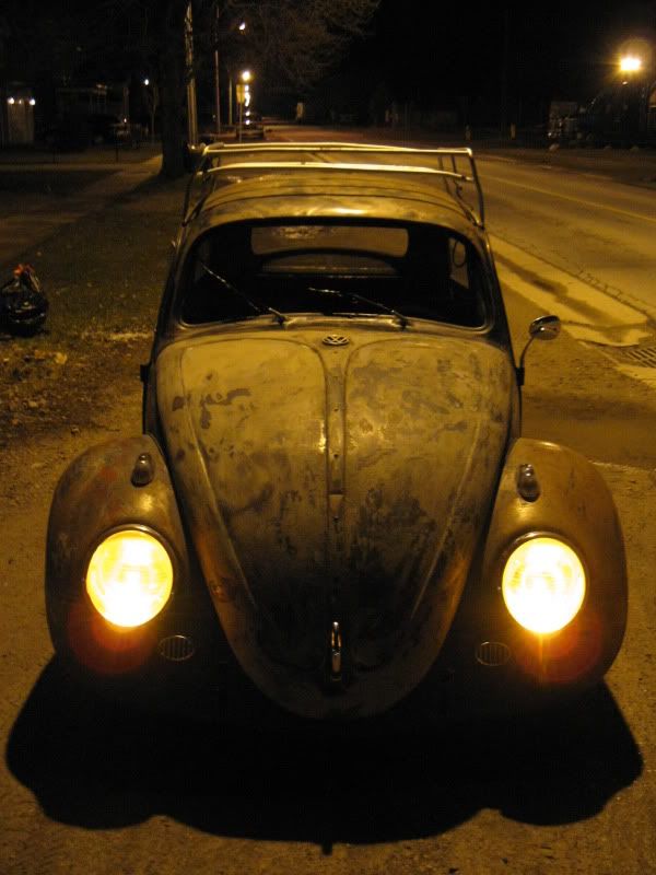

Night shoot.

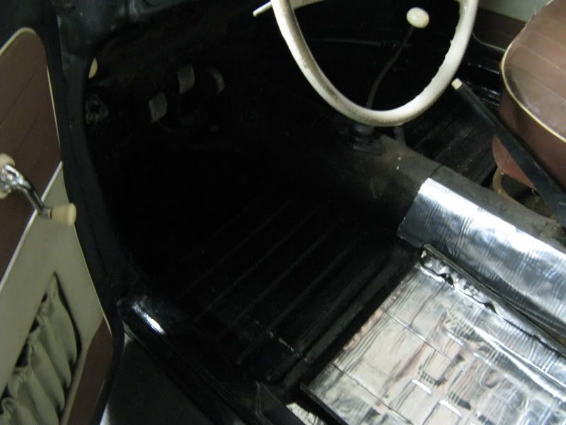

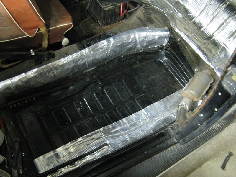

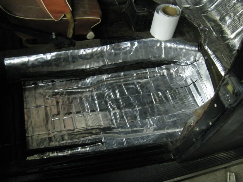

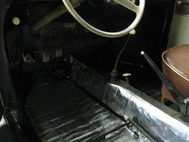

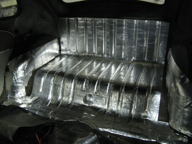

Yay for the US, found my 'Sound deadener" at home depot in the states yeaterday, I should have bought 2 more rolls tho!! Awesome stuff so far to work with.

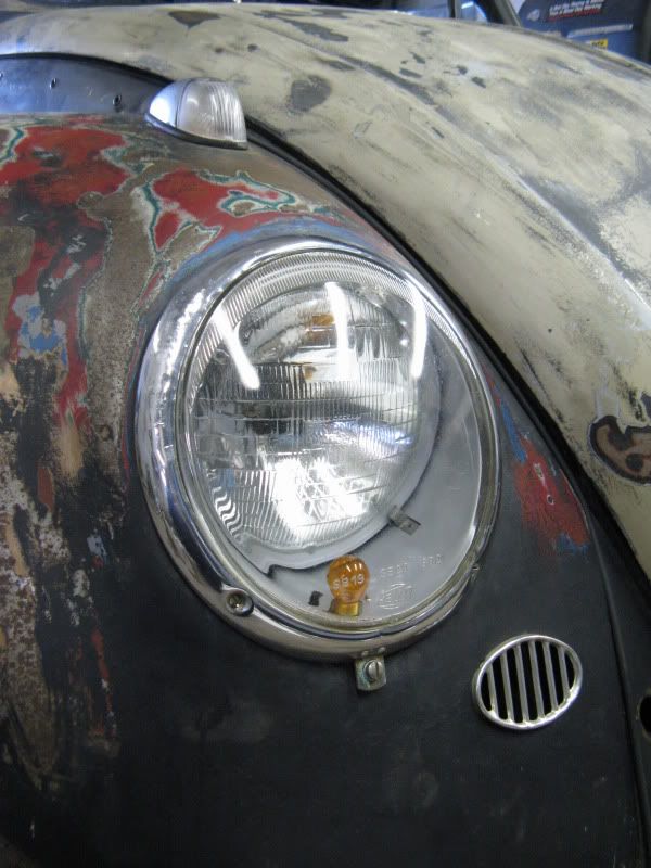

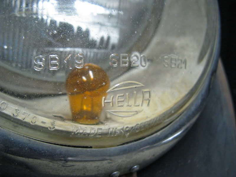

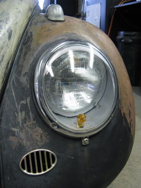

Here some shot of the totally finished headlights i did on friday. i redid the left one that i originally finished on thurs because i just wasn't happy with it. there were a couple pits that i left that i thought you couldn't see once assembled, but they were totally visible so apart the came...
then i fucked around with the carb for a couple hours with no avail.. so i moved on to sound deadening. Having never done this before i think it Looks freakin sweet IMO.

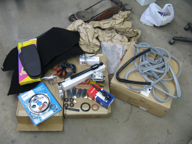

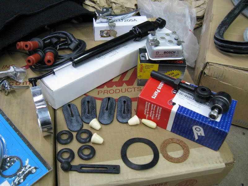

A bunch of awesomeness arrived last week! 29 to be exact. yay new parts.

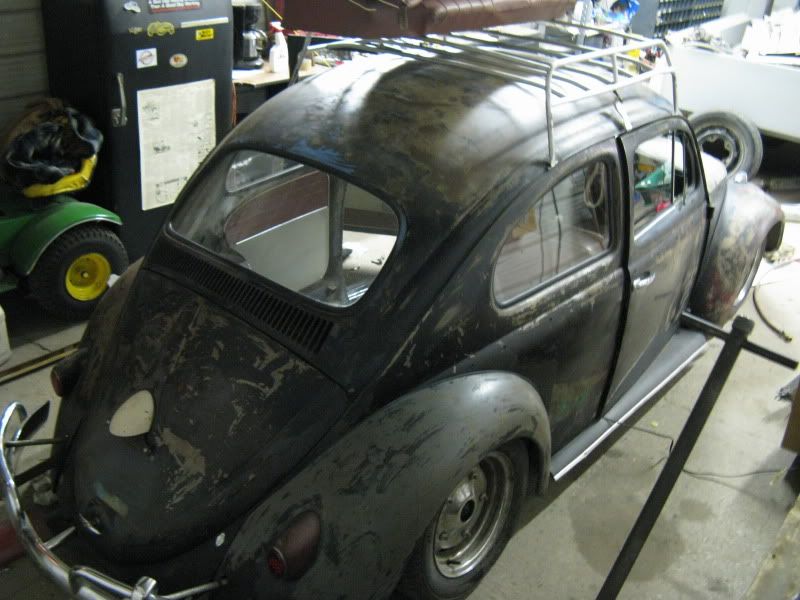

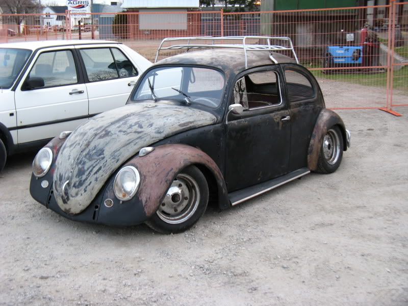

Current state of the car

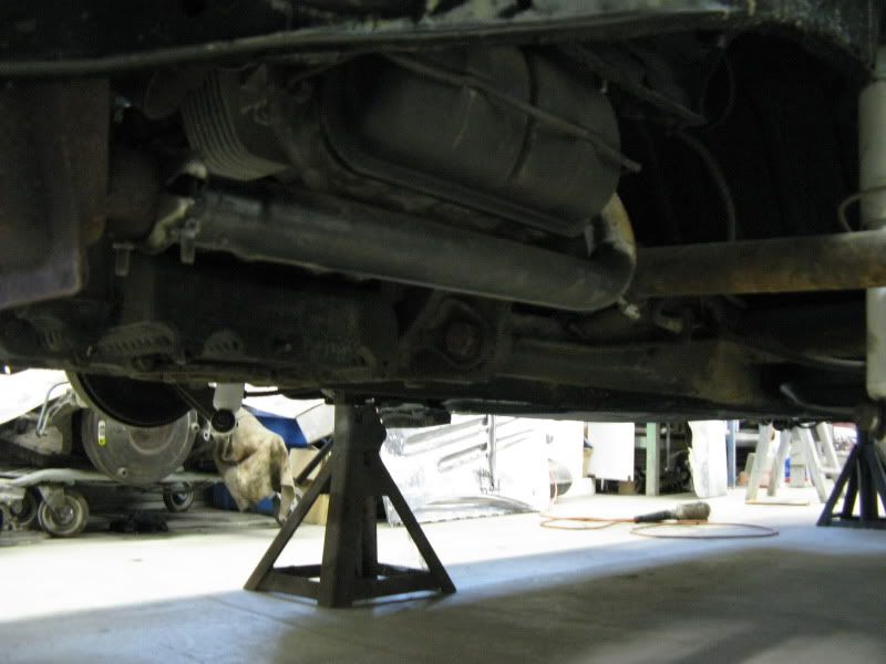

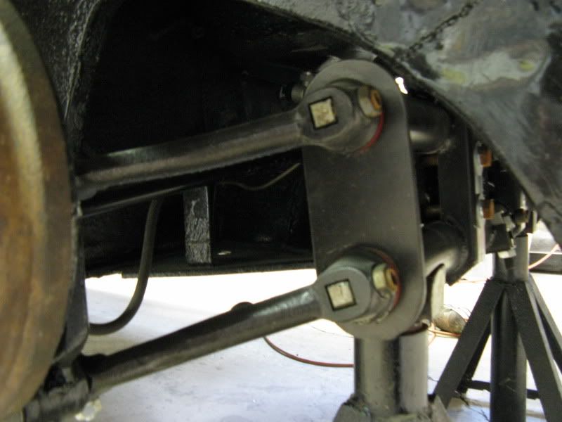

Some under carriage shots. Solid! its like a boat haul.

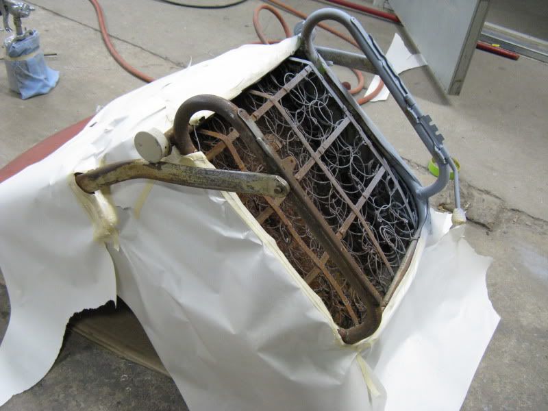

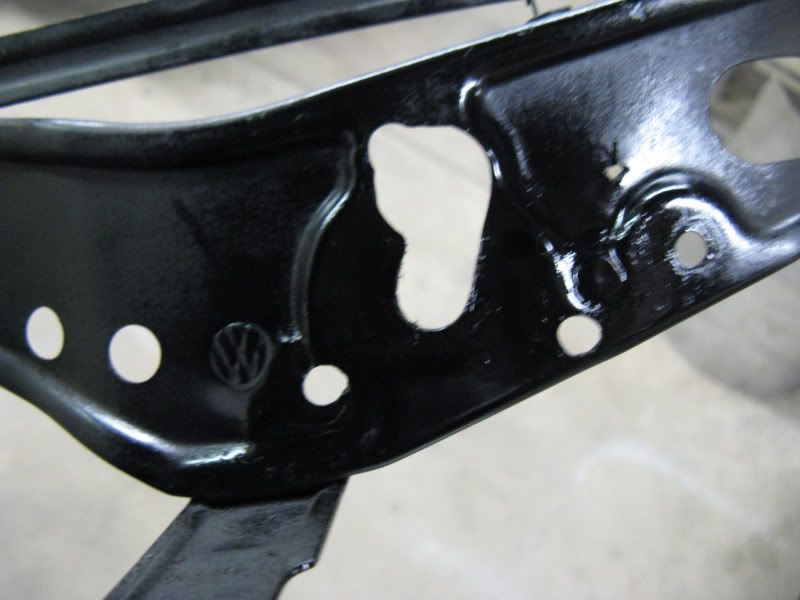

Sanded, primed and painted one of the seat frames, no finished pics yet.

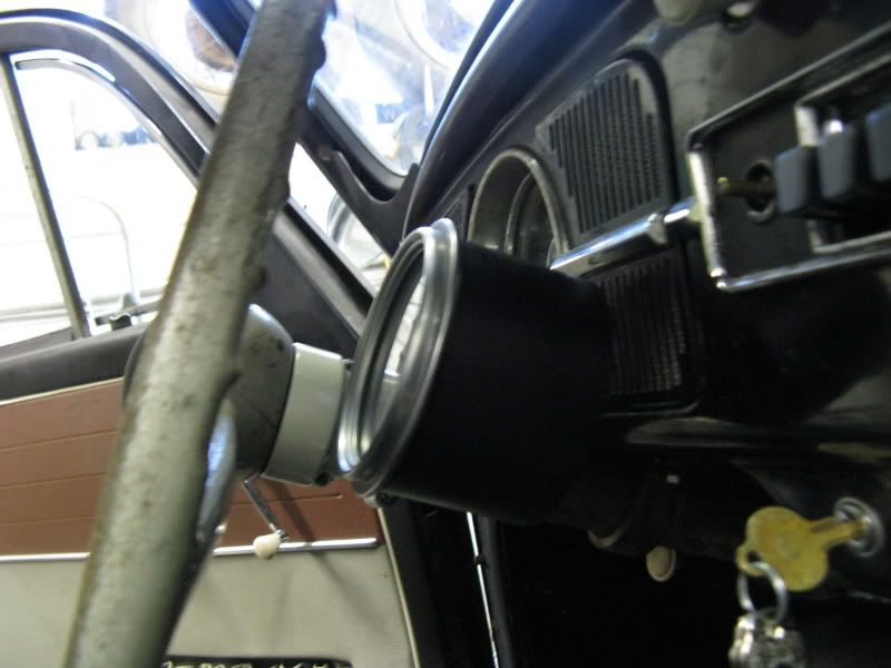

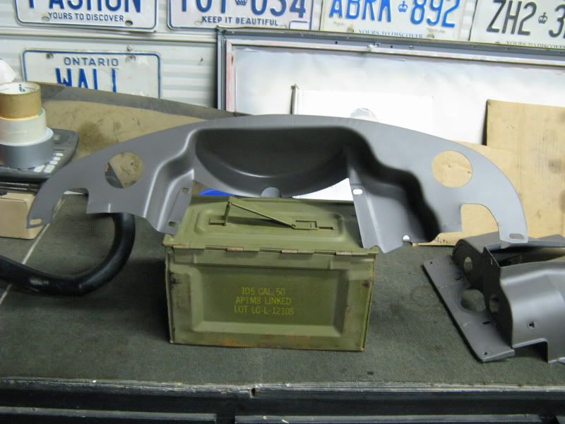

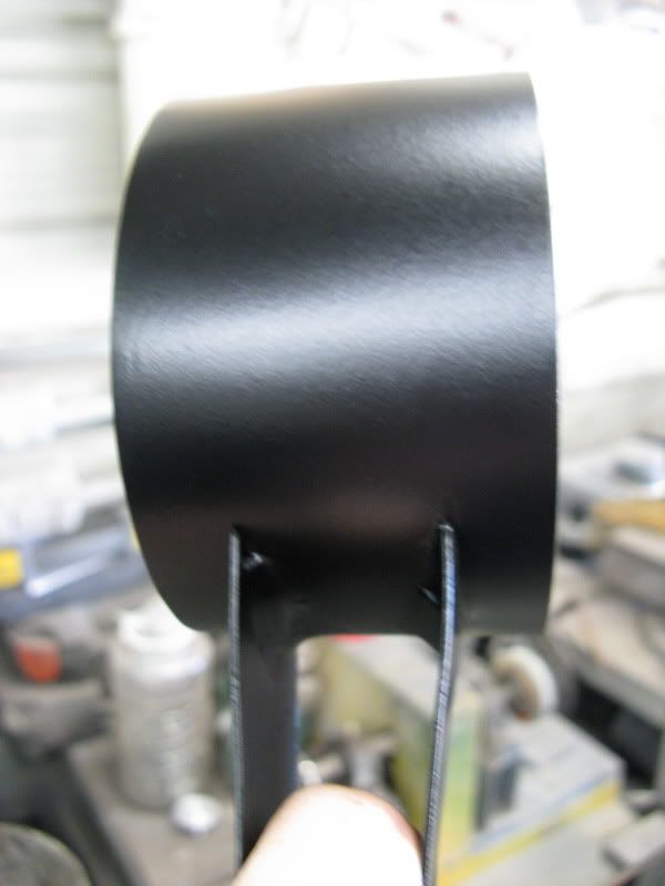

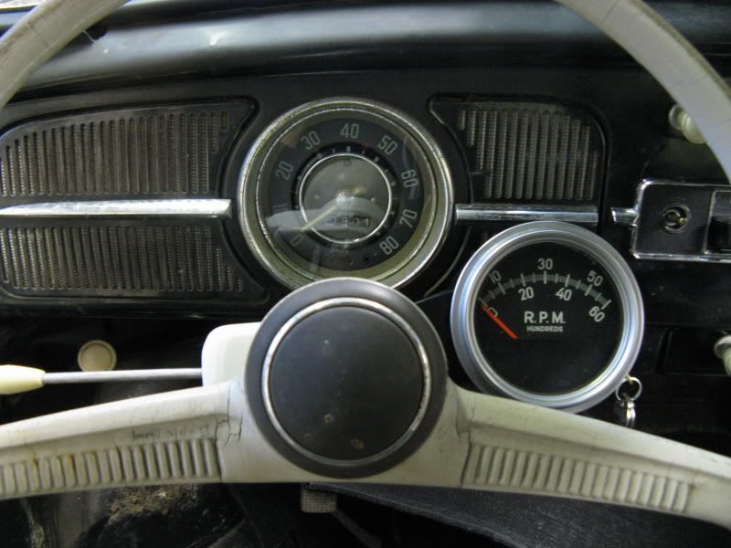

Stole my vintage Sun tach from another project. Made a gauge mount cup out of 3 1/2" exhaust pipe and sheet metal.
Looks nice and vintage.

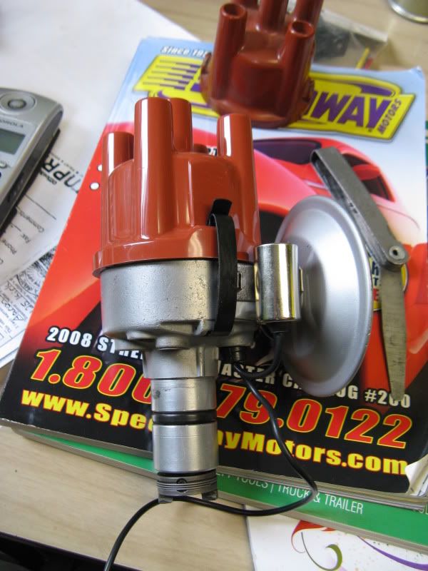

Picked up my distributor parts this morning.
New parts installed.

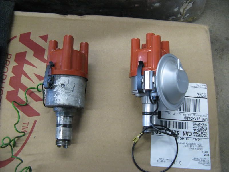

New distributor compared to the old. the old one is a centrifugal advance, the new one is a vacuum only advance. better for fuel economy and drivability.

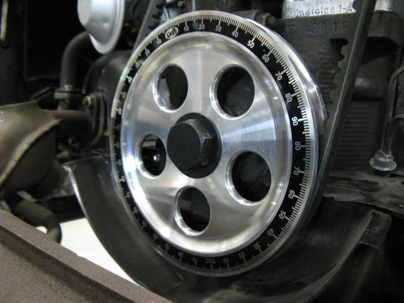

Old pulley vs. new degreed pulley.
Distributor installed, old pulley off.
Pulley on.

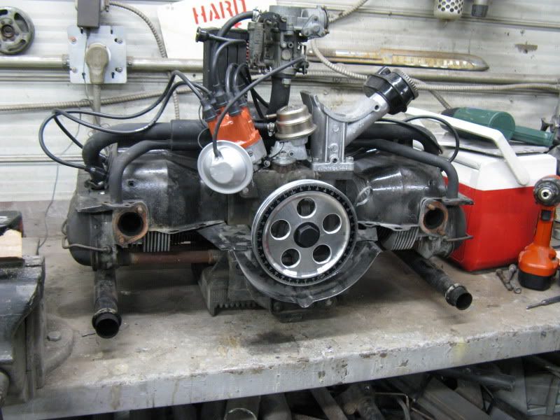

So then i got it all back together and got it running.
and then this happened. took 45mins taking my time.
up on the bench, easy to work on.
A gaping hole.
Reason for doing this, now i get to go over everything and work my magic on it.

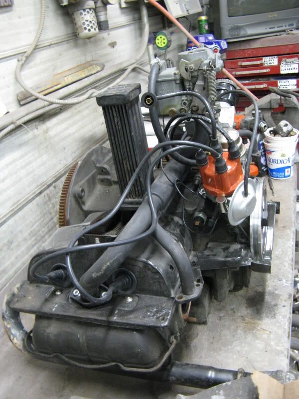

Motor striped down and in the process of getting cleaned.

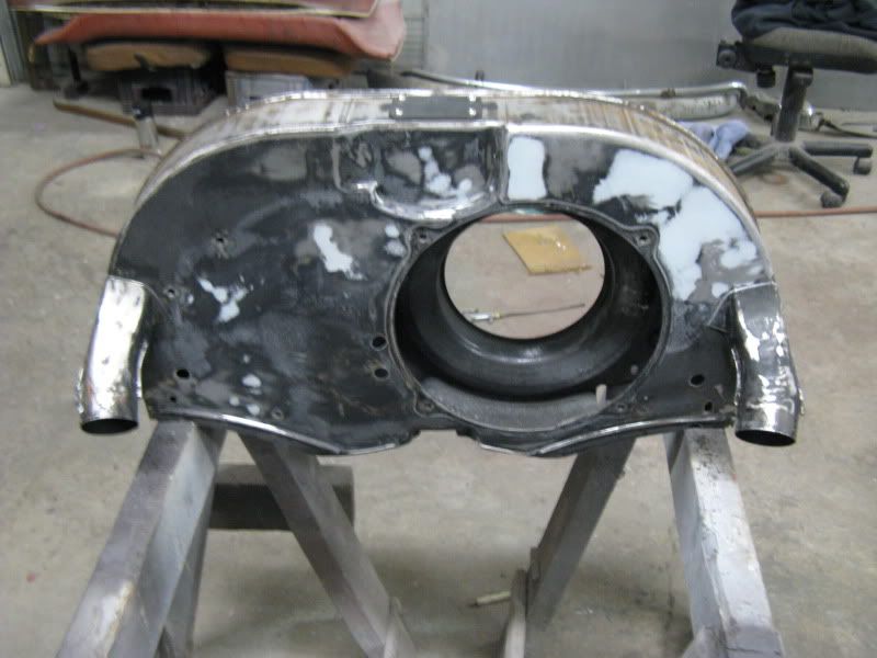

I filled and shaved everything unnecessary on the tins. time consuming to say the least.

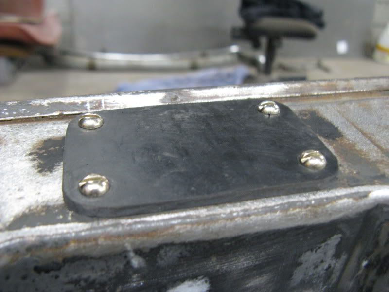

little rubber pad i added, keep looking to see what it's for.

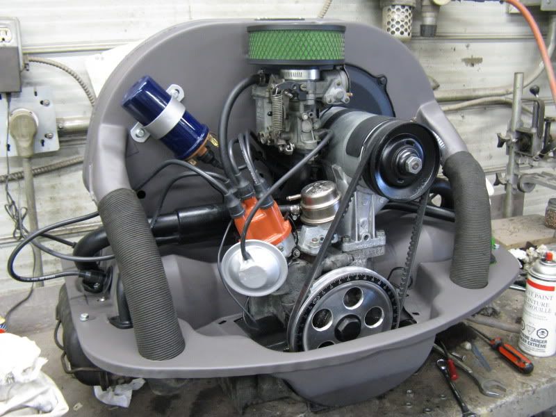

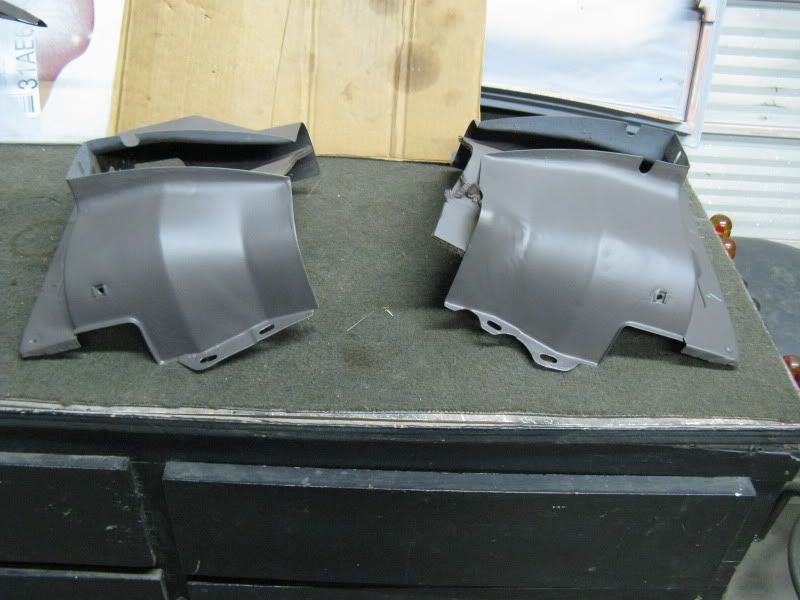

I picked a grey/bronze/brown colour. looks very wartime. i love the way it turned out.

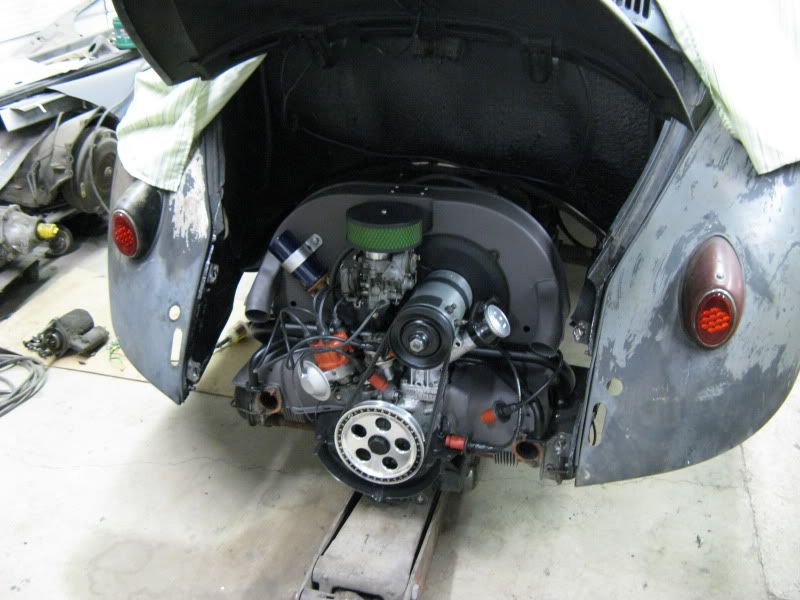

2am mockup after all the tins were painted, the block cleaned, all brackets cleaned and painted, generator restored, coil painted etc. Some much more simple and clean looking.

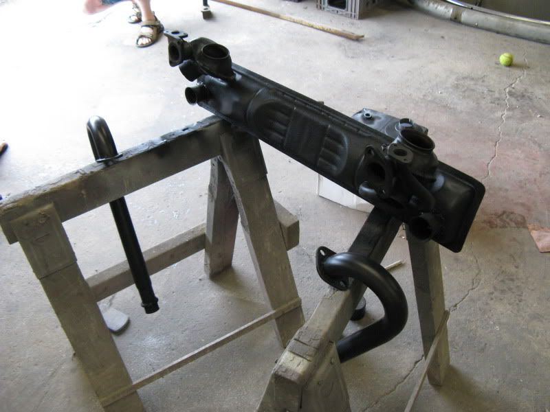

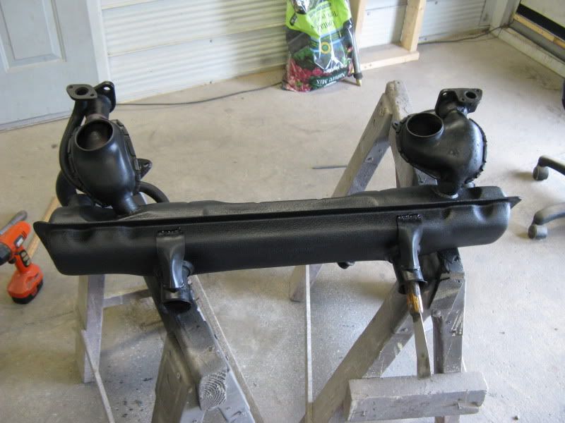

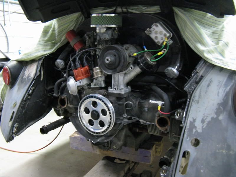

cleaned up the exhaust, welded some cracks and painted it. looks new.
McDonalds cup condensation in an alien like formation.

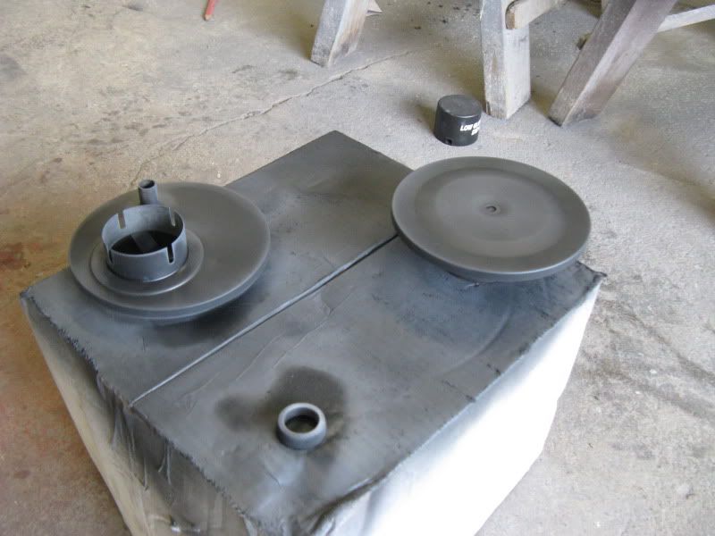

painted my air breather, no chrome allowed anymore!

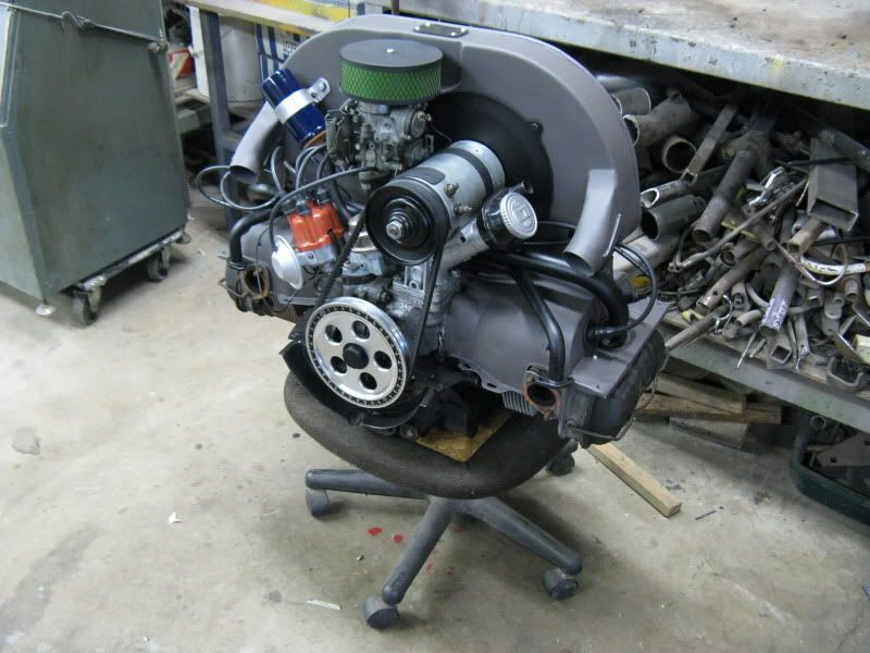

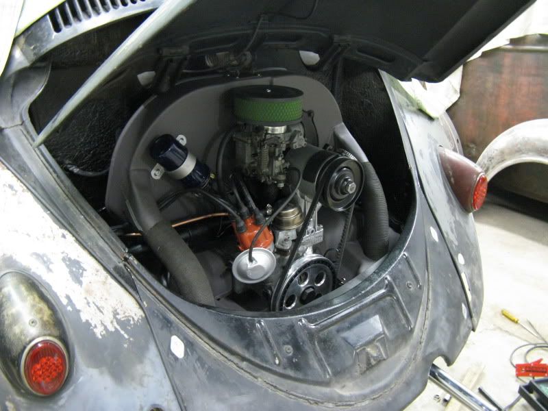

The final assembly, i couldn't stop staring at it. i want it at home as artwork.
Car engine on an office chair.

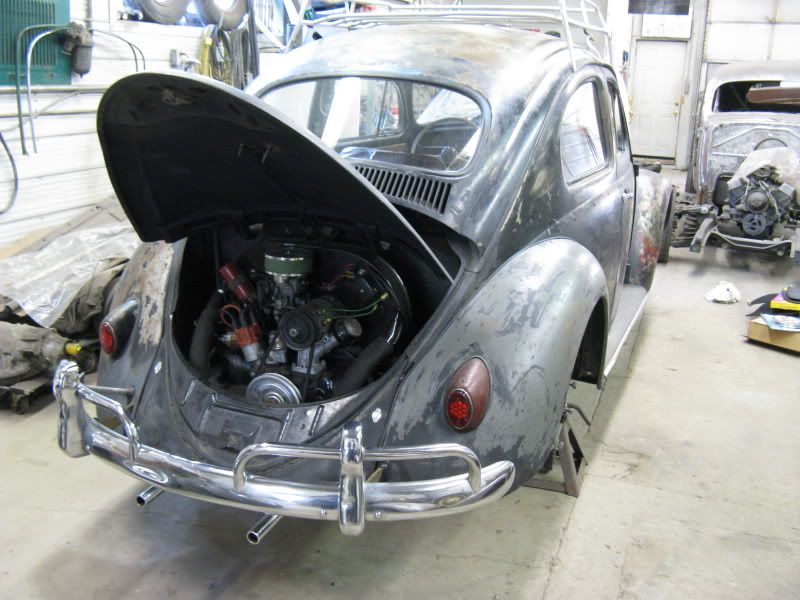

Almost back in

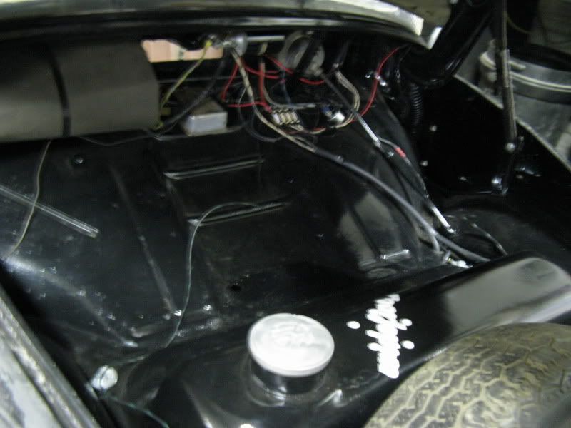

Done and running again. New fuel lines, some new wiring and i think i fixed an intake leak. it fired right up, i was surprised since the whole rear fuel system was empty.
"hits the that was easy button" Rolling Eyes
Engine before
the little rubber pad. since this motor is from a 70's beetle the tins rub on the decklid spring. not anymore!
MAYHEM

Is the quick roof working well as sound deadener?

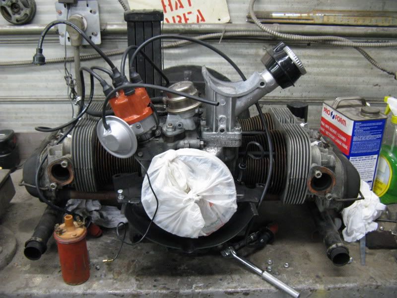

Any thoughts on going to an oil bath air cleaner?
also, what is the plan for the body, respray or keep it as is?

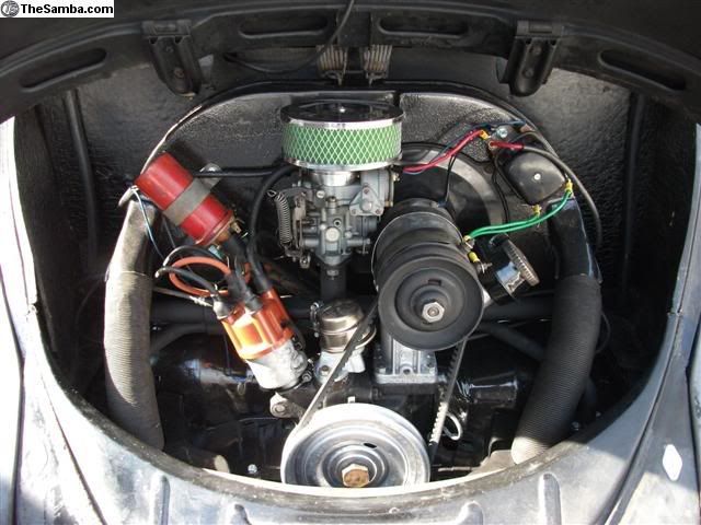

First off all, that's a very nice car sir !, and great job on the engine, beatiful!
But i would recomend a normal oil bath filter, everywhere i hear and read that with your type filter the engine won't run smooth, especialy when it's idle.
it passes the knock test, just a thud when i hit it. i haven't driven it yet with it in. i have to get more to do the inside of the doors and the front firewall.

thanks, i haven't read anything bad about them yet. is it because they are made of cheap urithane? i could make one out of some red urithane material material i have and i know it wont fail.
Lots of different ideas are going through my head on a breather. old bath would be cool or a vintage performance looking air breather.
As for the body, for now i'm going to drive it as is, and pick away at some dents and stuff. eventually i want a gloss black bug.
thanks you very much!
this may explain some things! i am also worried that if i ever have a good backfire the foam element may catch on fire. why an i scared? this happened to me before on my freshly finished 66 elcamino. the edelbrock foam filter caught fire, ruined my carb with melted goo and my engine bay, not mention i got burned too.
this is the filter that came with the car, ill keep my eye out for another.

A-Wall wrote:
Yes, indeed, that is also a risk, so, a standard oil bath filter is the best thing i think Smile

I love it when people take pride in their engines. I just bought a 67 and the engine needs what you did and than some. If I wasn't using it as a daily driver I would do it too.
If you didn't catch on: awesome job man, my only question is did you remove the rear apron to replace it or has it been set up to come off?

I loveeee your tach mounting idea!! I'm pretty much gonna steal the idea from you Very Happy Car is coming out awesome so far
Thanks for the kind words. the body can look like crap but the engine has gotta be flawless in my book. this car will be my summer DD, i'm going to be very anal about keeping it clean!
As for the rear apron, it's made to come on and off, makes the engine removal much easier, well at least i think it would compared to having it there lol. i assume the way to pull the motor out with that pan still there, you'd have to jack the back end up real high and drop it from the bottom.
thanks man, its a simple and clean way of doing it, if you have any questions just ask.

and thanks to you guys, i just did a whole crapload of reading about oil bath air filters and found out how awesome they are, so now i REALLY want one, and i seem to like the pre 57 style.
so wtb a 36hp dome top breather WITHOUT the snorkel off the side for the hear riser. not a fan of the cone top style.

Well eff my single one year only 30 pict-3 carb, going duals!
Just bought this setup from "The Kaddie Shack" but with a Scat linkage instead. can't wait for it to arrive!
Link to the details
http://www.thesamba.com/vw/classifieds/detail.php?id=940817
