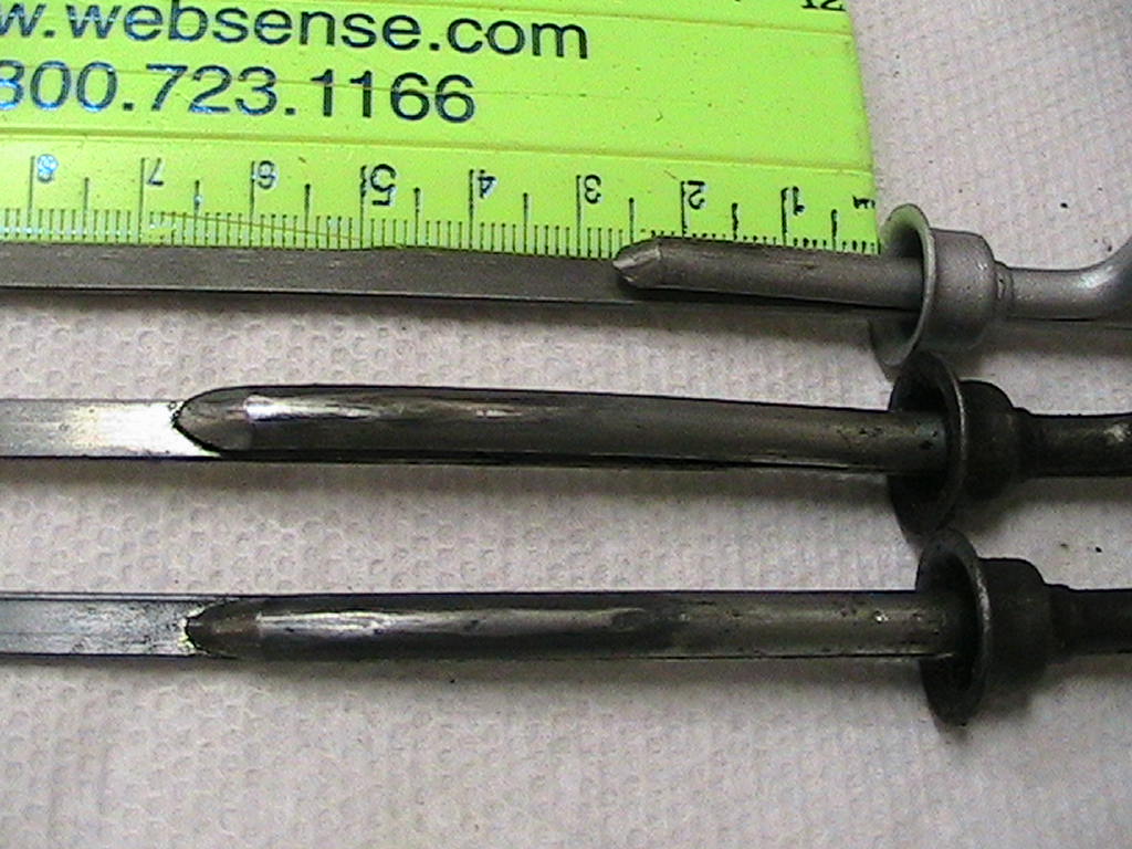

Not to add confusion, but I think the difference between a 36hp and 25 hp is the top part that holds the dipstick in the tube.
In these pictures the length is identical as are the position of the marks, but notice the length of the part below the "hat"
25hp is the silver one on top, 36hp is the one on the bottom. I'm not sure what the one in the middle is (maybe just broken off?) but it looks original.

The top one, came out of an August 49 engine. One identical to it came out of a rebuilt (in 1956) 25hp engine. The others came from different 36 HP engines.
I have one of those red handled ones and IIRC it's identical to the 36hp. I'll post up a picture.

1960 at the top (left) compared to a 36hp one. They are identical design wise with the longer upper spring piece (as compared to the shorter 25hp version). Of course the marks on the 1960 version are about 4mm lower on the dipstick and the top is red.

60 dipstick on the left. 59 and earlier 36hp and 25hp on the right.
The engine angle was changed in '60 thus changing the oil level at the rear of the engine. The '60 dipstick has the marks lower to compensate for this. The '60 dipstick was red to make it stand out.
There were differences in the hat and other details but as far as measuring the oil and '59 or earlier dipstick will work just fine.
