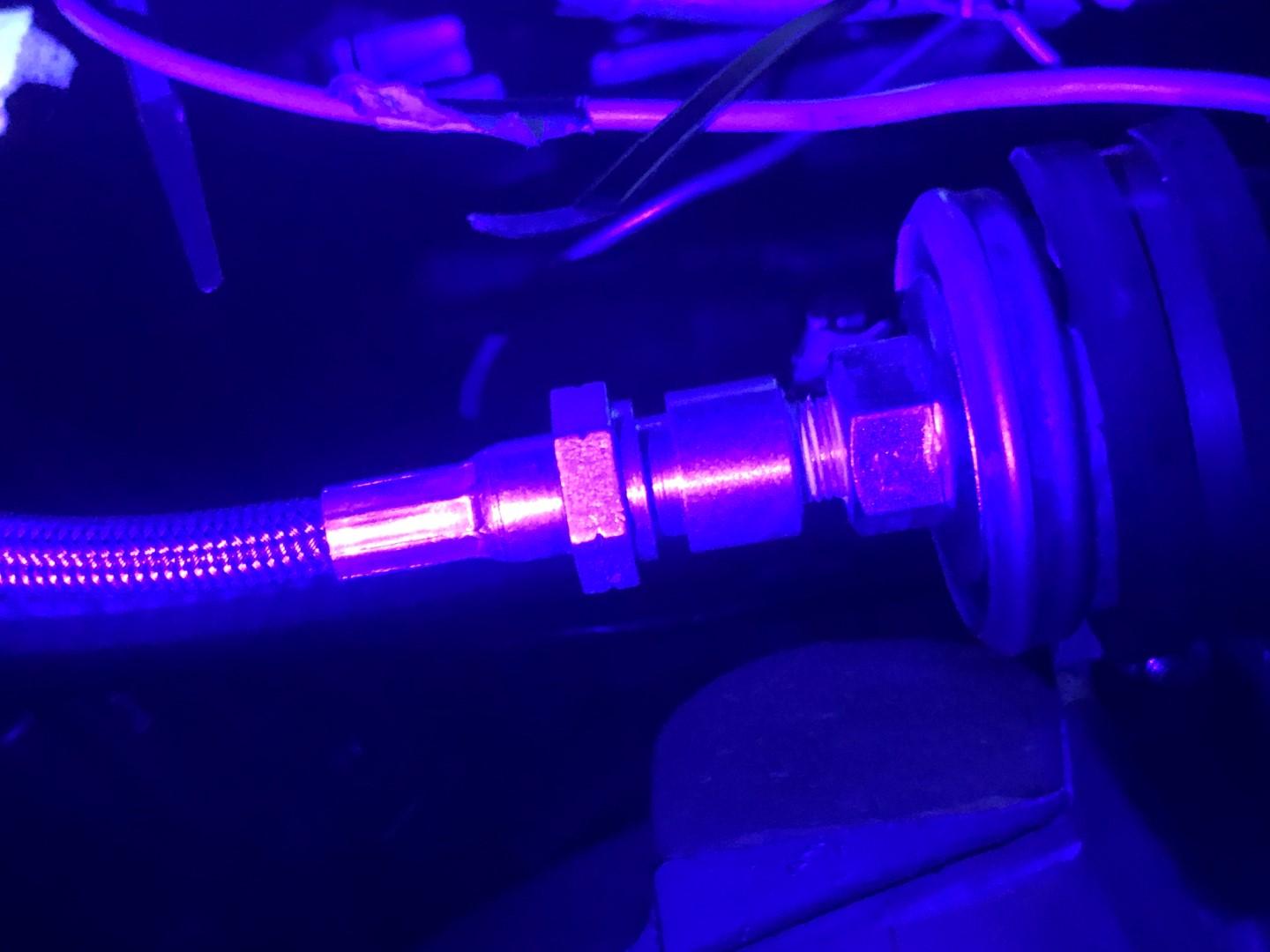

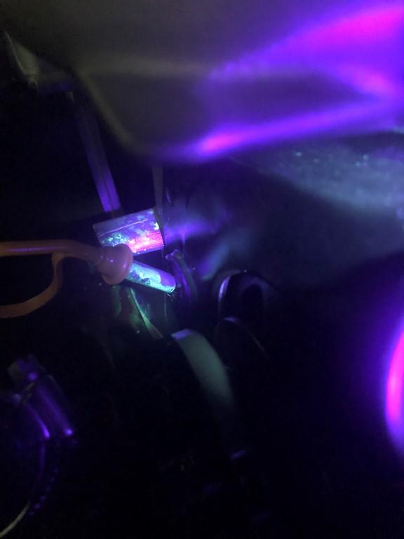

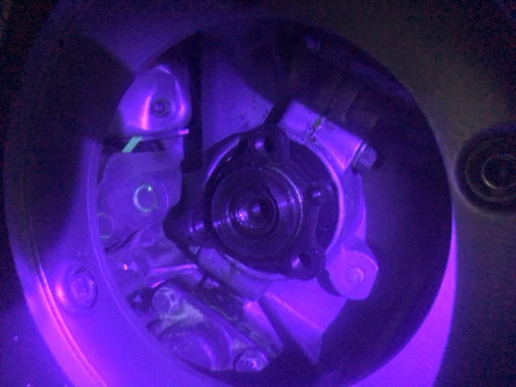

Update-
So I added the oil dye to look for my leak and then went for a 10 min drive and got the oil temp to ~200F.
1) Oil pressure.
As it first starts I'm getting 100-120 psi, and as it warms up then goes to ~5-10 psi at idle and 25psi+ at ~50MPH. It took at least 5 min to get the pressure to drop. So that starting oil pressure too high? I thought others said they were closer to 80psi. Will that overpressurise seals?
2) Oil Leak.
From what I can tell the oil pressue sender (using a brake line) and the distributor both look ok. So the sender relocation fix appears good.
The biggest offender appears to be the real seal. Looks like it's getting on the fan and spraying all around the back and trickling to the bottom. Some of the pictures came out better when I had my phone wear the yellow glasses (made a big difference in what I could see as well).The dipstick wasn't out, I just did it for the pictures to show that oil inside)
So looks like I'll be relplacing my rear main seal.
Thanks
Bill

danfromsyr
Joined: March 01, 2004
Posts: 15412
Location: Syracuse, NY
danfromsyr is offline
PostPosted: Mon Aug 17, 2020 9:07 pm    Post subject: Re: Chrustina- 1st real drive to Dixie Bus and numbers Reply with quote
that's not the rear main seal.
just because it's in the back of the bus.
your motor is in the vehicle 'backwards' Wink
that's a front pulley seal
and make sure your pulley bolts aren't contacting the seal.
https://www.thesamba.com/vw/forum/viewtopic.php?t=371710

I was able to remove the fan without removing the tins. I started to loosen them but just throught I'd try, and it came out.
So I took picutre with black light (and yellow glasses on phone)
1) I'm not sure the aft seal is really leaking. I see a lot of oil on left side (oil cooler/distributor/filter?), but not a lot in the seal area. Oil definitely got flung from the fan, but not sure if that is the souce. Thoughst?
2) I think I'll respray the engine down again and re-run it without the alternator hooked up and re-look and see if I can find this allusive leak.
3) Also, the timing mark I used is correct, though I will recheck the timing as well. It also looks exactly like a differnt spare fan I have (marking location).

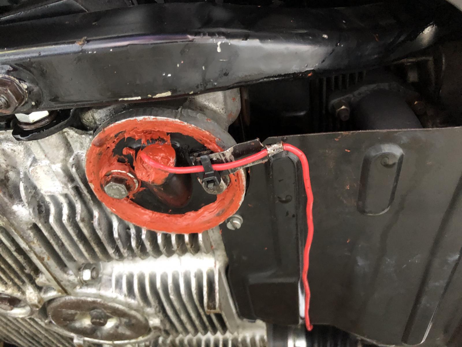

Ok- leak test #2.
So after another short run ~8 min; 190 oil temp I think I finally got good results.
Looks like my oil dipstick is leaking (again) and spraying on the fan shroud
and the aft/transmission seal area (didn't open it)
But not the main/forward fan seal, nor the fan itself that (both clean). Nothing from the oil pressure sender or the cooler either.
So why would it come out of the dipstick? Looks like it's getting overpressurized? As I mentioned my oil pressure is also around 120 psi cold...seems like others are closer to 60 psi.
Thoughts?
I am a little above the fill line. Should I drain some oil and see if pressure goes down?
Thanks.
