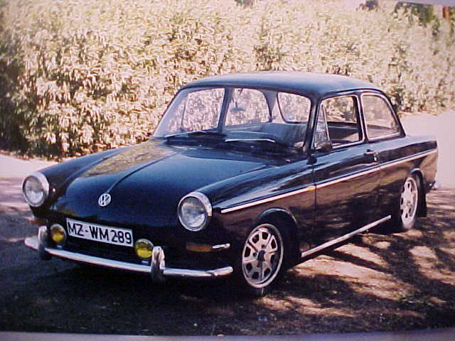

These are 175/55/15s on the front. I have driven this car from Oregon to Kansas and back as well as OR to Co and back... rides well, but if you go that low you have to remove the bump stops or the suspension will be compressed into the stops and it can be jarring

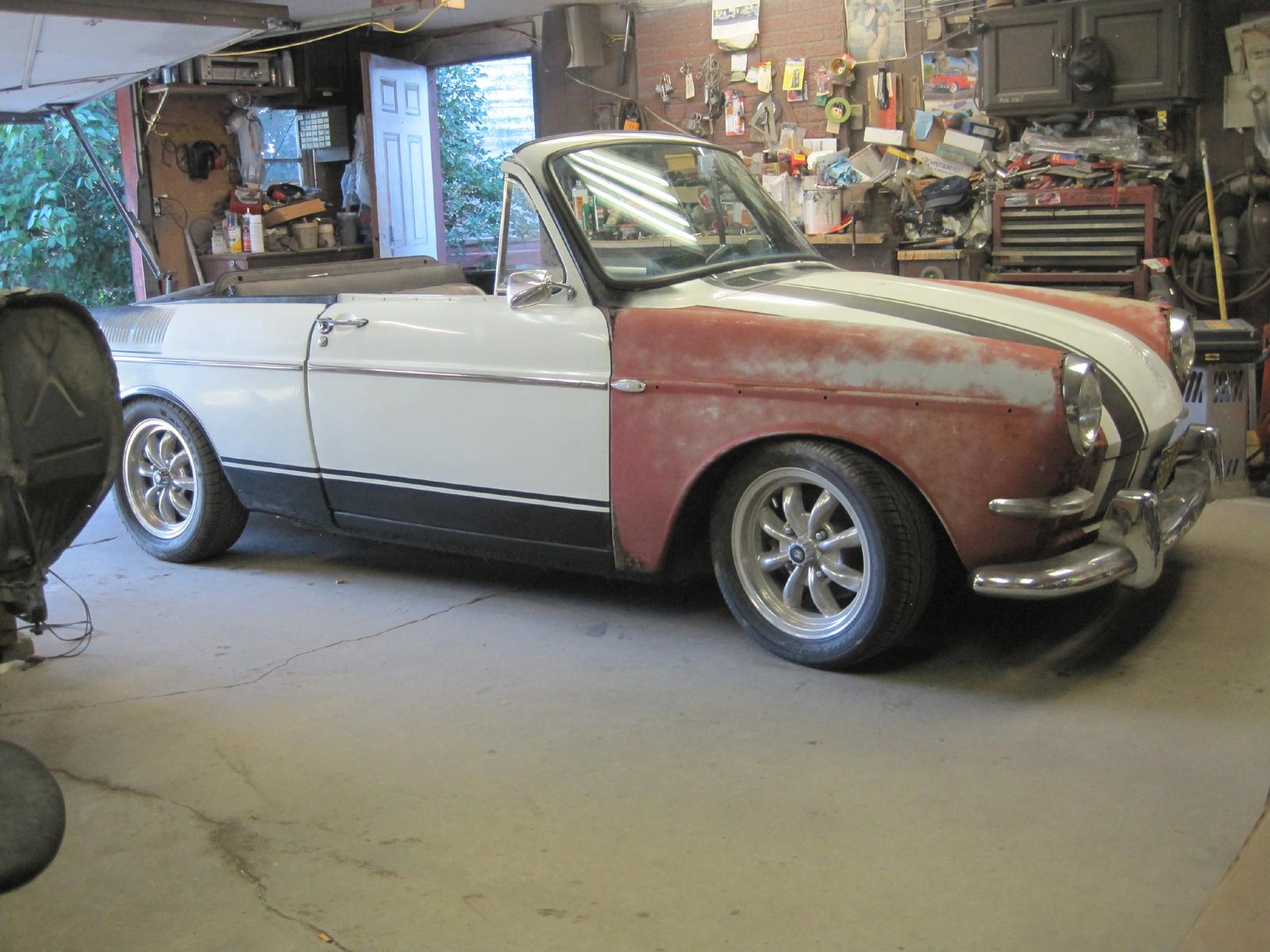

I'll have to look for pics but almost every slammed notch you will find is a stock beam, the type 1 beam is a relatively new downgrade. They still ride pretty nice slammed on a stock beam
this was I think 4 splines front 3 splines rear, daily driver. It was already lowered and I lowered it more
This beam looks narrowed?

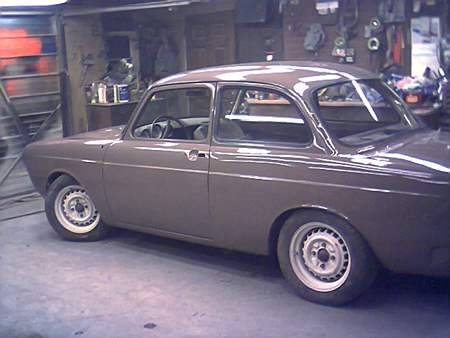

nope, those pics are 15 years old, way before anybody narrowed T3's. Bug smoothies and 135/15's

Erik G wrote:
Looks sweet, if this can be achieved with a t3 beam there is no point in me changing it. Did you lower the inner or outer splines?

Joefinnie wrote:
Erik G wrote:
Outer. and lowered beetle oil shocks.
At the very least, try it before you spend the money converting over. To me, the type 3 beam is so much better riding I would never swap it with a type 1

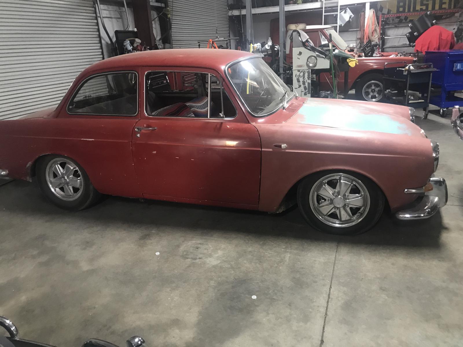

Since we are pulling skeletons out of the closet.
t3kg wrote:
