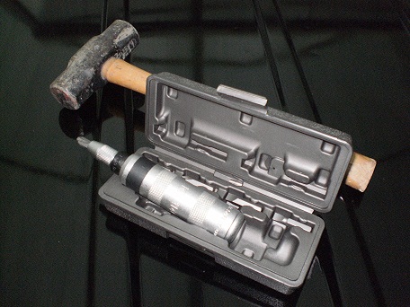

Semper_Dad wrote:
BFH + KD 1140 + #4 Bit
= Success
Good job. Very Happy Keep in mind that a 2 lb. ball peen hammer would have worked also instead of the mini sledge.
Supposed to be 77käfer, but there are no umlauts on an american keyboard
Overheard on 27 June 07, one lady to another when they saw my Harli in a parking lot at West Point, "maybe he found it on the clearance aisle at the Volkswagen dealer"
kubelmann
Joined: April 13, 2003
Posts: 3268
kubelmann is offline
PostPosted: Thu Sep 09, 2010 6:49 pm    Post subject: Reply with quote
My mini sledge weighs 24 oz. and looks like the pic you posted.... I guess I might have used the wrong word for the tool.
