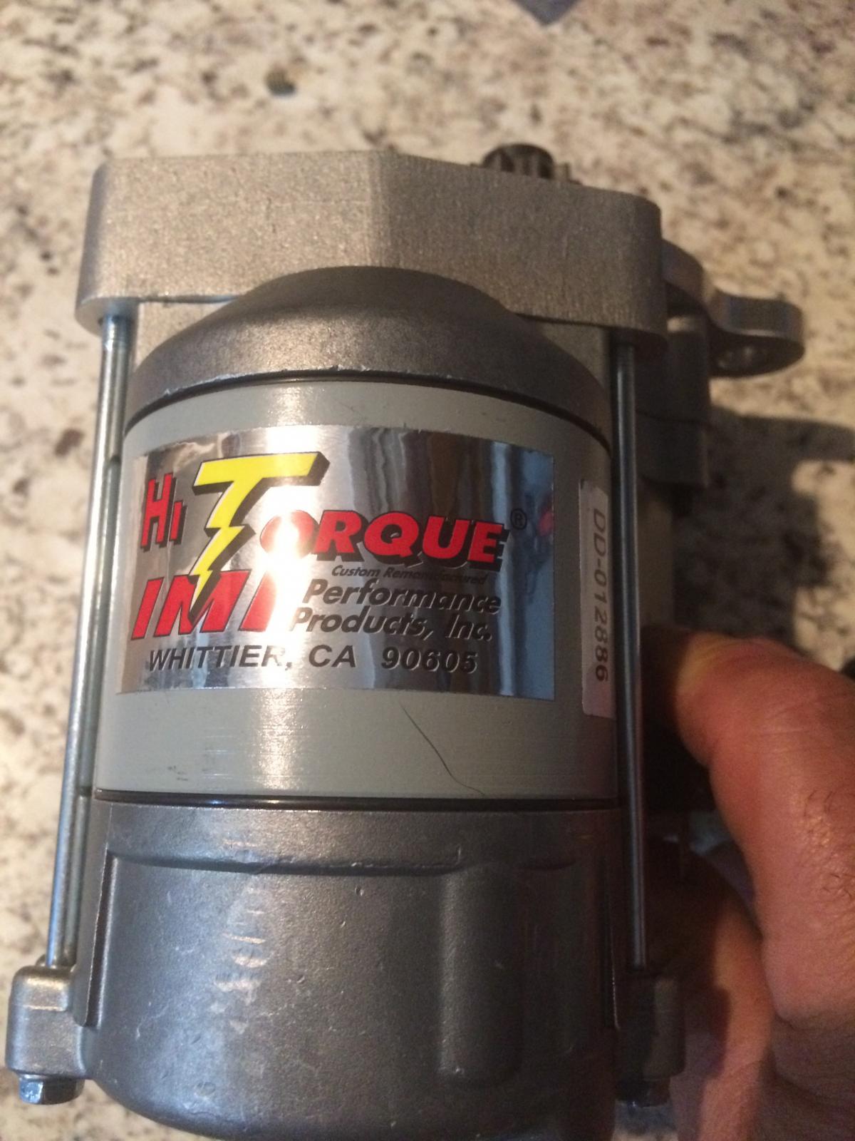

I installed this starter. I got it from Powerhaus in Calif.
All I can say is Wow, it is great, expensive but worth every penny and no need for a bushing
