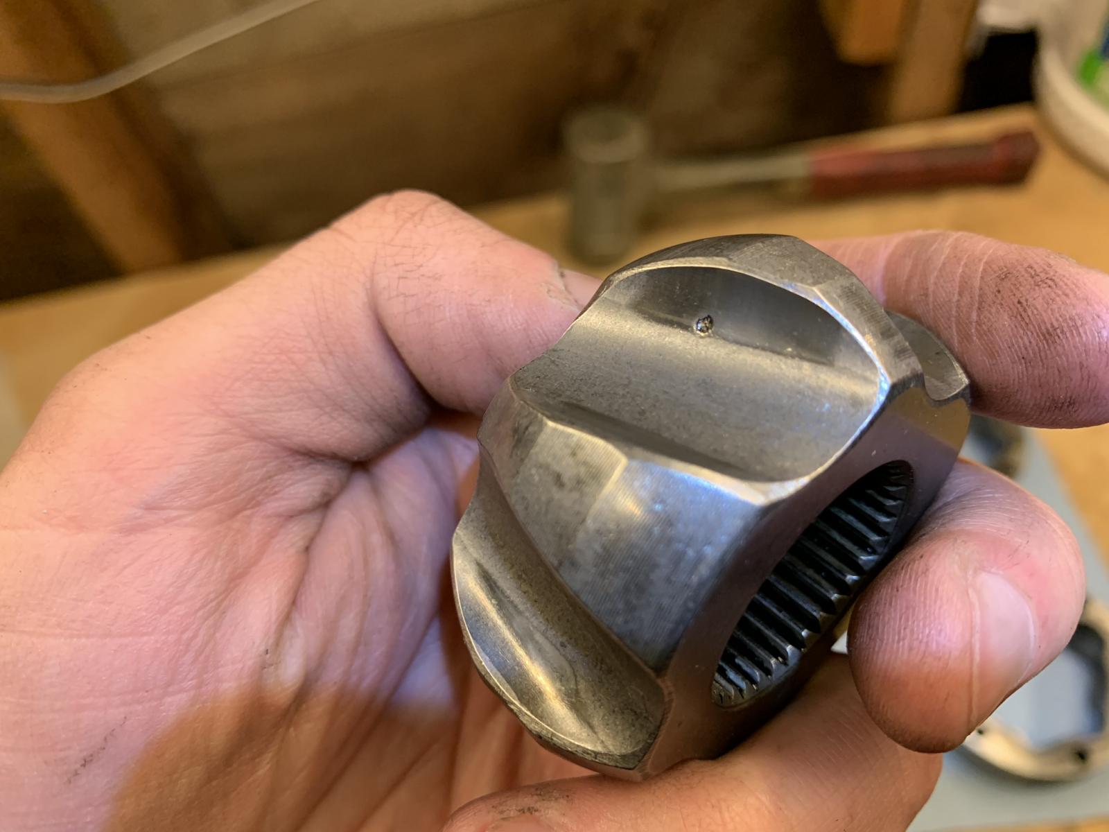

I am in the middle of a Bostig conversion and decided to replace my CV boots and repack the joints. Here's the driver side taken apart:

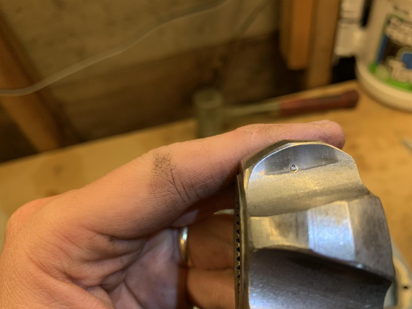

After I got all the grease cleaned off, I noticed a small defect on one of the parts. These are the two best pictures I could manage without a macro lens:
Is this anything to be worried about? I did not notice any issues or noise while driving. It does seem to be within the contact patch where the ball has polished the part. These are Empi CVs that have been on the van since I bought it two years ago.

PostPosted: Wed Apr 21, 2021 8:01 pm    Post subject: Re: Defect on CV part? Reply with quote
Pitting. Impending doom. Replace!

PostPosted: Wed Apr 21, 2021 11:41 pm    Post subject: Re: Defect on CV part? Reply with quote
Pfffft!
Normal wear.
Replace if you are the type to worry but grease them well and run them.
They will last many 10’s of 1,000’s of miles with proper service.
If you are worried, replace them.
If you do replace them, let me know. I'll pay for shipping instead of throwing them away.
I,d run those in a heartbeat!

PostPosted: Thu Apr 22, 2021 4:06 am    Post subject: Re: Defect on CV part? Reply with quote
I am with Dave, Run 'em. I have been doing that for decades. It began out of necessity, and after moving to an area (the Lower Midwest) with no Volkswagen activity whatsoever, and no ready parts sources that didn't depend on shipping, became normal operating procedure. Never a failure. I would run that with no worries.
As an aside, although I had no failures, and considered the cv joints a robust part on an otherwise non robust vehicle, there may be more vibration transmitted with the worn cv joints I run than with new ones. I have never been able to tell.

PostPosted: Thu Apr 22, 2021 4:44 am    Post subject: Re: Defect on CV part? Reply with quote
Run it especially if they are original vw parts.

PostPosted: Thu Apr 22, 2021 7:15 am    Post subject: Re: Defect on CV part? Reply with quote
Thank you all for the seasoned perspectives. I will put on the new boot and pack this with plenty of grease!

PostPosted: Thu Apr 22, 2021 7:35 am    Post subject: Re: Defect on CV part? Reply with quote
This would be a wise occasion to 'flip' that joint when reinstalling, to ensure that the pitted area is no longer the primary contact area under normal running.
Just determine which way that joint will rotate and in which direction the drive force will be applied, to avoid the damaged area.
As already mentioned, the pitting is minor in this case, esp. if an OEM CV joint, and there are many more miles left in it!

PostPosted: Thu Apr 22, 2021 8:01 am    Post subject: Re: Defect on CV part? Reply with quote
Assuming this is not on an automatic, then just swap the axles side to side when you reinstall them so that the balls run on a clean surface. By doing so you should at the very least get the same number of additional miles out of the joint as the joint already has on it.

PostPosted: Thu Apr 22, 2021 8:27 am    Post subject: Re: Defect on CV part? Reply with quote
This is great advice. I had heard the advice of flipping the part, but I didn't know whether that was actually possible, since it is not symmetrical front to back along the axle. You can see one side has a raised lip and the other side is flat.
My second thought was to install the axle on the same side of the van, but flipped around so the CV that was on the tranny would be on the wheel and vice versa. However, that actually wouldn't change the load surfaces; it would just change the face from driving the load to being driven.
Wildthings suggestion is perfect for my case. I have both CVs off, so I can just put this one back on the passenger side instead of the driver side.
