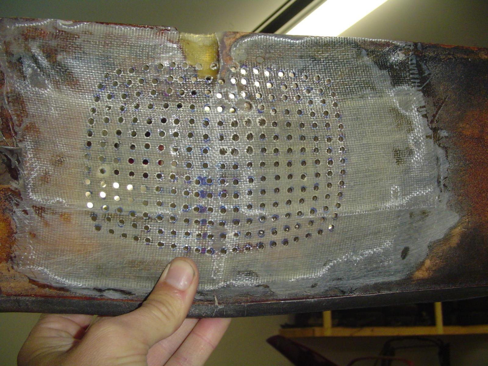

When I started, the vinyl was all cracked, and the sub structure was even crumbling in the area of the speaker.
I cleaned off all of the vinyl, as well as the thin sponge layer beneath.
Then I did a fibreglass repair on the speaker area - I used mat and liquid resin fiberglass.
To recreate the speaker holes, I held it up to a light, then marked each hole with a Sharpie. I then took it to the drill press and drilled out all the holes.

First was removal of original cover and (disintegrated) sponge underneath. There was rot in the speaker area that I patched with fiberglass
The speaker holes were marked by holding the piece up to a light. I then drilled out each spot with a regular drill.
Underside view after fiberglass work.
