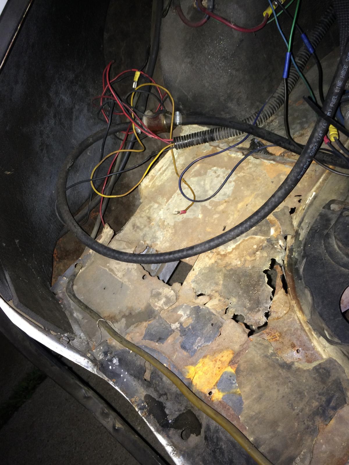

I was considering it but once I unfastened the PO metal bandaid I found this
Then upon poking around I found that they tried to cover it with fiberglass
Some of the rear tray is bad too, but I did notice that the metal up by the battery fastener is still solid! As well as the under support beam
It looks like a tweaker started to cut into it and gave up...

Yep... I found that the apron bracket support ( where do I find those?) is not attached, the other one is missing, the bumper support metal has lost the top lip on places, there is a weird seal/gasket on the tail light section of the battery tray, is the battery tray even attached to the body? the suport for the rear engine shelf is not attached... that's the one under the curved portion of the shelf where it meets the battery tray, I only hAve right sided tin snips and the metal is almost as thin as tin foil even on the good parts.....what the hell am I doing here....?
