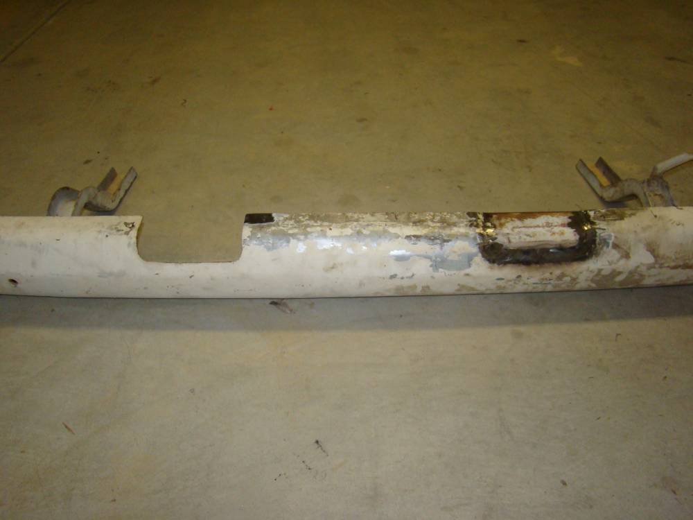

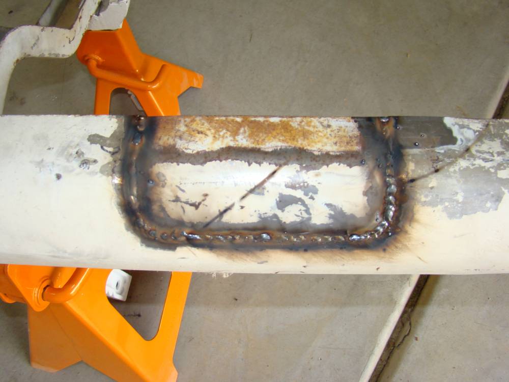

I decided to start my own build thread to keep my tidbits in one place as I have done a myriad of small things for my bus and its just time. If you expect to see a whirlwind resurrection of this bus you have come to the wrong thread. My plans are to restore my bus to as close to original as possible with some exclusions along the way as finances permit. Here is what my bus looks like and the last pictures will be a repair I have started on my rear bumper.

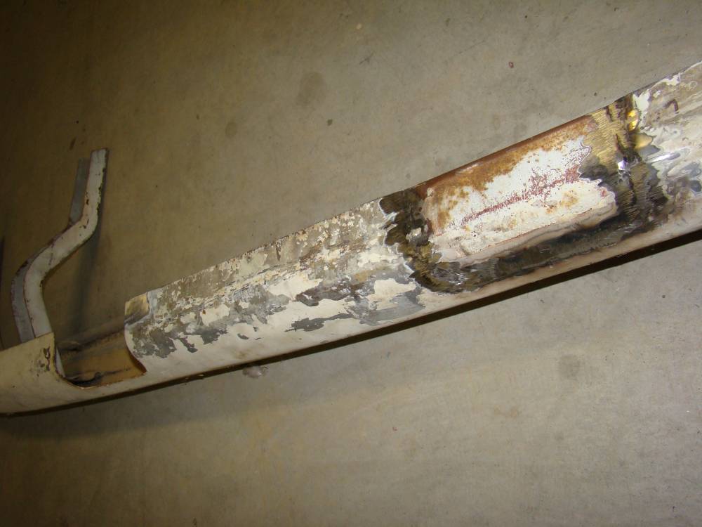

and finally I welded this section in tonight from a bay bumper. I am relatively satisfied with the results.

I would love to have a picture of my dad welding on my bus bodywork. More chance of marylin monroe visiting me. Quote from dad. "why work on cars, they are just meant to break again anyway"
Nice bumper patch.

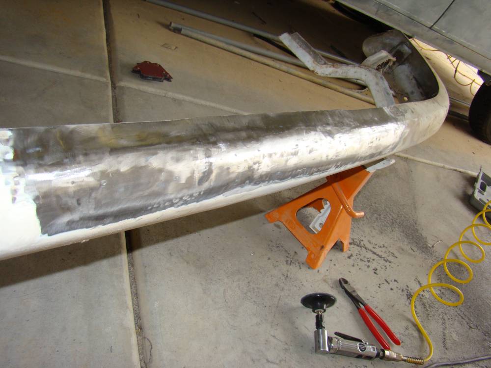

spent some time on the other bumper segment today. I am not ecstatic about the results. but I never have done this type of repair before. I wanted to avoid using any bondo but found that there was some used on the bumper previously. I hope that a bumper shop can get this thing perfect later. But for now it is better than it was before. I love my Mig, favorite tool in the garage.

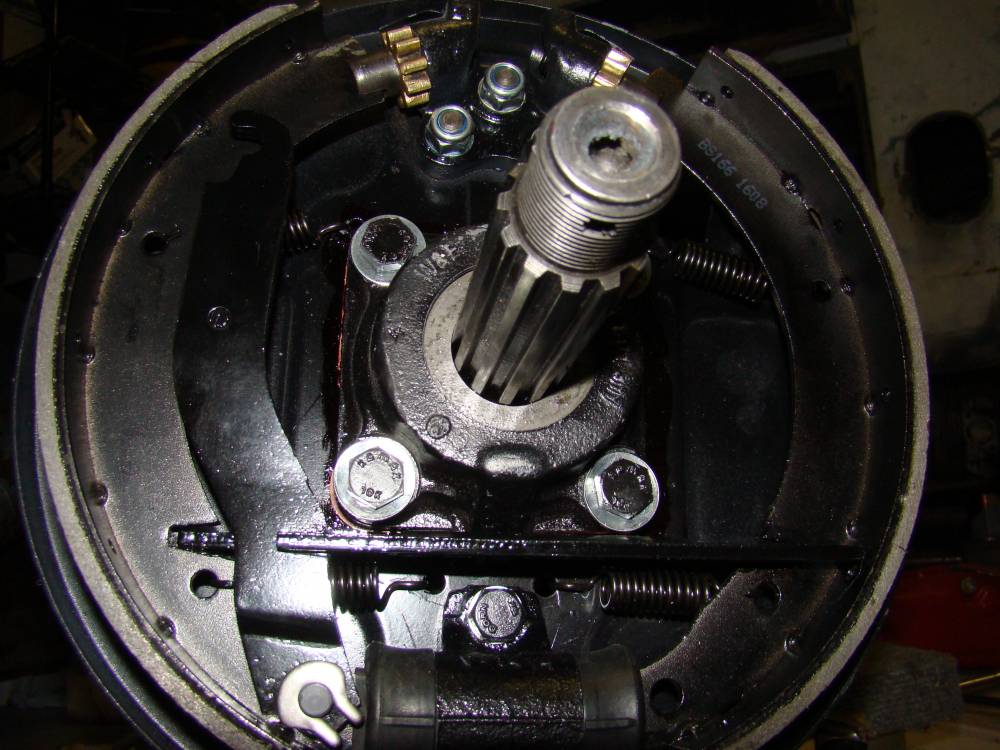

I have been sandblasting brake hardware and spring plates and covers. also un-froze the star adjusters by heating them then cooling them rapidly. worked like a charm. here I put the brakes together on the side I just re sealed. as you can see I painted the wheel cylinder too. I then torqued my drum on just to try out my torque buddy (what a POS). I then started tearing down the other rgb to re seal it and to change the shims/gaskets in the axel tube. found that when I installed this bearing cover I ruined the seal. And it felt so good going on too? I now know what to do to prevent that again. I also beveled the edge of the brake shoes as per the bently. If you see anything wrong please tell me. I also noticed I used too muck gasket sinch that will not be the case on the other side

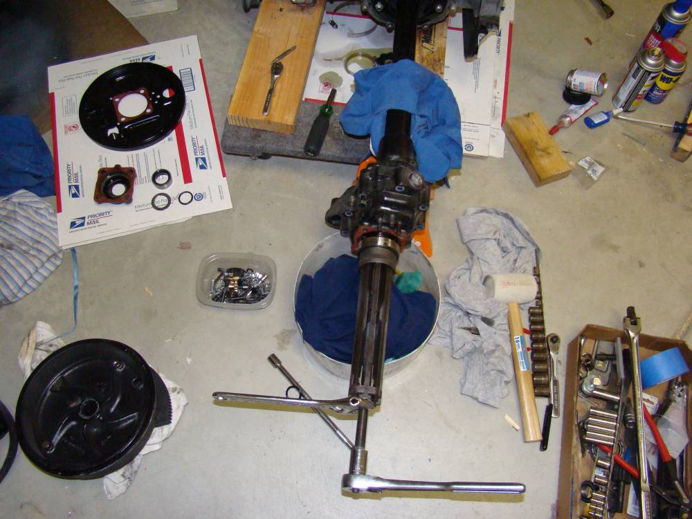

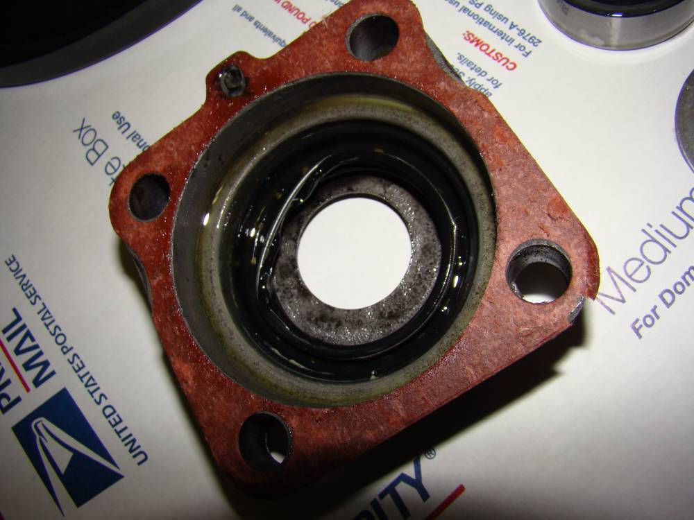

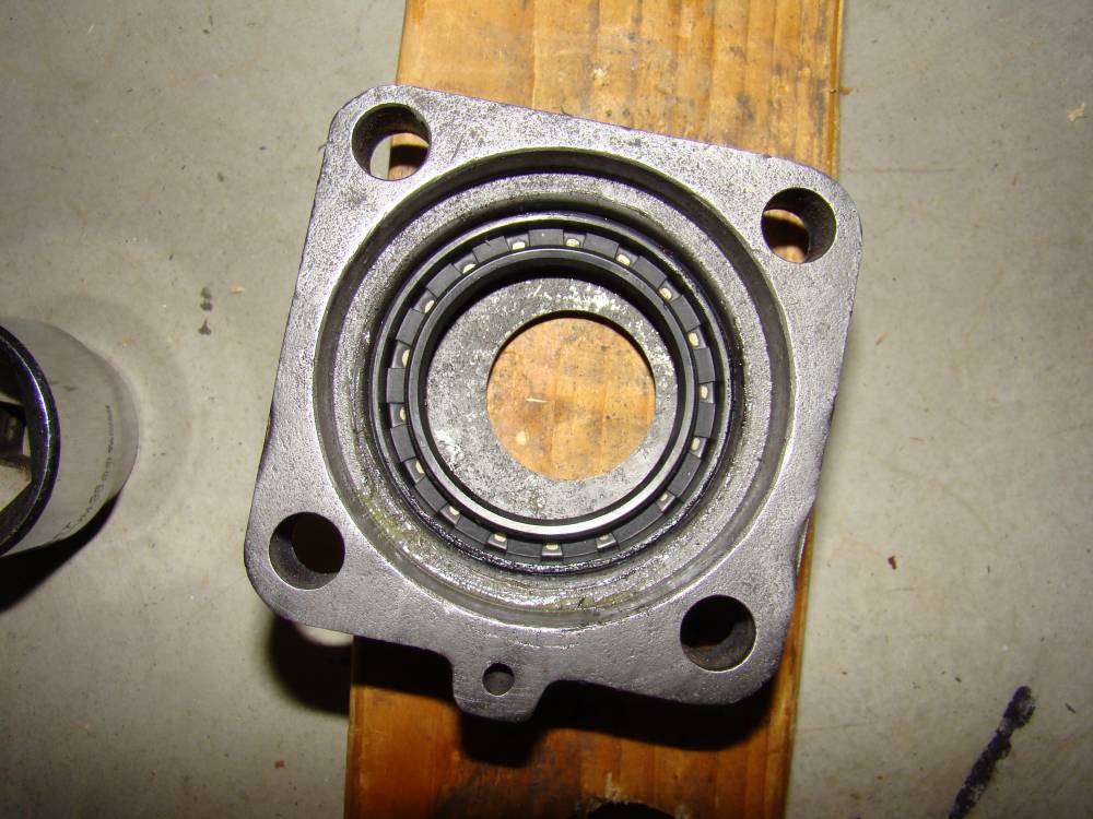

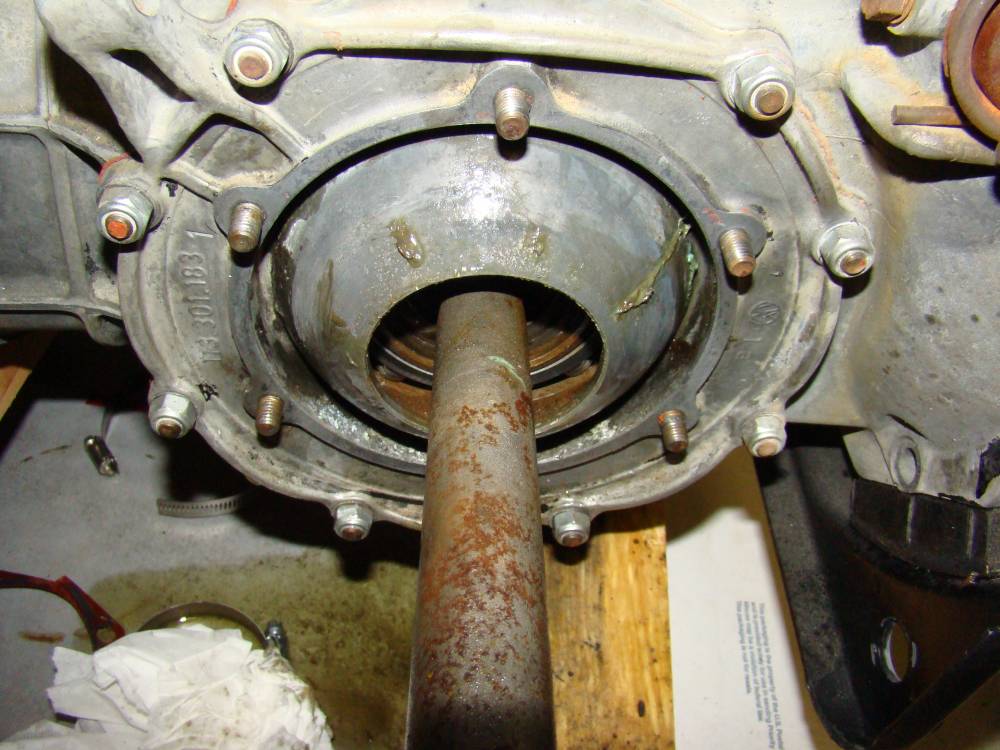

Spent the evening tearing down the other reduction box and tube cleaning off all the old gasket sealer getting ready for assembly for tomorrow. I should have it assembled drum to drum. Then time to rebuild and re-bush shift rod tube assembly. No wife and kids till Sunday so I should get plenty done.

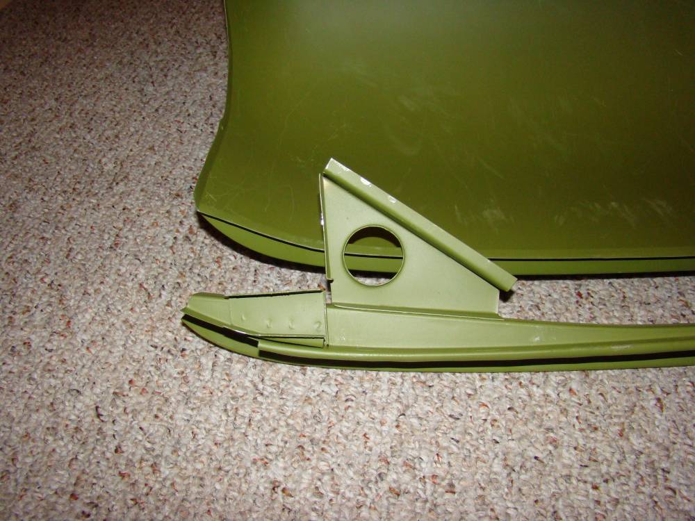

I received some funky green from Gerson on Friday. Somehow my battery tray and apron mount didn't make it but he said he would get it out asap. I held it up to check how the pillar spacer compared to the original one and you cannot tell them apart, Amazingly nice

Oh and the days of pb soaking and the repeated heat and quench din nothing for the coupler set screw but the tubes came apart easily there was no rust at all where they met. Got lucky there. I would like to find a NOS front coupler as I read the WW ones were iffy
