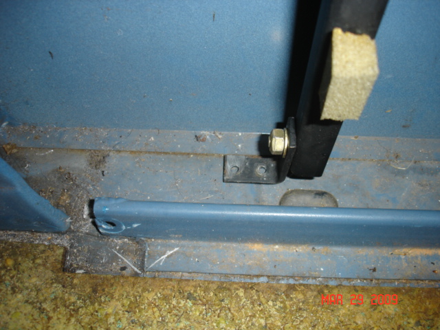

Thank you, can you tell me what the support brace looks like, I have a long skinny "U" shaped piece for the table is there another piece for mounting.
The U channel for the paneling, is that just on the top or is there on for the top and bottom?

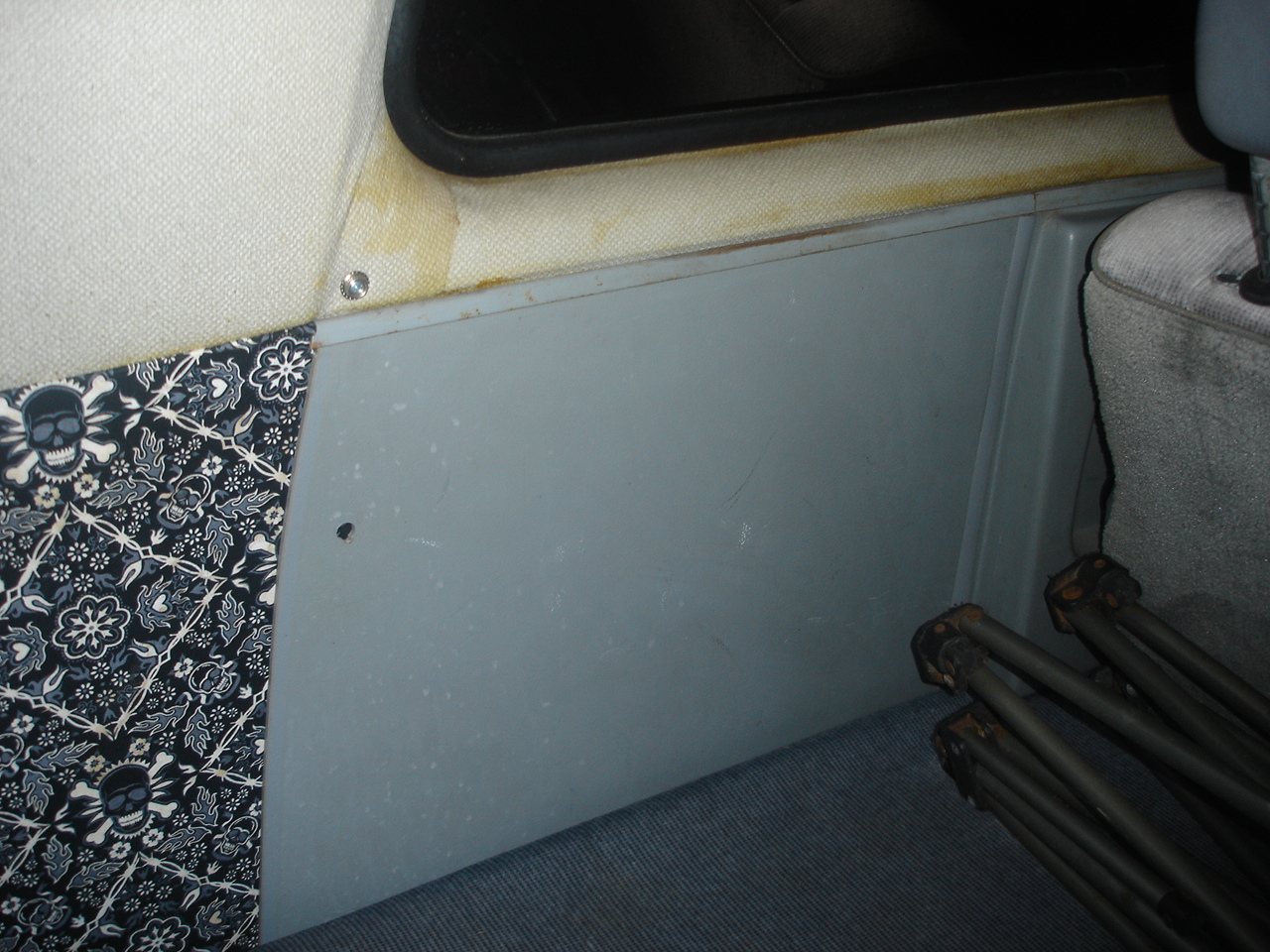

The panels I have there are only two. One really long one for the drivers side (with the table) and one shorter one for the passenger side from the slider back.
Am I missing some?

Sorry it took so long, I forgot it was my anniversary today Embarassed Yup, You're missing a couple pieces. There should be a couple more that go more towards the rear.Here's the bottom of the table bracket.....
Heres the bracket for the table.....

That's all my 91 Carat has. It's really just those two panels and the jump seats that are really distinctive Carat items.
Looking again there might be one more panel for that farthest rear on the driver side.

You need the plastic panels that go on the sides in the luggage compartment.

It looks like you're only missing one, on the table side. Also, There were some pieces that go up the rear for the A/C equipment. I've heard there are panels for Carat's with out A/C. I have yet to find some. They would go where I have the funky printed stuff.
You can get a rear washer resevior cover for the oval hole on the pass. side.

So it looks like I could just weld some "L" brakets in for the table at the bottom
[/quote]
I have all the black hardware here with the table attached, what are the copper colored pieces.
Thanks for the pics and info
Those are the spacers for the z-bed.
Spacers for the back seat
