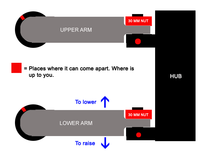

maybe im reading your post wrong but are you trying to take your ball joints off or the lower control arm cause the lower control arm is on with a 19mm nut and a allen head grub screw.
Type 3 Fasty
Mike Fisher
Joined: January 30, 2006
Posts: 18046
Location: Eugene, OR
Mike Fisher is offline
PostPosted: Fri May 06, 2011 4:39 am    Post subject: Reply with quote
x2! I never mess with the 30mm nuts raising/lowering.

I have lowered mine and other cars by removing the 30mm nut and also by loosening the pinch bolt, either way you get the same result. You just have to make sure everything is oriented the correct way.

Or you could just remove the upper ball joint nut, and the caliper, remove and replace the opposite end bolt with a longer 1, and pull and swing the trailing arm and spindle together. I've done that before (it's called an inner spline drop). The reason for the longer bolt, is so that you don't have the torsion bar fall out of it's socket (makes it easier to get back in place). Doing it that way takes less than 30 minutes a side, but you still have to reset the toe in (it'll be about 3/4s to 1 inch out).
Remember, both ends of the torsion bar are splined. Wink

i try to tell people but depending hon how much you are lowering
you can lower 1-2 inner splines with out taking anything but the shock and the torsion bolt out
jack the car up and take the wheel off
loosen the torsion bolt as you would normally
but put a jack under the arm you are dealing with
pull it out and feel where it is then raise the jack each spline
checking that you have made each
and mark where you can for reference
i have lowered 1 car(my 71 fasty)
lowered and raised 1 car (my old 70 square)
and raised 1 car(friends 70 fasty)
and neither did i take anything apart

I agree with sharkskinman, in most cases there is no need to remove anything..unless you have flipped tie rods, in which case they can get in they way when trying to raise the car
