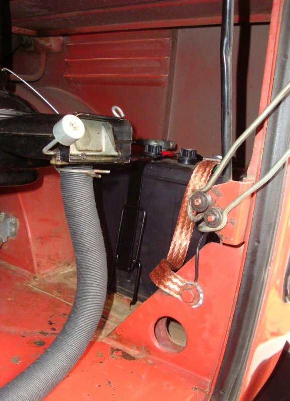

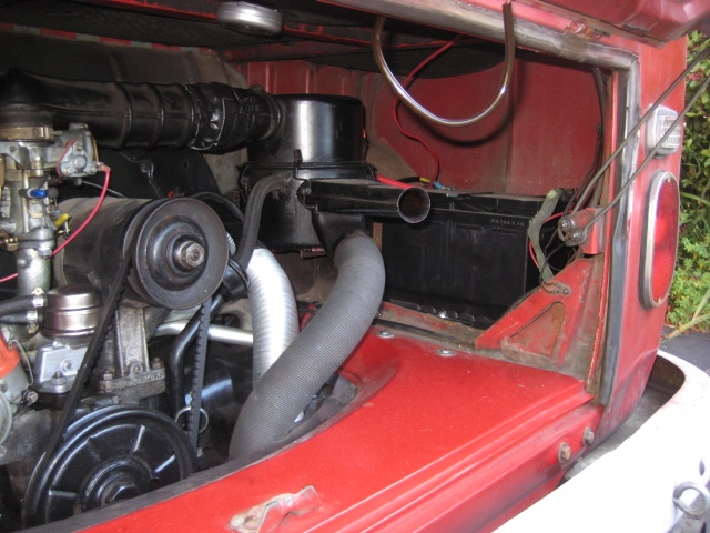

My '63 15-Window:
Painted head, big washer:
I believe this was a my old '64 13-Window, also painted with big washer, which also looks painted here:
I don't think it's a special bolt in any way.

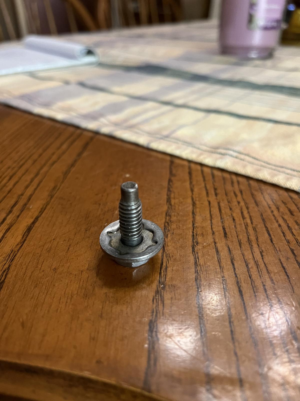

This is the bolt that has been holding my battery ground cable to the frame of my 1965 hardtop Deluxe for more than 30 years. The outer edge of the washer is sharp.The threads and the 13 mm head of the bolt are a perfect fit.! I don’t recognize the cross and S on the bolt head. It most likely then, belonged to another car make.

My '63 15-Window:
Correct!
