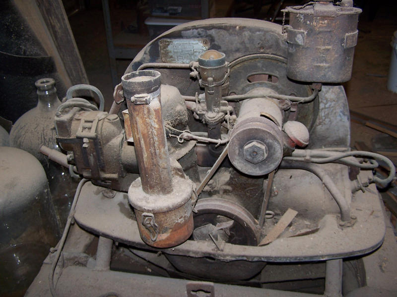

Unfortunately I live in Europe:
http://www.smokstak.com/forum/showthread.php?t=93101

Wow. that is quite a find. Some of the uninformed responses are pretty funny.
"Typical VW car engines have the generator 'leaning' more to the left, where this one leans toward the right." Laughing Laughing

"Deff looks like an engine out of a Kubelwagen made by VW that was later The "Thing""
Not exactly correct.
The engine has the double groove pulleys like on a schwim. Looks like the tube that connects the air cleaner to the carb is laying on the other side right above the flywheel.
This engine is remarkably complete.
As they noted, it has a standard sedan (and Klubel?) rear pulley pan rather than the large squared off version of the later industrial engines.
It even has the super rare manifold that that kind of looks like a 36hp version that was present on the earliest engines.
Sitting in someone's basement in Alabama? These jewels are still out there.
I suspect Christian will be contacting them shortly...

to me this is the best one Laughing
"...Maybe it's a pony motor for a BIG diesel engine for a Panzer tank?..."
Laughing
amazing engine, it looks very original and few "km's" Very Happy

He might be closer to correct than you think. The Germans used those as starting/launch motors for the V2 Rocket program. Here's an old thread about it:
http://www.thesamba.com/vw/forum/viewtopic.php?t=214690&highlight=rocket
Don't forget that the center of the US Rocket research and the place we moved all the German rocket scientists we brought over was the Redstone Arsenal in . . . (wait for it) . . . Huntsville, Alabama!
It's not a stretch to think we brought over some V2 rockets and related parts, maybe even a few starting motors. And maybe this motor was from that program? Can't prove it, but it's as good a theory as any about why a WWII vintage industrial motor wound up in Alabama.

Clearly on the tag: typ 120/17
So it is a stationary engine for the RLM (ministry for Air Transport), according to Barbers Birth of the Beetle.

splitjunkie wrote:
That could explain the small gas tank mounted to the engine I suppose.
I think the gas tank is used when starting the engine in difficult (cold) weather to squirt some gasoline into the intake manifold (considering the fact that the VFIS carb was lacking an accelerator pump).
If I recall correctly, the Kubelwagen came with a small gasoline canister held with clips by the driver's A-pillar to be used exactly in the same manner. Maybe the small canister was something similar.

The cannister to the right is an ether tank, also used on
kubels and schwimmers in cold climates...although you can imagine the military being the military they probably were fitted to the Afrika Korps vehicles, much like the sand-proofing seen on Russian front cars... Laughing Learned that from the late Ron Redmon while working on his Kubel and Schwimmer. Dave Crompton can probably confirm.
Good looking piece of equipment, funny to read the expert replies on Smokstak...

OK, that makes sense. I don't know that much about the military vehicles but I have seen that tank mounted as you mentioned in klubels and schwims.
The more I look at that motor the more amazed I am at how original it is. It even has the special spark plug wires.

If it really is off a V2 trailer or whatever, the total running time that engine has had could quite possibly be measured in minutes.

it does have the same Magneto unit as the V2 Erector but has different sheet metal in the back:
The V2 unit has been HEAVILY restored by non-VW experts though, doesnt even have an aircleaner on it, who knows whats actually correct, its missing the side tins for the cylinder heads and the carb is painted grey, the basement find is probably more correct, they both have 6 prefix on serial number too...

Type 120 motor in action, although no V2 attached...
Same air cleaner, no ether tank or breast plate tin.

What is up with the I.D. plate stating that the motor only has 15PS Question

It is limited to 1800 rpm by the magneto so that is the max HP it will put out.
The sedan motor is rated 25 hp at 3300 rpm.
