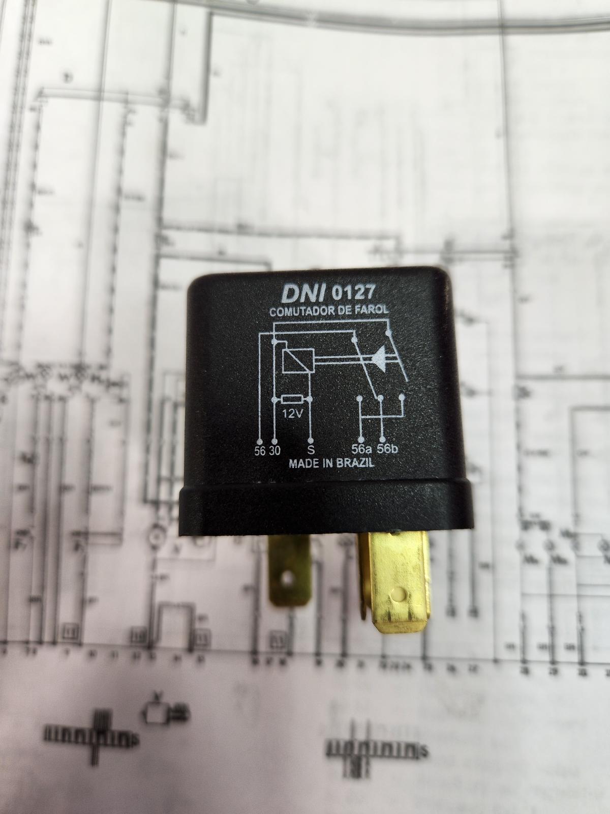

I pulled the dimmer relay. It has 5 prongs. Where it plugs in under the fuse panel only has 4 wires in the socket. Pin 30 is empty. That explains why the relay would not fire.
My Bentley manual shows the relay with pin S, Pin 56A, pin 56B, and pin 56; just 4 pins, no pin 30. Is there a way to make this 5 pin relay work? Jumpering pin 56 over to pin 30?
I just looked on line and couldn't find a 4 prong dimmer relay at Bus Depot, CIP-1, etc.

PostPosted: Wed Sep 04, 2024 4:24 pm    Post subject: Re: Turn signals don't work Reply with quote
Here is the relay with the pin layout.

PostPosted: Thu Sep 05, 2024 9:11 am    Post subject: Re: Turn signals don't work Reply with quote
That's the Euro style dimmer/flashing relay. Yes, it needs a 12 volt feed to pin 30 to work. You need a terminal with a retaining tab on it so the wire stays in the socket. Use a red 14 AWG wire from the terminal to a full-time 12 volt (typically unfused) source at the fuse block.

PostPosted: Thu Sep 05, 2024 10:29 am    Post subject: Re: Turn signals don't work Reply with quote
That makes sense, I got that relay from Heritage Parts Center in England. To make it work, I took the spade connector from the buzzer socket and soldered a new wire on it. I then installed it in the pin 30 slot for the dimmer relay. I connected the other end of the wire to the pin 30 terminal on the head light switch, as it already had a second pin 30 terminal available. Everything is working as it should. I'm a happy boy! Very Happy
