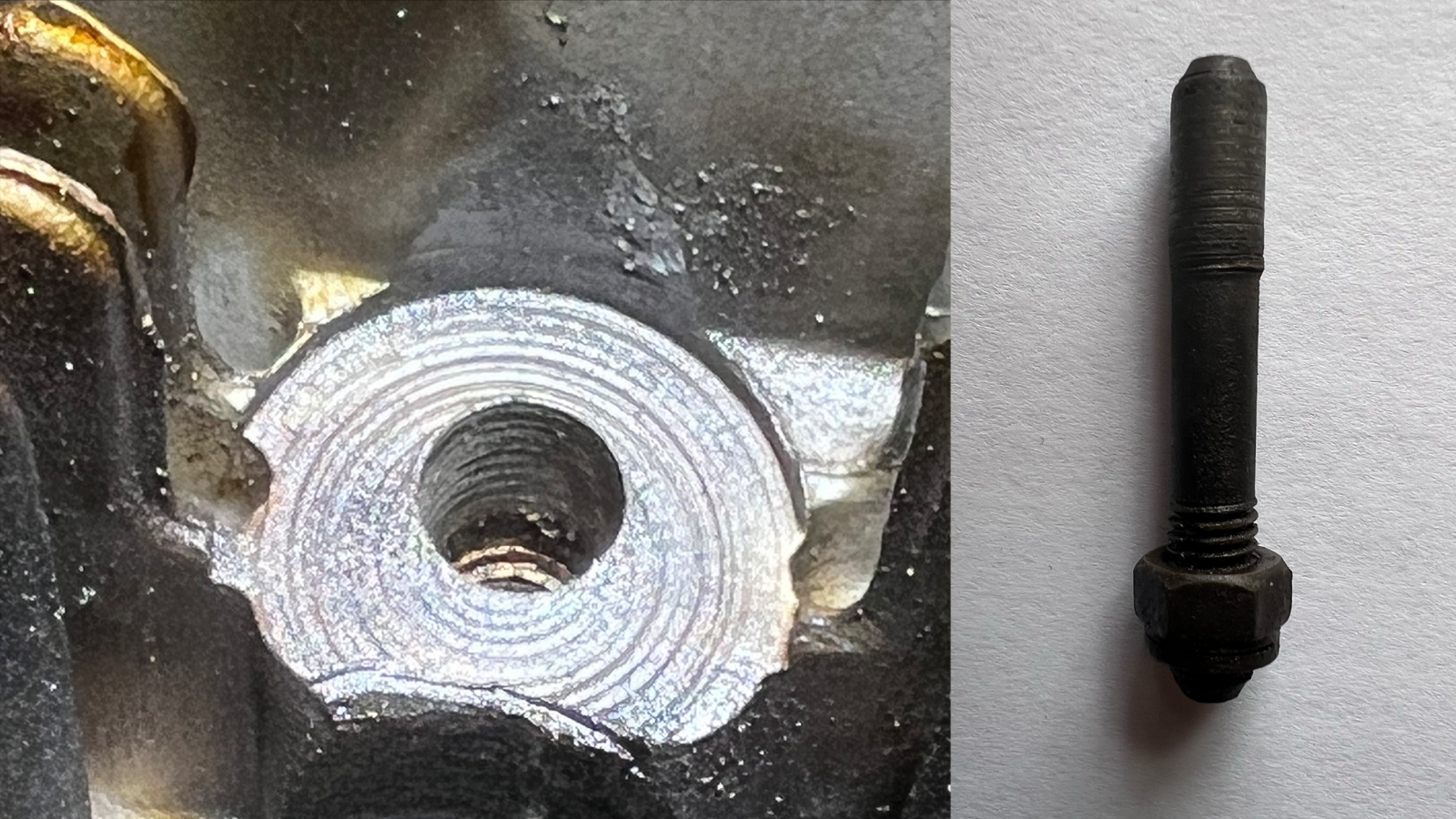

I've got a 78 fi Westfalia and am replacing my rusted out exhaust. I removed the j-pipes as they were pretty mangled and of course the exhaust studs did me dirty. 3 of 8 stayed in and are fine. 3 others came out with the bolts on them but the threads look good in the head.

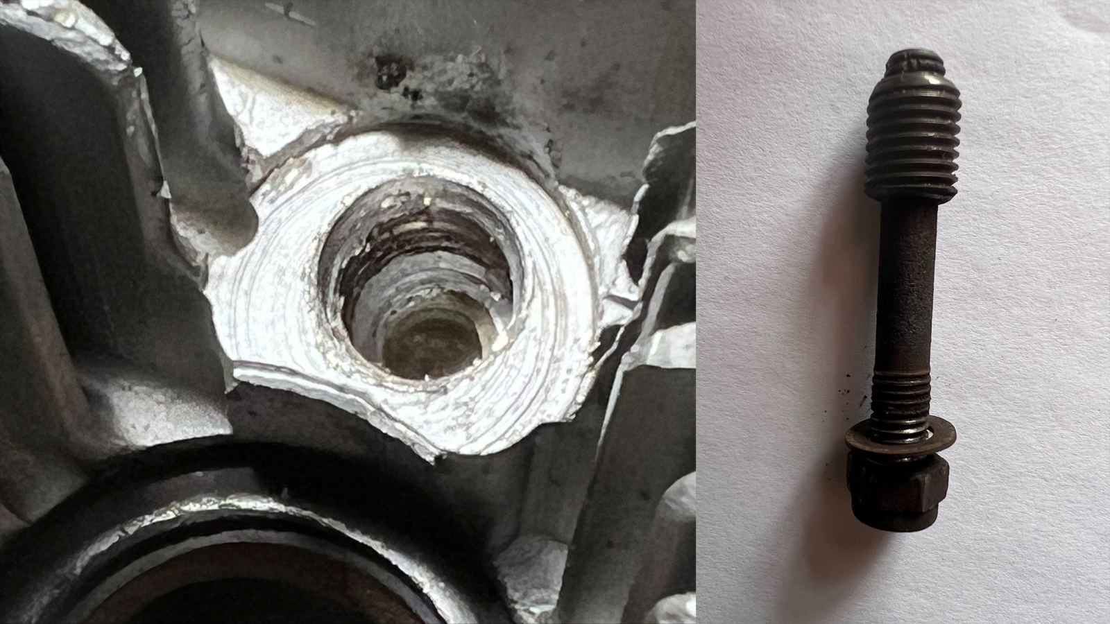

The other two are the issue. One came out with the threads from the head on it (pic 1) and one came out with what looks like a time-sert still connected to it (pic 2).
the last one is the one I'm really worried about since there does not look to be much meat on the bone. The threads in the head look like they are "kinda" there but damn thats a big hole.
Any suggestions on how to deal with these two? I'm maybe a step or two above a newb and I did replace heads on a 72 Squareback when I was in high school 40 years ago but I'm pretty sure this is something I'm gonna need some help with.
I've searched thru lots of posts on stud misery but haven't seen anything quite like this so figured I'd see if anyone had advice even if its "get new heads".

Ugh..., I'd be looking into thread insert sleeves.

Yes inserts will work, I have used Type 1 case savers where I needed a really large diameter insert.

You might consider the EZ-Loc thread insert, see if that solves the problem for you. Used this one one of my heads to fix a previous repair by the PO, and it's held up for about 14 years.

Thanks for all the help everyone. Decided to get some professional fix this for me. There wasn't much meat on the bone to drill the bad one larger but luckily the threads were still in decent shape so he cased the threads and re-seated it. The other one he installed a helicoil and its solid now too. Got my exhaust installed with no problems.
